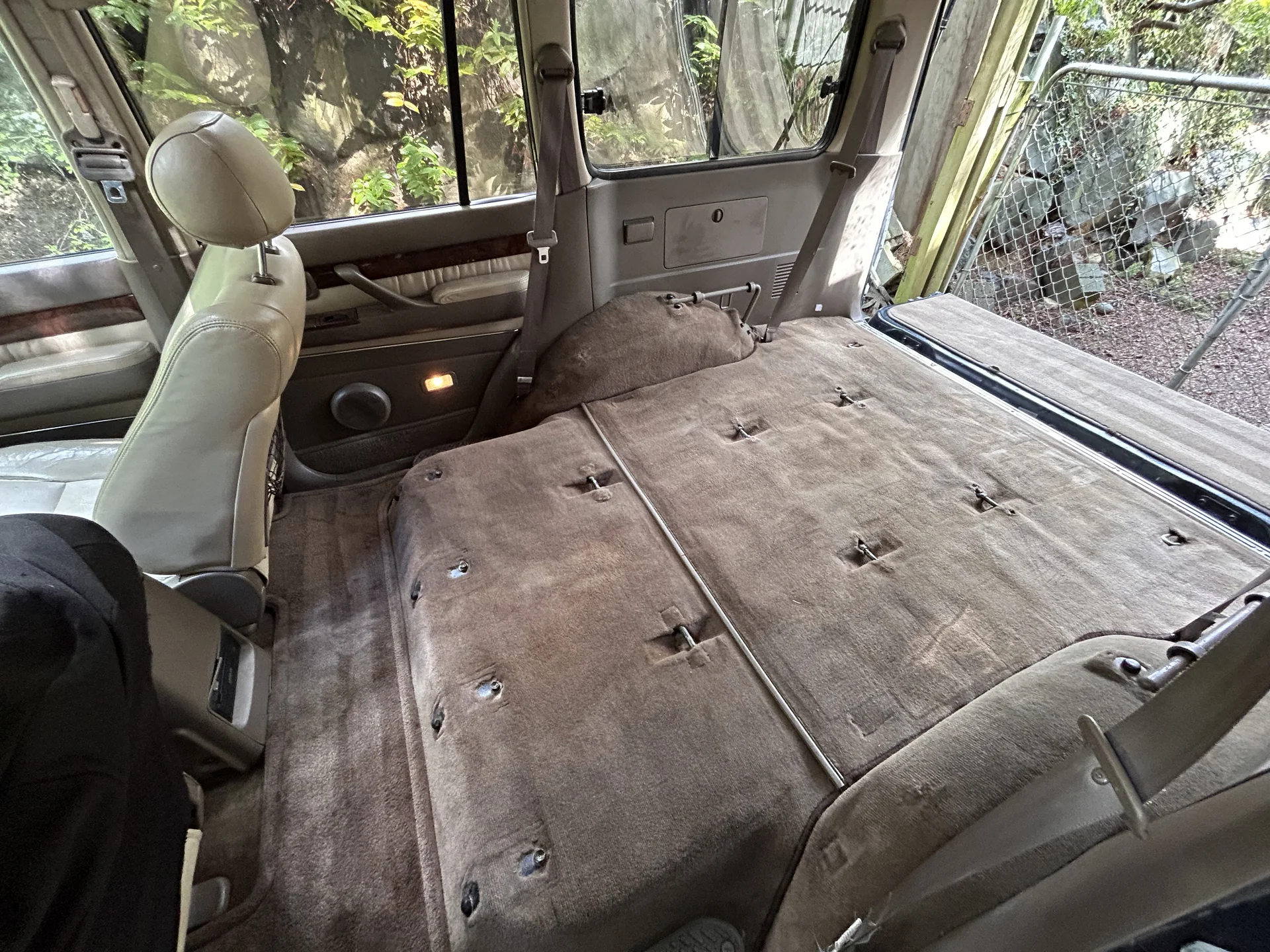

Got her home, yanked the rear seats, running boards and did a quick clean up on the interior

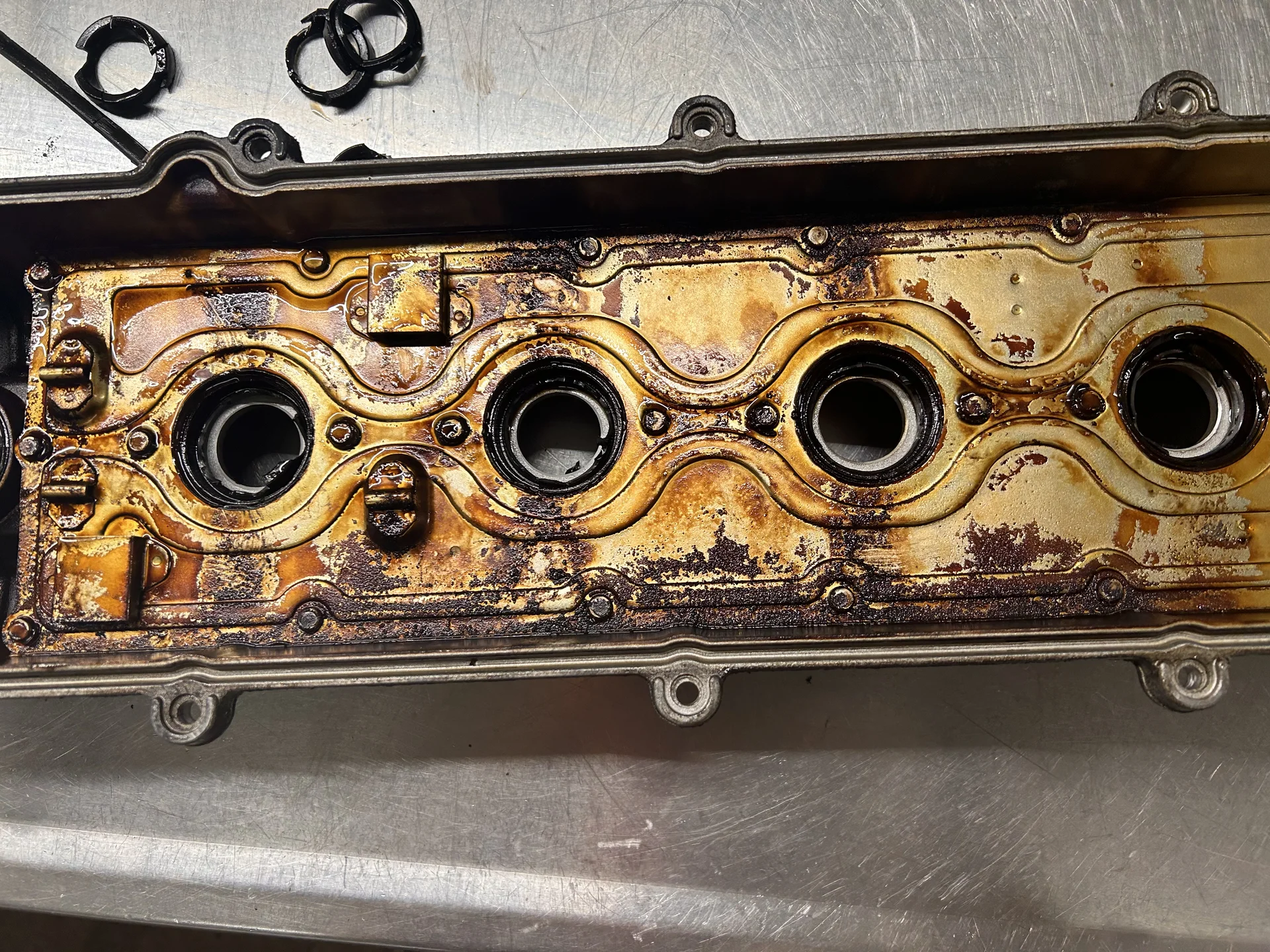

Popped off the valve cover to fix the leaky gasket and found some wonderfully crusty plug tube seals.
Did a few other things while I was in there - throttle body clean (forgot to do the IAC) and gasket, kick down adjustment, spark plugs, PCV, PCV hoses, coolant hoses except the PHH.

You sure the bad leak was from the valve cover? It's very common for the distributor O-ring to be puking out a lot of oil in same approximate area.
Sounds like you're planning to build a monster. OK, well hope it's fun!
Good thought! It was the valve cover gasket though, it was leaking all the way around the cover and broken in two spots.

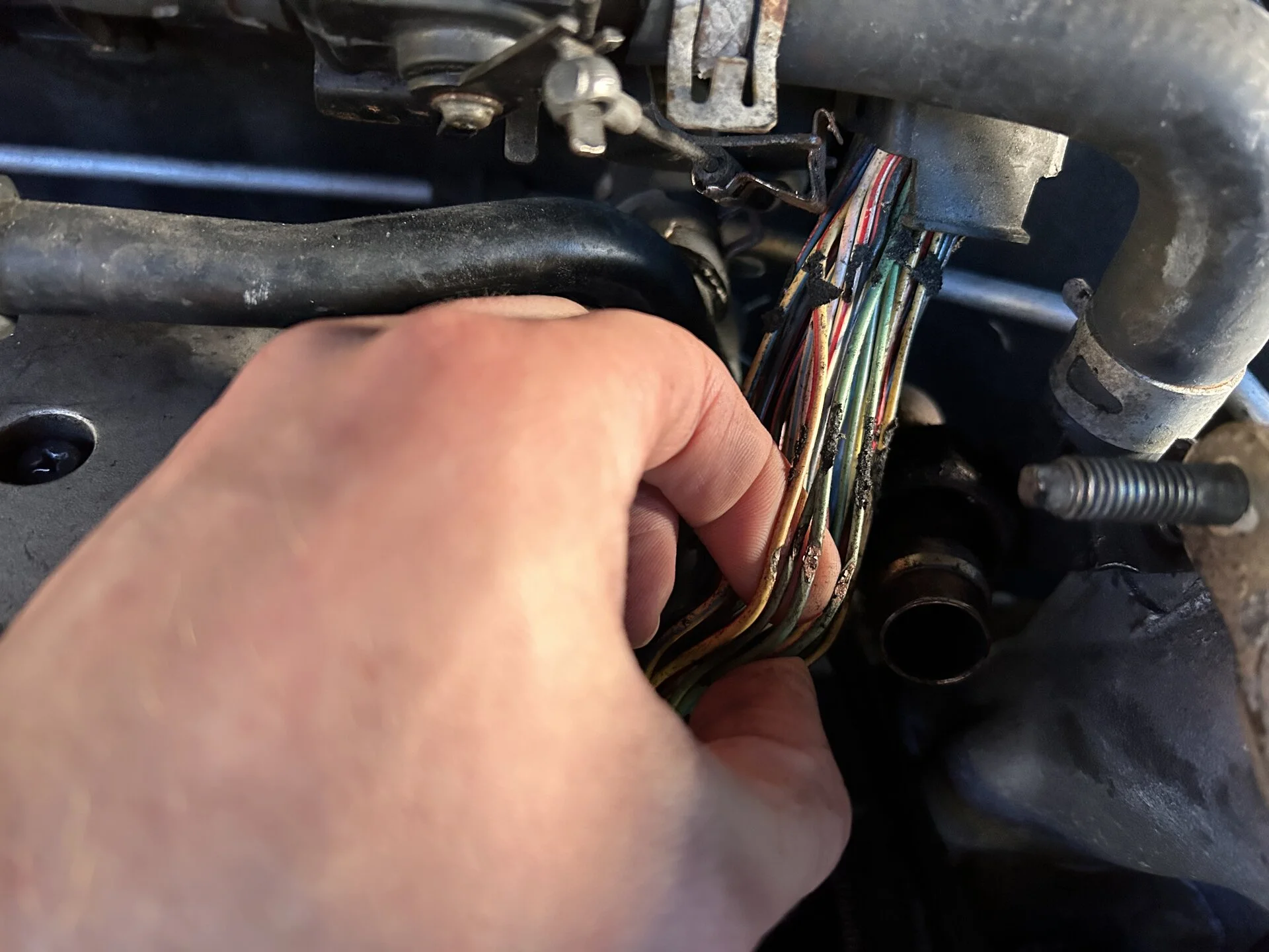

Looks like I have an answer on what the shudder is, just pulled the front driveshaft and was driving it to see if it was still there. Threw a cylinder 5 misfire code! Hopefully an easy fix.
I mean... you're not wrong.

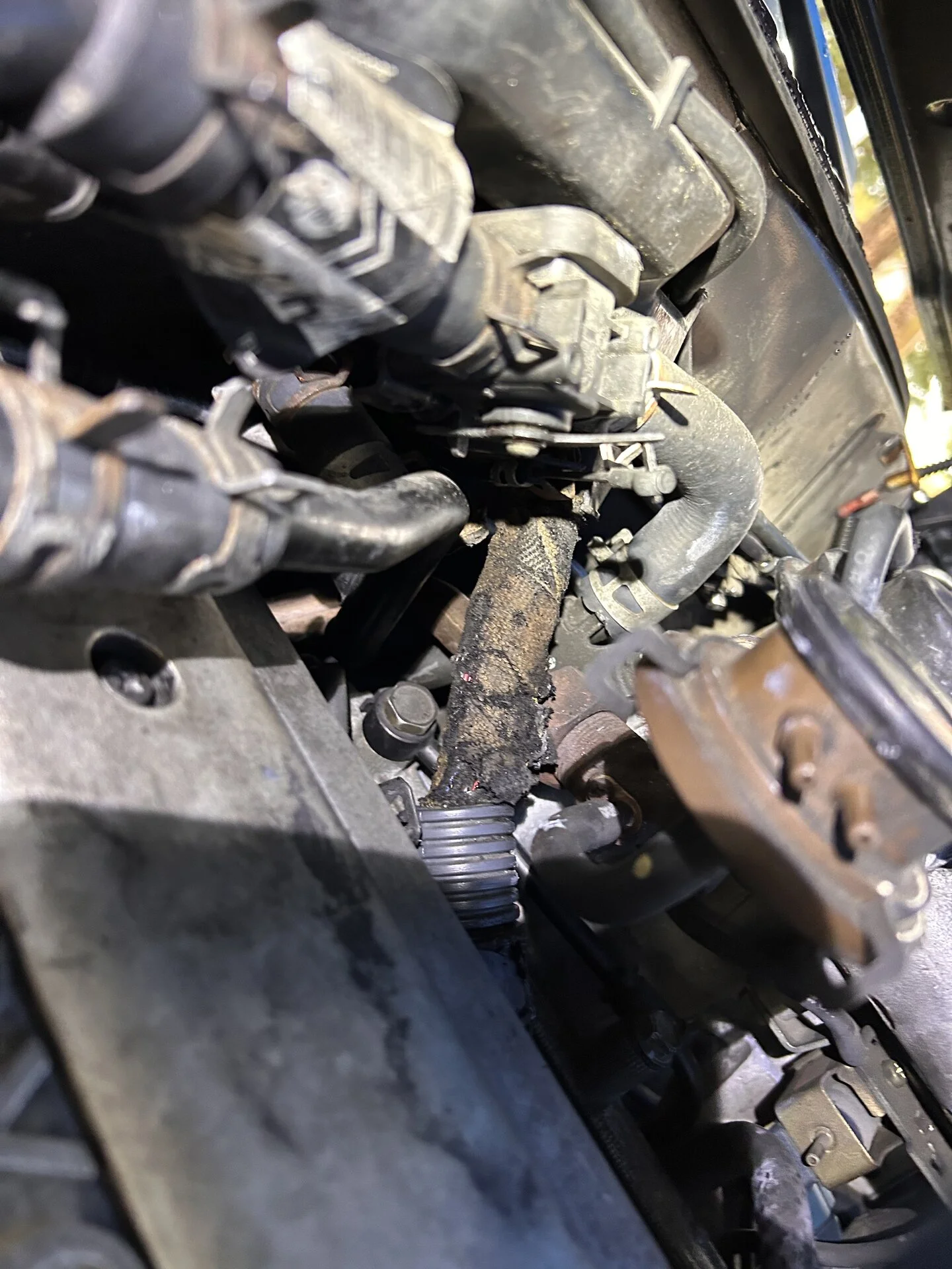

There are 2 known trouble spots for wiring issues on a 1FZ-FE.
The harness that runs next to the EGR pipe is supposed to have a support that keeps it from making contact with the EGR pipe. Over time that support breaks.
Under the glove box the harness for the ECU runs along the bottom steel support. Over time this can chafe and wear through.
Nailed it. I was poking around last night before it started raining, it looks like the harness by the EGR has gotten a little toasty.

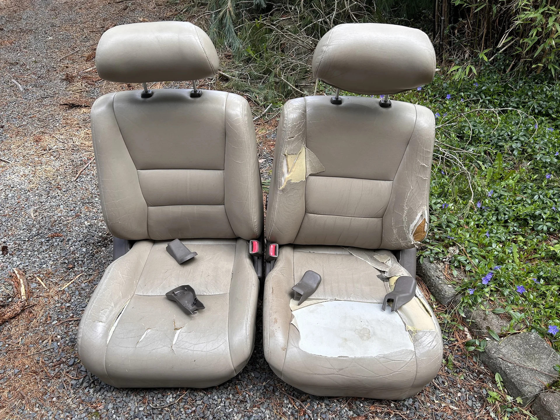

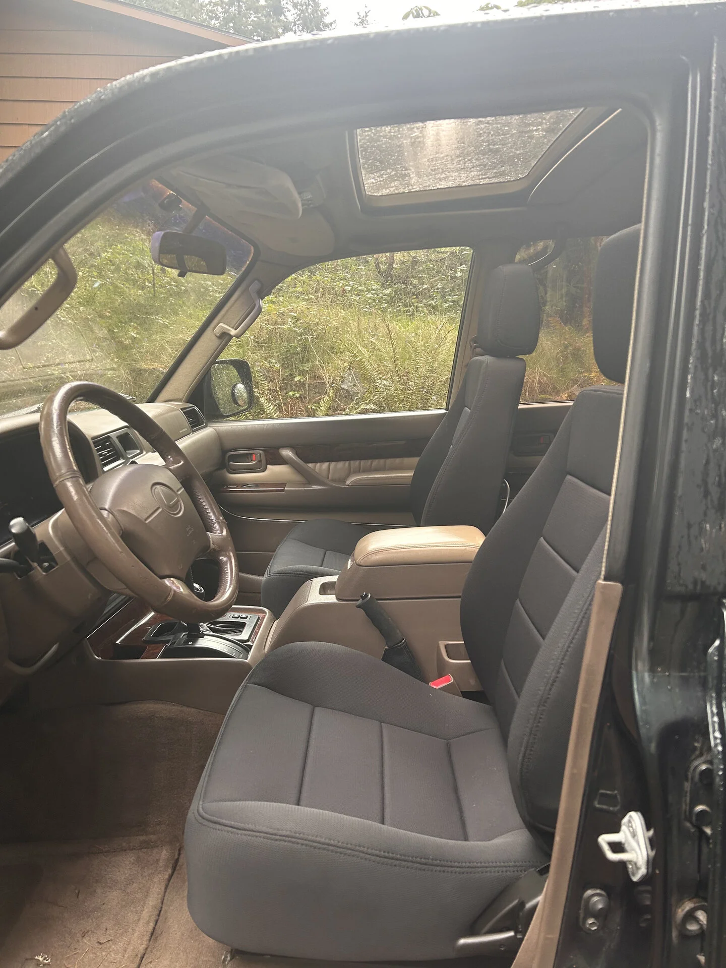

Wanted to work on the wiring harness, but it's raining and I don't have a garage so I just yanked the old front seats that didn't move and swapped them for a set of cloth Corbeau Sports.
I'm a little disappointed with the new seats. They seem comfortable enough, but not quite as nice as I expected.

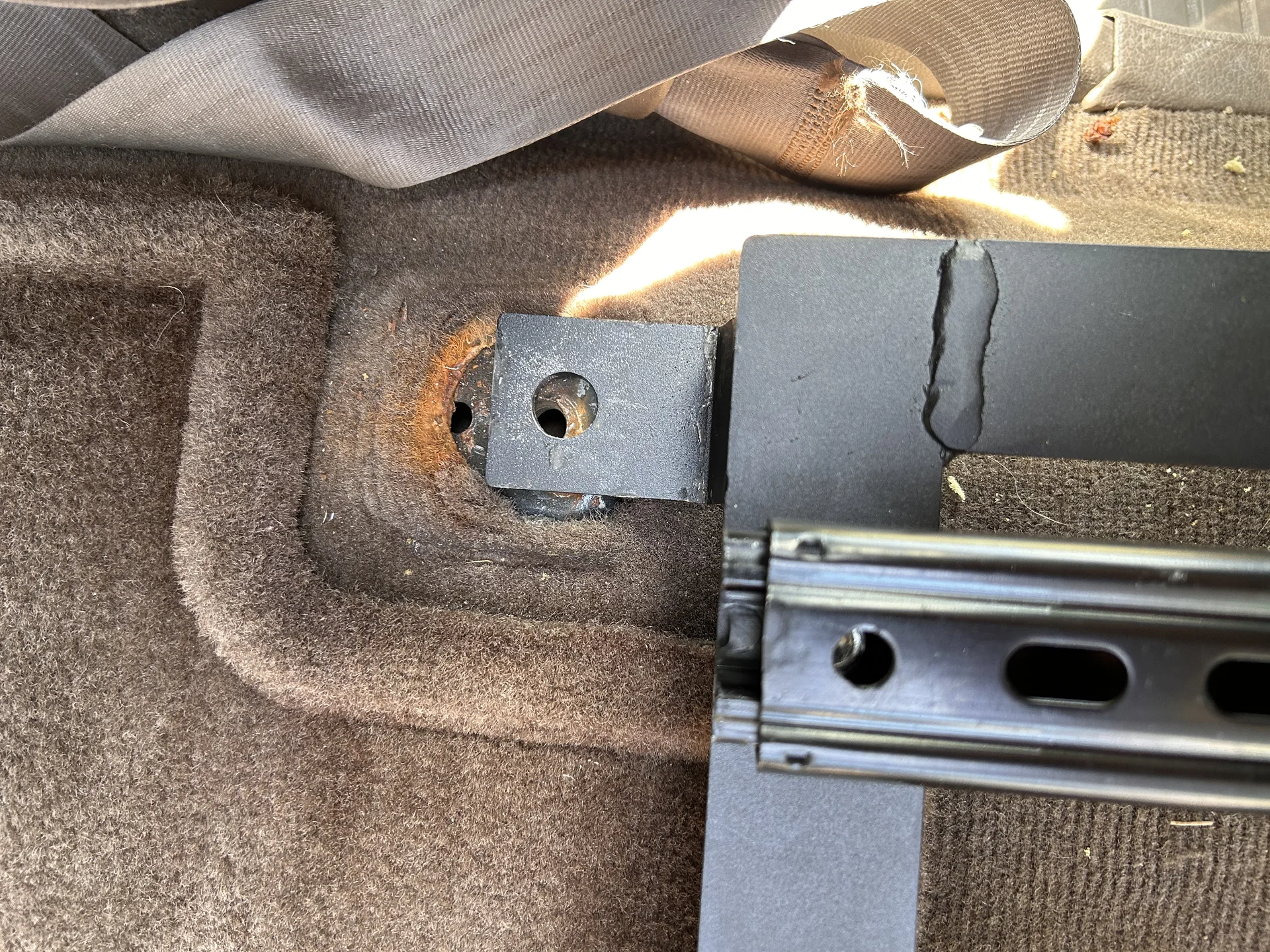

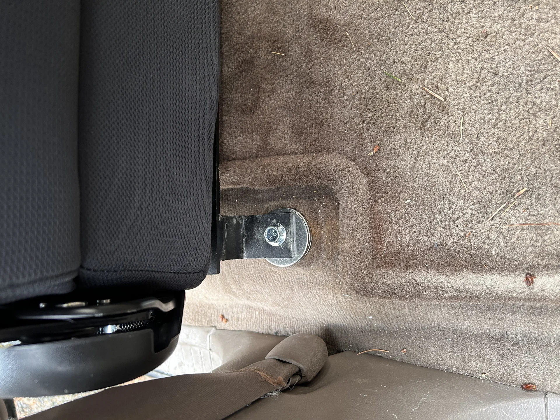

Also, the 80 series bracket they sell did not even remotely fit for how much it cost. This was the closest of the rear holes. Shimmed all four rear legs out with a few fender washers to get it to sit level after bending the legs to fit. Also had to raise the passenger seat to clear the heater that I don't want to remove.
Oh, and the previous owners cross threaded the sh*** out of three of the rear bolt holes.
In hindsight, I'd just find a pair of seats I liked from the junkyard and make my own bracket. That's what I get for trying to save time :poop:

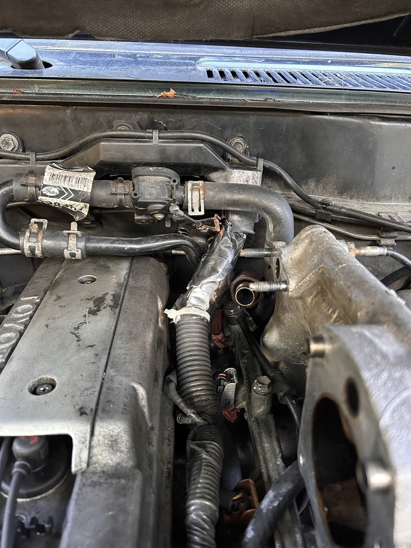

Spliced 3 wires and insulated two more in the wiring harness, then heat wrapped it and pulled it away from the EGR.
No more CEL, no more signs of a misfire, no more low speed shudder. Fingers crossed that’s all it was!
