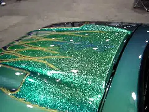

So, you're going to paint your 80 with a bright green heavy metal-flake deep polymer gelcoat?

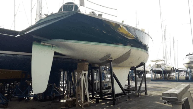

yesterday I did paint my sailboat with Awlgrip which I consider the most beautiful paint for this type of realizations.
I was just thinking of painting my old toy with this kind of paint and wondering if it was correct
