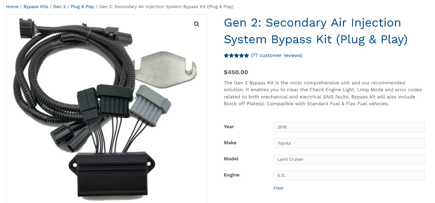

If it's truly failed, you can replace or you can bypass with the Hewitt kit.
Thanks for the info - hoping for a loose connector. I want to skip the bypass kit and just repair it the right way. What connectors should I be looking for?
