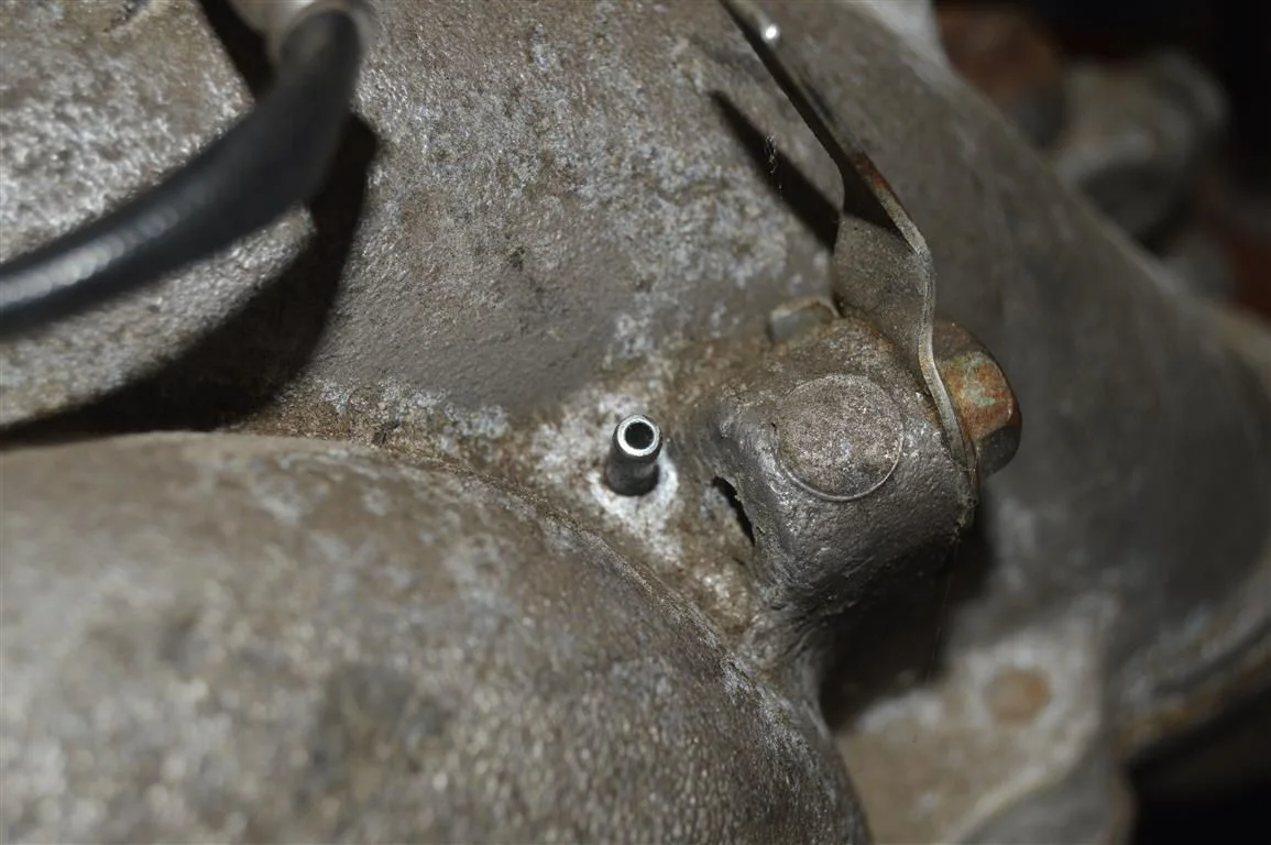

The first clog was with the transition tube that runs through the upper intake allowing the VSV to be linked to the EGR valve. This is a pic from the topside
On this one I used a 1/16" drill bit and just hogged it out. This was the first clog so I thought I was done. At this point I attached a section of hose and drew air through it. It passed air but was restricted so I swapped in a VSV which proved to flow air better.
Still no love and the P401 came back on.

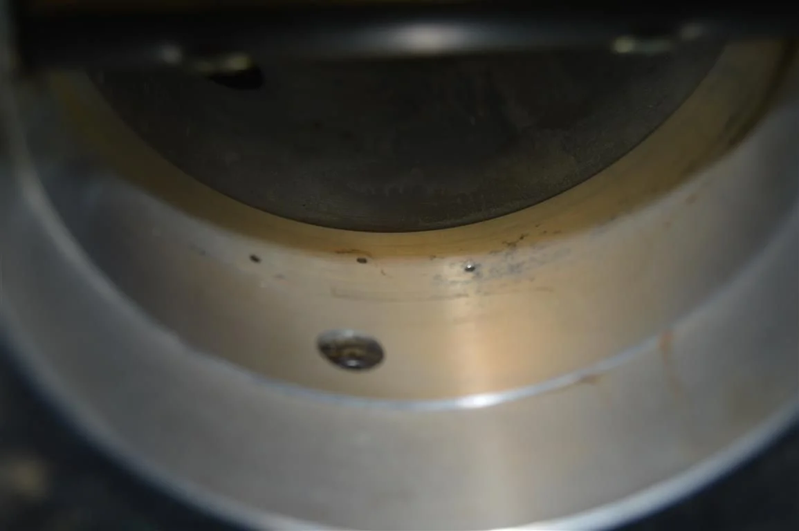

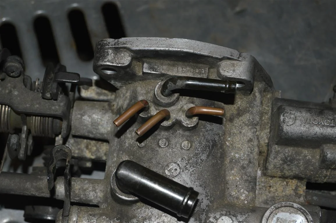

After a few sessions of testing the control side of things I decided to check the vacuum lines going to the modulator from the throttle body. The middles line was clogged solid. This next pic shows the top view and the view from inside the throttle body.
After two hours of trying to unclog that line I gave up and swapped in another throttle body. I cleared the code and took it for a two drive cycle run and the error hasn't returned. This is a route that I've used several times to test the system and until today the code always returned.
