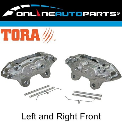

we don't have napa in oz. I have had these for a while now, they feel good n shiny, no rust for a reasonable price
I would guess any V6 pickup and 4Runner (80’s mid 90’s) would probably also work. Don’t know if you guys got any V6 in these models, since most of the world got cool Diesel engines instead
