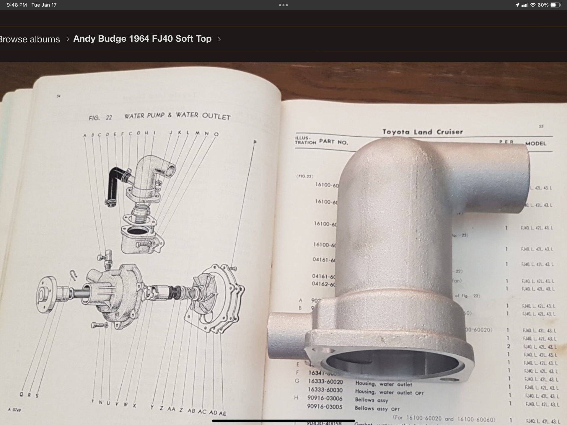

I was having a hard time finding the gasket for between upper and lower 1967 thermostat housing halves.
Searching on Toyota P/N 16341-60010 I wasn’t finding any hits on FJ40 vendor sites, but I did get hits on forklift parts sites with the same P/N but for a much later year forklift motor. Gasket prices were good but the shipping was $12-$20 for a single gasket.
I ended up ordering from Lift Parts Warehouse and bit the shipping bullet. Figured a Toyota part number is a Toyota parts number, right? Ordered several just because the shipping was the same.
Parts arrived today. The gasket fit!
So I successfully ordered an early F (1967) engine thermostat housing gasket from a current day forklift parts house using the OEM Toyota P/N 16341-60010.

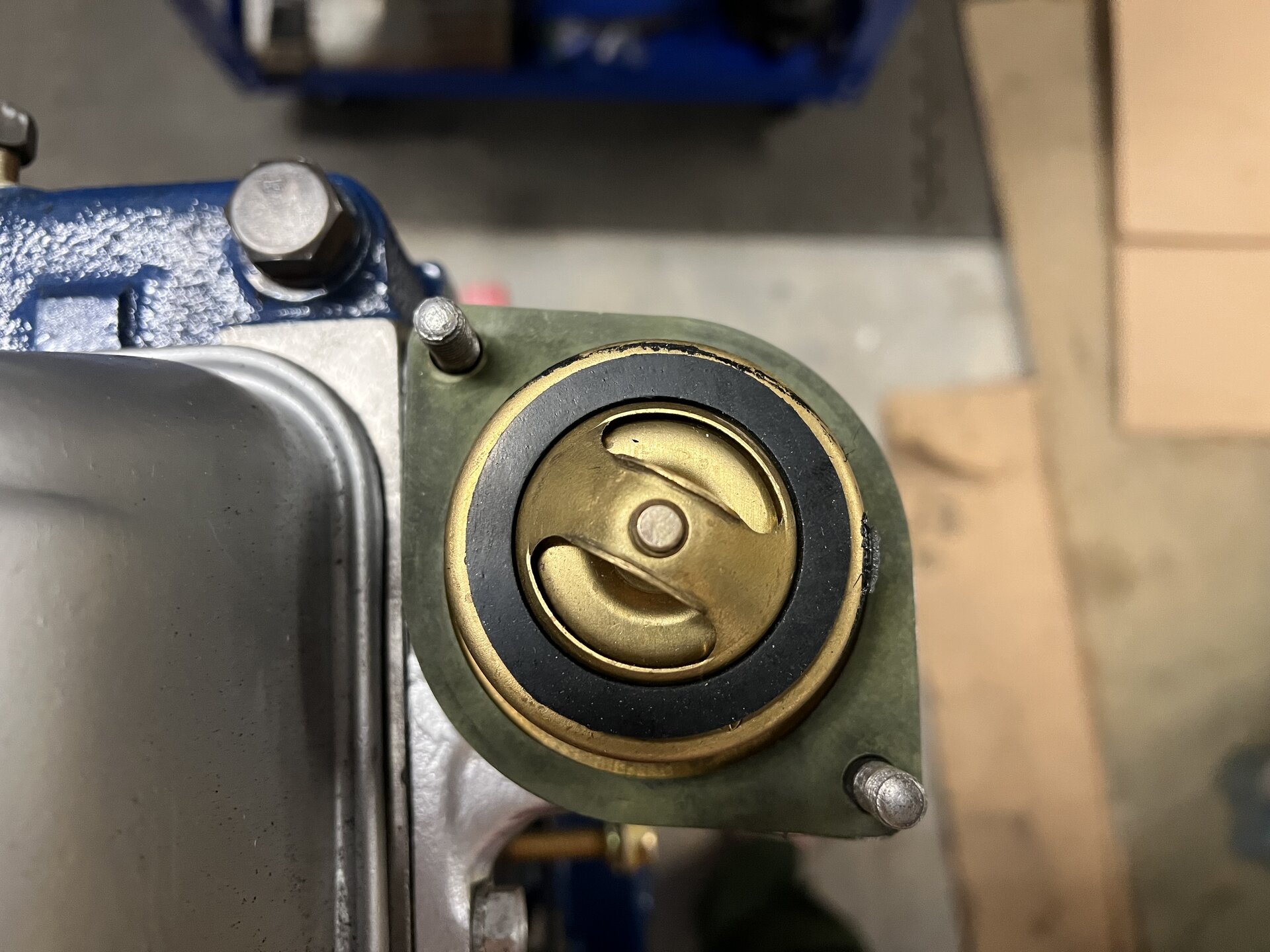

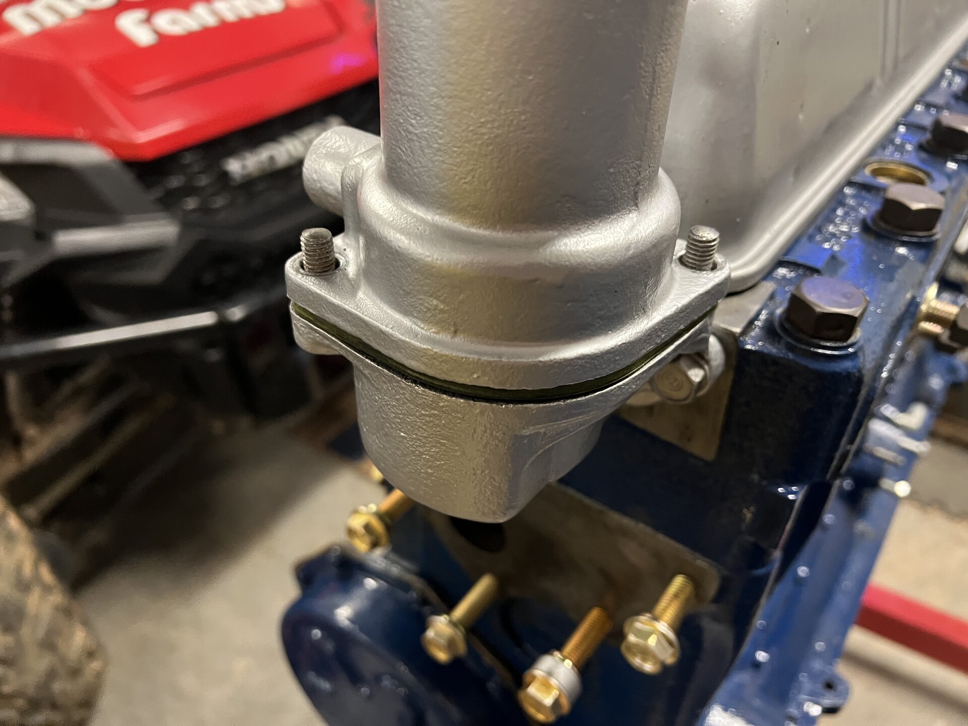

There have been posts about folks using the thick rubber gasket that comes in some thermostat housing gasket sets, and they leak. You don’t want a thick gasket between the upper and lower housings.
I reckon I will trace a couple of copies of that gasket on some gasket paper I have before I button things up on the thermostat. That way, if I do get a leak, I will have spares to replace it with.
if they all leak, I don’t understand why they would still be sold. However, I will use your caution to create some parts based insurance if I have found a flaky gasket part. Thank you for the heads up.
