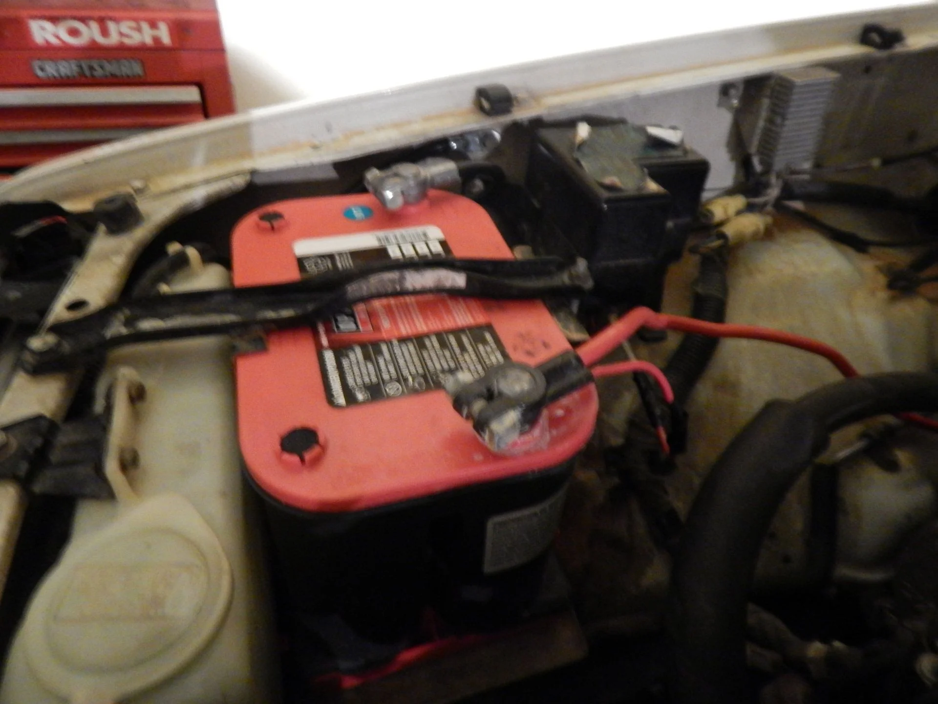

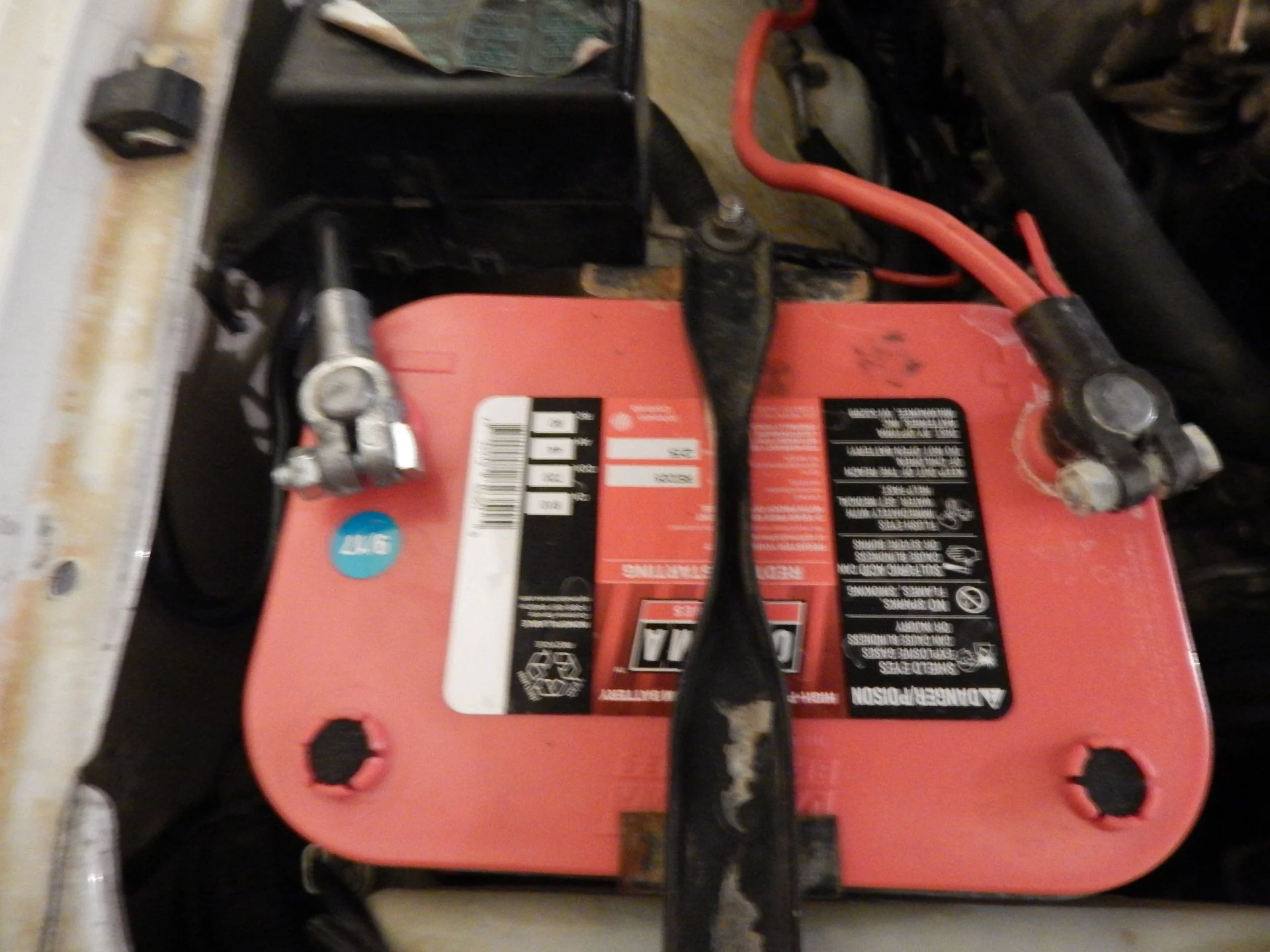

So a couple of months ago I replaced my battery with an Optima red top. The battery I removed was a group 25 that appeared to be factory type. I bought a 25 series Optima and for some reason it doesn't fit my hold down bracket. The bracket is still holding the battery in place but wanted to know if anyone else has run in to this?
I guess another question for those that have installed an Optima battery, what group size fits the stock bracket and is the correct height?
I've had two that fit that way. Make an adapter, I used a block of wood.
I had an Optima in my '87, I think it was a group 34, it had 2 sets of terminals, it was the biggest one I could fit in that tray. That battery lasted 15 years!
I had a scrap piece of PT 5/4x6 decking about 8" long under it, worked well, but not a perfect fit.
I seem to recall when I ran a red top it was a group 34, which is a bigger battery, but I still had to space it.

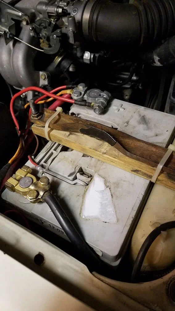

As far as your problem, the battery I currently run is an old Sears Platinum (Jan 2011). It is a group 78/86 and it also is too small for the tray. Here is my fix to get it to stay put.
BTW, the battery tray and the hold down bracket are still available from Toyota.
OK, Well I'll just keep an eye on it and if I need to use a piece of wood I will do that. Thanks for the replies.

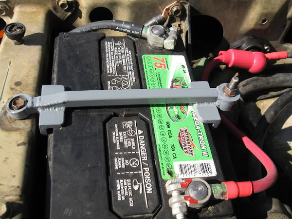

I made a replacement battery hold-down strap after the OEM part rusted apart. Not too difficult of a fab job. Made another for the FJ60, wouldn't be too hard to make one with an offset in it so no spacer required.
FJ60 strap:
FJ60 strap:

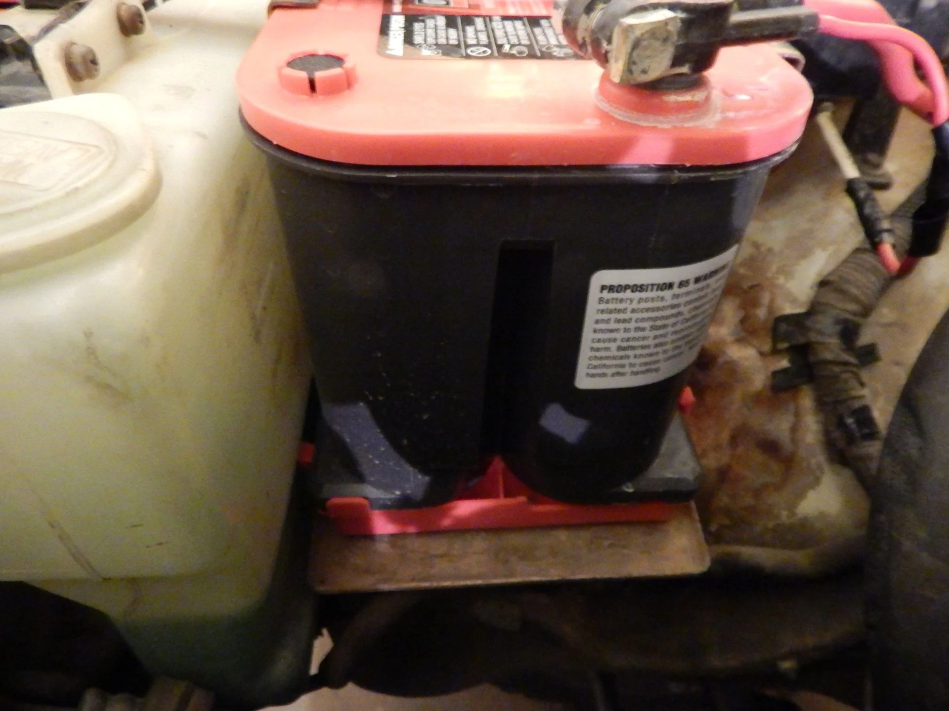

That looks great! I am using the spacer the battery came with to add height. Good job on the bracket!

Back on topic - Seems mine came with a plastic spacer block like Saul mentions. With the 34R in a 2003 Taco the spacer block brings it to a height that the factory hold down works great. Don't know about the Gen 1's. Now if I just wish the battery had lived up to the hype. $240 on Amazon now so no way.
