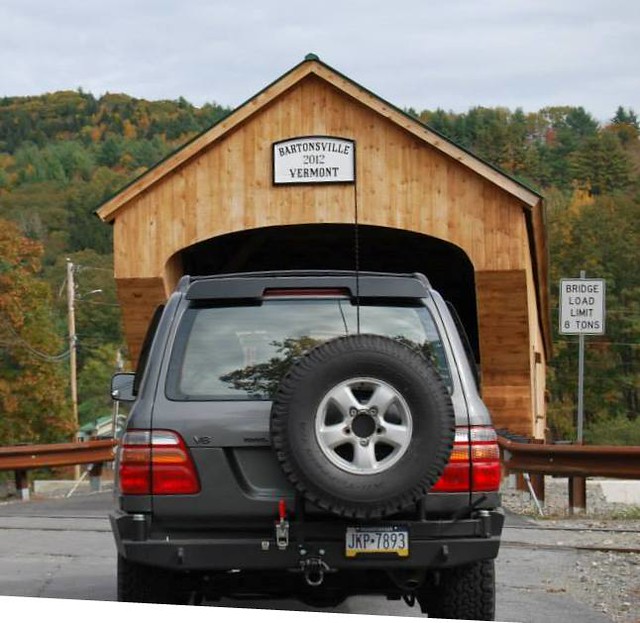

Andy - thanks for the compliment. Yes, you understand correctly. It is super easy, maybe 10' tops. Look at the picture of my truck about to go under the bridge. The cylinder/sleeve under the driver side brake light. The silver cap is the same as on the tire carrier side. That cap comes off, underneath is a castle nut and cotter pin. Remove pin, remove nut, lift off the tire carrier, install the cylinder/sleeve, reinstall nut and pin and metal cap and bam, you're ready to go.
