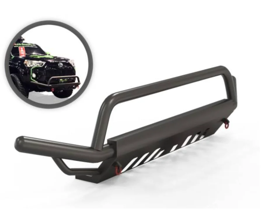

Vanguard Off-Road Black Powdercoat Endurance Runner VGUBG-1784-1178BK​

I often see many claim these are actually “damage multipliers” due to the way they are mounted and not the same as a full on frame mount steel bumper.
I personally don’t have any experience with these or if the above statement is true
I have heard much the same as Acrad. I don't know what kind of steel they use.
Unless it mounts directly to your frame, run, don't walk away.
As Acrad stated, any and all these type of bumpers are "damage multipliers". When you're in a little bumper to bumper, these will bend up into your grill, the wide ones, into headlights, etc. when all that would normally have happened in a little bumper to bumper would have been maybe a scratch. That's why they're call damage multipliers, a little bump that may cost little or nothing if you didn't have one, is now an insurance issue.
It will also cause more damage to whomever you may bump into because it's hard steel and not flexible plastic that will return to it's original shape.
Oh, and those recovery points with the wee little red D rings!! :rofl:
In all honesty, if you want to go discrete or low profile, there are many other options that will work FAR better than that thing above. Look at what Victory 4x4 offers.

I said something similar but I deleted my post. These are indeed damage multipliers unless they are good steel and attached directly to the frame using some good mounting hardware.
  • Like
Reactions: r2m
I agree, for that price, it can not be high enough strength yield to have the desired effect.
Not even getting into how much leverage it would have on its mounts.

Also, that bull-bar you posted wouldn't protect you from a larger 4 legged animal even if it was strong enough, it'd probably still crush the grill and?? You probably need something taller like an Ironman or ARB with the hoops over the front grill and lights, if you really want to protect your front end from an animal strike.
