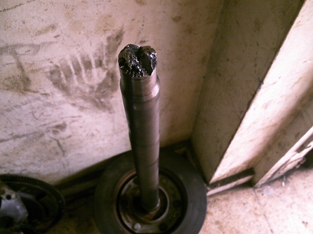

I drove a 40 series ( rear FF ) ARB locked with only one wheel after broke all of the outside flange bolts on the FF .. ( the pass side ) so I drive back home with my rear ARB locked and only one wheel drive ..
All the way need to corect the track coz I feel the the drivers rear tire was " pushing me " outside of the road ..
O also broke a rear SF ( long side ) on my Tencha but was close to the garage, so thanks to my rear disc I can go back to the garage without problems and pull the shaft for swap ..
