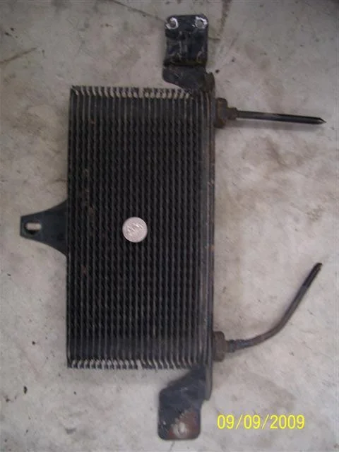

well, i picked a oil cooler off a older f350 for 10 bucks....they do these 10 dollar per item days at out local pick yard...its great for stuff like this..
anywho, i'm going to complement the stock tranny cooler with a large power steering cooler. Nice part for the $$. I figure it cant hurt..good source for others wanting auxillary coolers..

Thanks! My 80 has a large stock tranny cooler. That ford unit is stricktly for my PS.

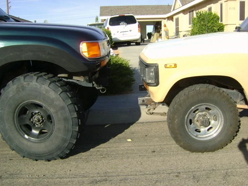

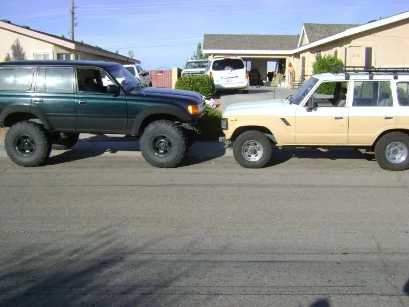

I just had another one of these, so i'm on mr. mom duty temporarily...
Ha Ha nice. Mr Stork dropped you a little package. Congrats.
David and Goliath...
Here's the 80 nose to nose with my uber stock 62 on 31's...
No update? Kinda looks the same. On mr. mom duty still?
