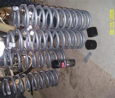

getting closer everyday... i bet they're real fun to get in this weekend...i antisipate lots of xxx rated cussing, sweat and blood to heave these bastards in.
Nice! I like them in black too. Post pic when done. Those mediums or heavies?
You get the shocks yet?
mediums. 6"er's.

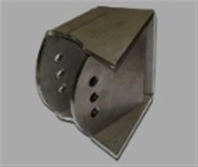

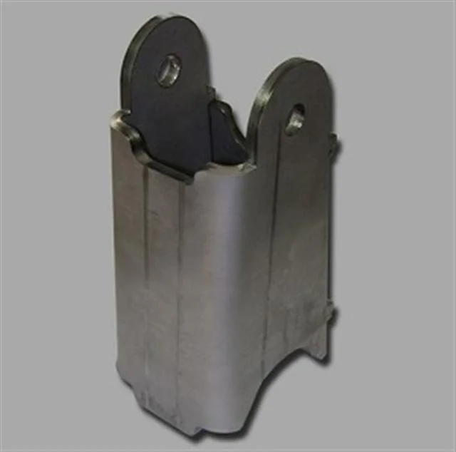

You're gonna want new control arms to adjust for your caster, then those 39s will stuff all the way up to a 2" bumpstop extension and not scrub in the front (unless it's flare) and it's easy trimming (or just let the behemoths self clearance your fender, any cuts that happen in the tread aren't bad) in the rear.
Thanks for the good words! Honestly, I plan on placing a angled link bracket on the inside of the frame. from there I will make a simple DOM upperlink with a 1-1/4 heim/spacers on one end, and poly bushing on the other. I will do a link tower on the upper axle housing, and will also hack the front of the radius arms off at the first bushing. i will then box the front mounts like mini skids. This will become a working 3 link with panhard configuration. I just have to get underneath and stare some more to see where things are gonna go..castor will be limitless..i'm also going to extend the sway bar links. I'd like this to drive like it does now..relatively speaking!
