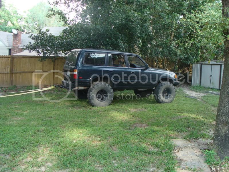

Well, here it is on 38's. I had put the modified swaybars back in, and I must report that it is 100% better than without swaybars.
The suspension rides great. 4 golf balls per tire as per codyrx7. 20psi air pressure. It really goes down the road like a stocker, just way bigger. The power loss I can easily live with untill the regear. I will also eventually deflare the rig also, but everything clears just fine. There is some faint diveline vibes out of the rear at around 60 mph indicated..only under deceleration though.

I was brousing through some old pics, and found one shortly after i bought it... almost 3 months ago to the day...
my wife says " you messed it up that much in 3 months" haha. shes a comedian..
