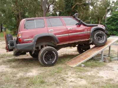

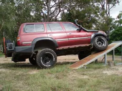

These first two pics compare the flex of the old kit with 2" kings springs, N73/N74E shocks and the new kit with OME418/421 coils, N73L/N74L shocks.
I'm not sure of the angle of the ramp but the old lift measured 2075mm along the ramp while the new one went 2155mm.

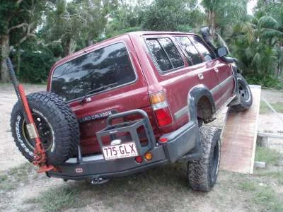

This next one is a good one to show the new ARB rear bar.
Have we all seen this ARB bumper? Unless I missed a report on it can you post a new thread on alone? Lots of pics etc ..
