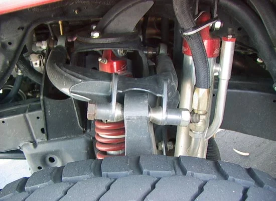

There are several great adjustable coilover set-ups for the front of the Tacoma/4runner. KINGS, Camburg, and Donahoe are the high end products. Donahoe was running their off shelf product on their race truck and won the BAJA. SAW (sway a way) or Fagtech would be lower end coilovers.
They are adjustable so you never have to screw around with trim packers, they ride like a dream, and they are fully rebuildable (althoug very few people ever use them hard enough to need a rebuild).

KINGS and Camburgs can be had for $850 and they ride and perform much nicer than SAWS. The Donahoes ride the best from my experience. You can also get the "extended" Donahoes and combined with a uni-ball upper arm you can get 1" additional wheel travel. May not sound like much but it is noticeable.
I have driven in trucks equipped with all of the options. The high end products handle much better on and off road.
And to answer your question, most of the TTORA people who upgrade to coilovers are saving the extra money because experience shows it is worth it. These high end products are selling very briskly.

Yes, you could buy just the coilovers for now and set them for stock height. They are easy to adjust, even on the truck. If you have ADD, you don't want to crank them over about 2.5 inches lift to be nice to your CV's.
At some point, when you get the topper, etc. or whatever you choose to do, then you can get your semi-custom rear set up.
Now I just realized you are in CO, so you have other options which is in CA. Check out http://www.aor4x4.com/tacoma.htm also. They are a CO company and they can also hook you up with your needs. If the are down the street or something, you can save on shipping.
As far as the a-arms go, they are optional and you can wait till your upper ball joints crap out on you. Some people never get them...

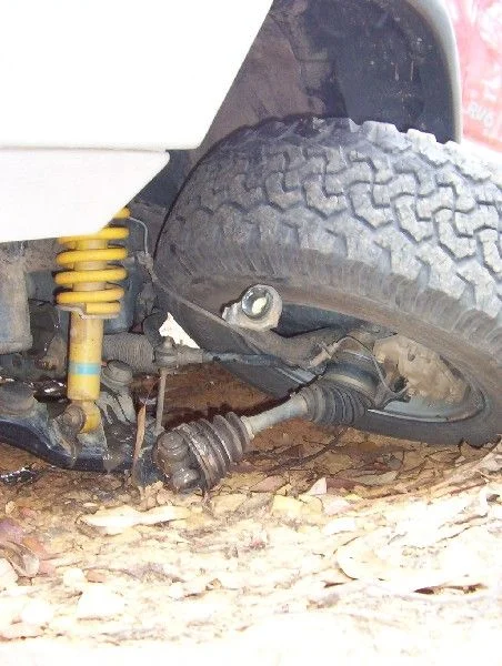

I not only beat the seam weld flat, but had to make another 1" of room on the prado to run 285's on 4.5" backspacing.
W e are also starting to get some lower ball joint failures here under 100,000km lately.

Does anyone make aftermarket arms in AU? We commonly replace the uppers with uni-ball style replacements but I haven't seen many lower a arm failures.
I did the seam weld but I didn't have to trim anything else to run mine on my runner, I'm using 4.25" B.S. wheels though. I get no rubbing at all.
you got a suggestion for shocks for me? I may get some in a couple weeks to replace these.
Bilstien is the shock i prefer, i use the 6 series [yellow] ones for what we do here,
And no, no aftermarket arms here...... yet ;)
But have had some horror stories of frequent replacement of uniballs compared to OE ball joint, which doesnt help, but Kreg at DR seems to have a different style of mount for the tundra, which may work.
