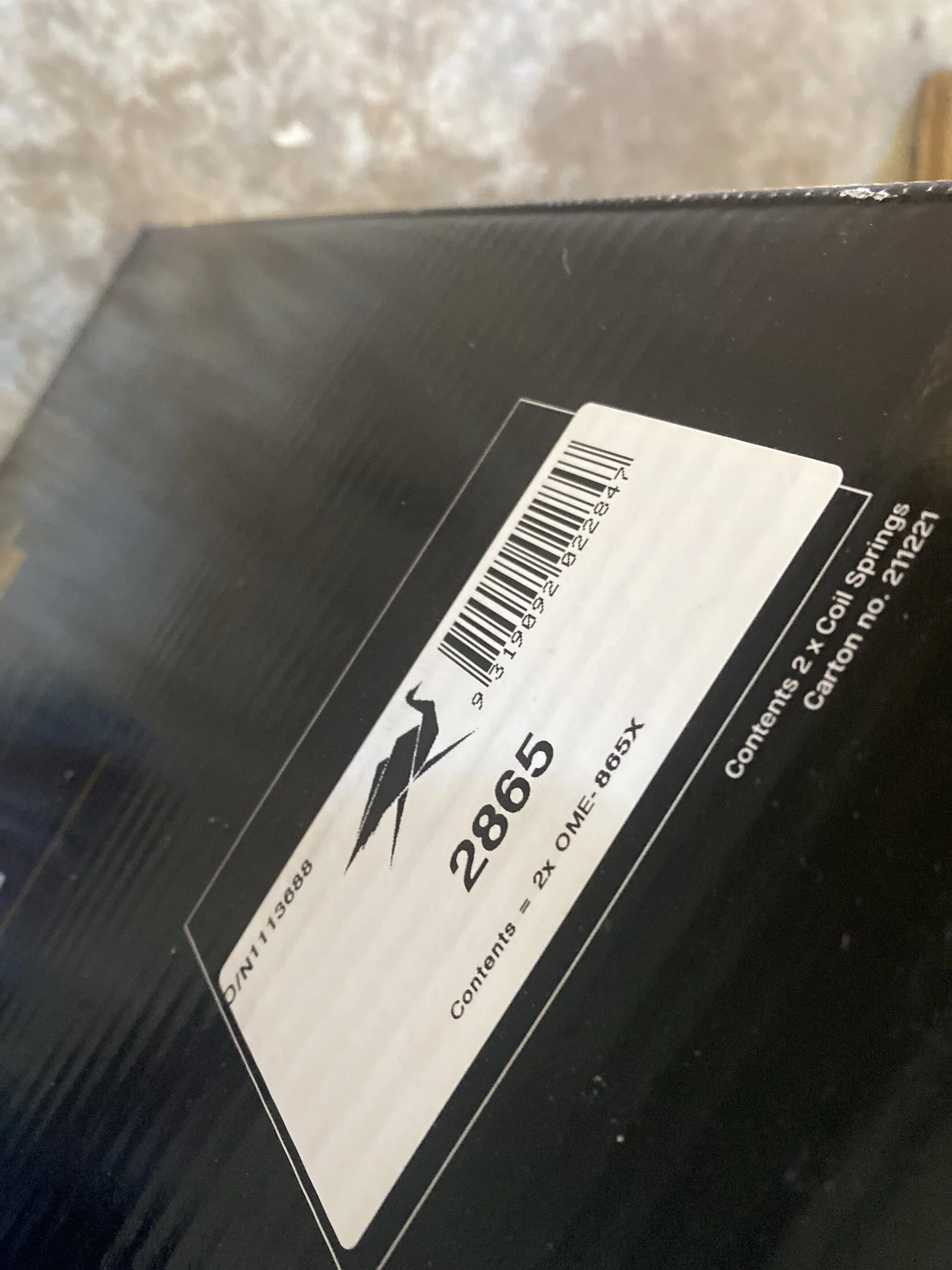

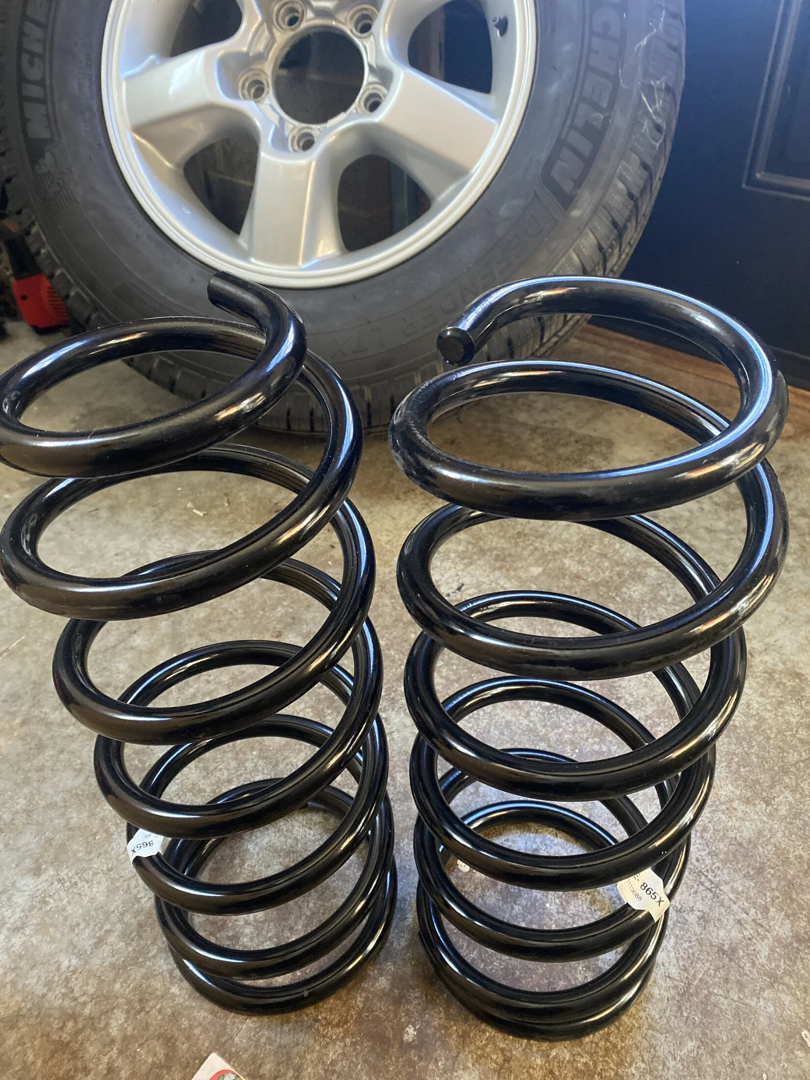

I am attempting to install my rear springs I got from Slee and running into an issue. The springs I got from them are not labeled left or right and both are same height. Am I missing something? I thought they should be labeled A and B with one slightly higher than the other.
The 2865s don't have a driver or passenger side. It will be good, just install them. If you're worried about the slight height difference you'll have, some people add a short spacer to the driver side (where the extra weight in the fuel tank is).
Ok I didn’t realize that. I’m going to install and see how it sits to see if I need the spacer may order a set just to have later anyway. Thank you!
It’ll likely look fine for about a year, then the driver side will settle a bit. I’ve got a spacer waiting for me to have the motivation to install it.
