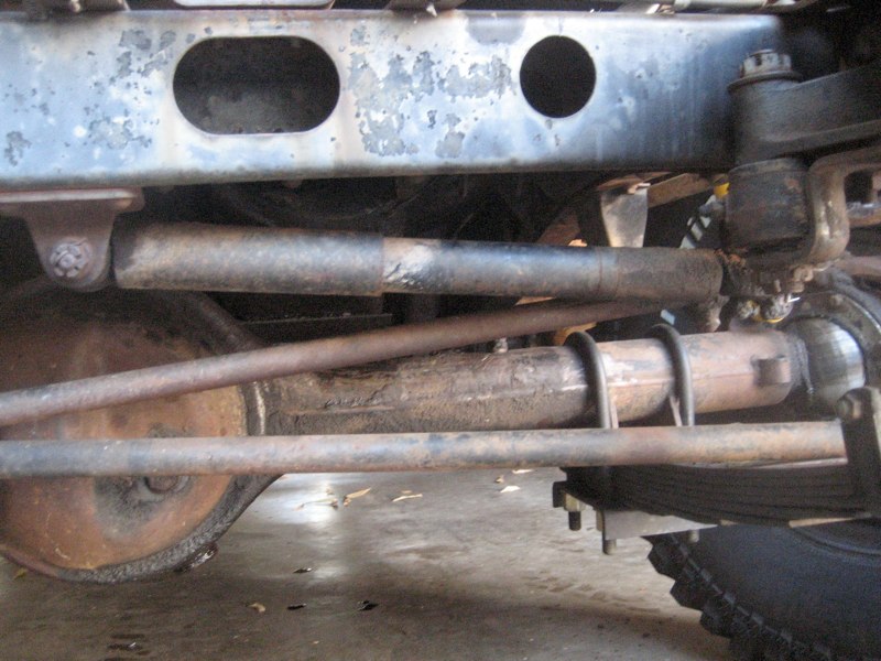

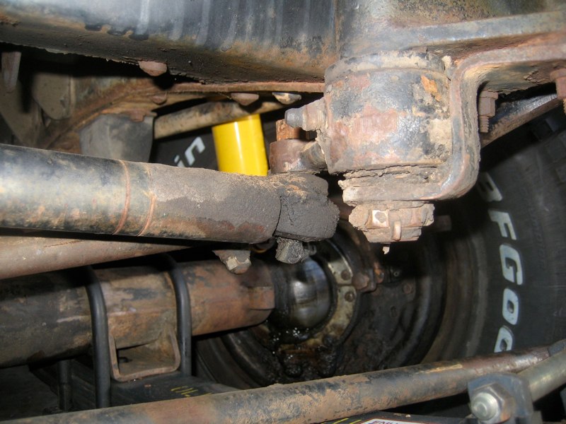

I removed the stock Toyota...

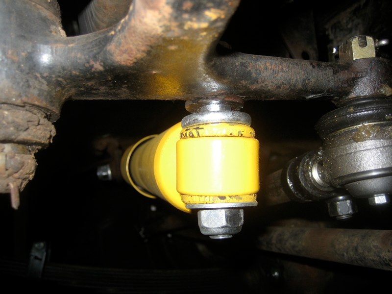

One bolt on the center arm...

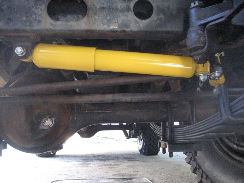

And the other on the front of the frame. Installed two tapered bolts with nylon nuts (4 total) and voila!...
Steers BOTH WAYS!!!
:beer:

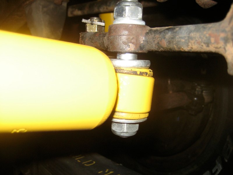

Dom, did the stabilizer seat all the way onto the bolt at the end closest to the center arm? In the pic you posted, the center arm hiding what I am asking about. My stabilizer would not go all the way down on the bolt so I was wondering if they sent me the wrong one or if it is not suppose to?
Here's how mine bolted to the center arm. The bolt ends that attach the to the frame and arm are tapered and tightened all the way and they are well seated but have a slight gap. As for the stabilizer, the eyelet is seated pretty well on each end.
Here are closeups...
I did take note that the hardware for the 24 (60 and 70 series) was the same as the 23 (40 series) so maybe the tapered ends fit deeper into those applications? These are snug as can be so I'm not sweating it. Hope that helps.

Steers BOTH WAYS!!!

As a note the tapered pins on the SD23 and SD24's are not supposed to seat 100%, and I can promise you that if you try, they will break in half :D I try and make a point of that when talking with customers, thanks for the reminder.
