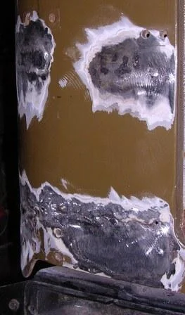

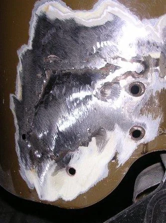

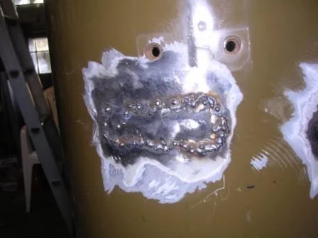

Vacation also let me make progress on the beloved BabyPoopGreenBrown 40. Thanks to some excessive grinder work by me to make the patches and some very nifty welding by Randall, I was able to progress to the "frankenstein" stage:

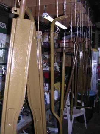

Ideally, I would only paint the qp's and the left fender, but I have found that my Tower Paint rattle cans produce a color that is somewhat different than whatever Spencer used. Close, but not close enough. However, it did work quite nicely for painting my new pakistani bows. I got this box of goodies from Bull (Rodney) in WA a few weeks back, cleaned 'em up and sprayed 'em as part of my vacation in the garage. I am very impressed with the bows, can't wait to pull the hard top and set it all up.

Back to the body work. Frankenstein was prettied up by the angle grinder and sanding disc. The results look good, but, of course, many pinholes were revealed on the edges of the welds and they will have to be addressed by additional welding or some lead.
I would fire the welder :flipoff2:
Looks like somebody sneezed all over that patch! :D
I would spray some undercoating around the inside of that corner, after you clean it all up etc. Just as added protection from stones, sand and stuff coming off the back tires.
Hard to fire a volunteer!

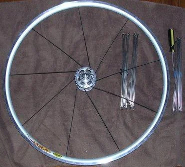

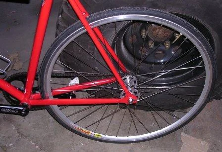

I did some work on Olive, too, but sure had fun (and less back ache) building the wheel.

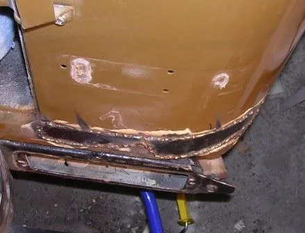

I cut out the bad part of the ps qp, and this time the whole thing worked out better for a few reasons. I was much more aggressive about cutting back to good steel. I made the fit my patch panels much tighter and much more even....getting the curve right was a little more challenging, but it came out well. And Randall got the welder working better for this light duty work. All this is making me consider reworking the ds qp to make it as good as this side. Anyway, I ground it down last night, no pics yet.

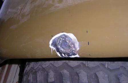

I also opened up the hole in the fender and we tacked it to the support...should hold the mud better and it will definitely will be solid.
