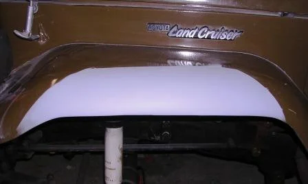

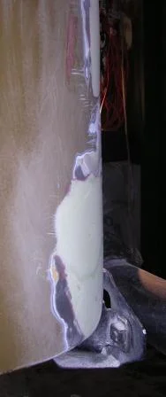

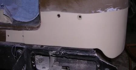

So then I got my first chance to do any body filler work, and it was interesting. I am generally pretty weak at plaster and joint compound and all things that set as you go, but it worked out ok. Here are a couple of shots after two coats and a fair bit of sanding. You can see in the last shot that the lines came out well.

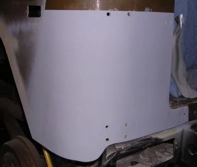

And then there was a lot more sanding and hand work, but I didn't go nuts. I was eager to get it into primer asap so I could keep things moving and see how it was going to come out, figuring that I could always do more body work if I needed to. There was one little problem with the paint on some of the old bondo, but I was able to recover ok. I used a high-fill primer but didn't really like it, so I went to regular automotive primer later. In then end, I am real happy with it, its better than I would have guessed.
The fender was probably the best surprise of all. It was pretty rough after the welding, but it shaped up very well with the mud and sanding.
The wheelwells cleaned up nicely, too.

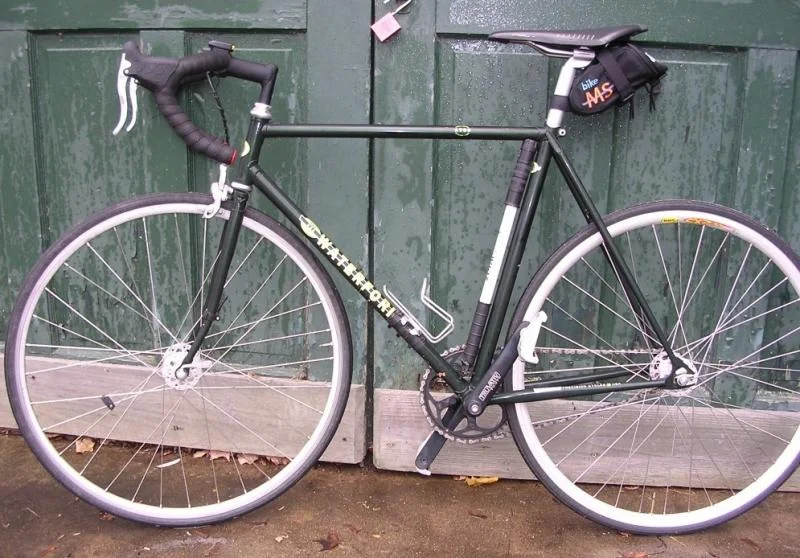

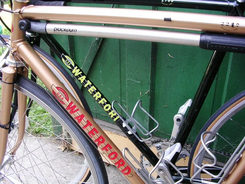

The other two pics show my biggest distraction, and the previous wheelbuilding part of this thread is now shown in place on the final built-up fixie, evil twin to my road bike, and the sexiest, though perhaps cruelest mistress a guy can have.

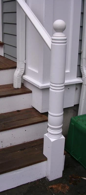

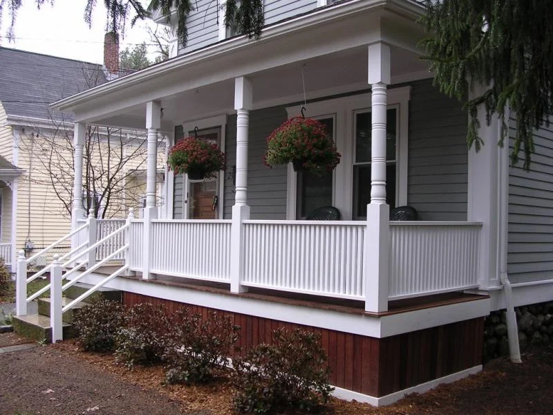

total porch rebuild (inc all new columns, rails, stair railings, substructure, skirt, paint....)
associated rear door railing

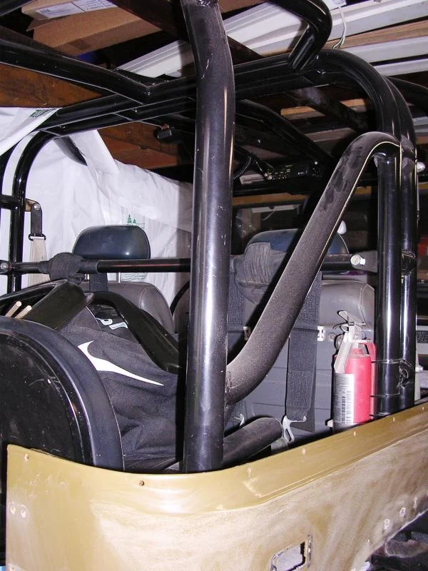

As R mentioned, we pulled the hardtop and found part of it and the tub lip to be in great shape...and finally you can appreciate the lovely cage on this truck.

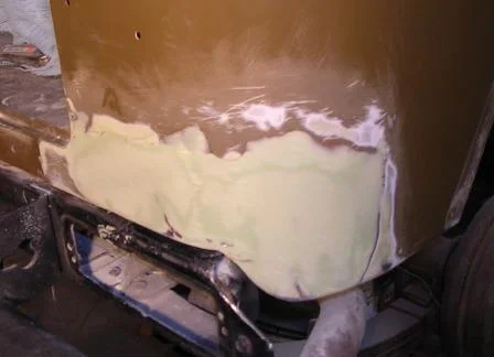

There was one last really bad spot on the outer tub, this was just below the gas filler. It has been cut out (scary), patched, finish welded, ground and one coat of mud applied.

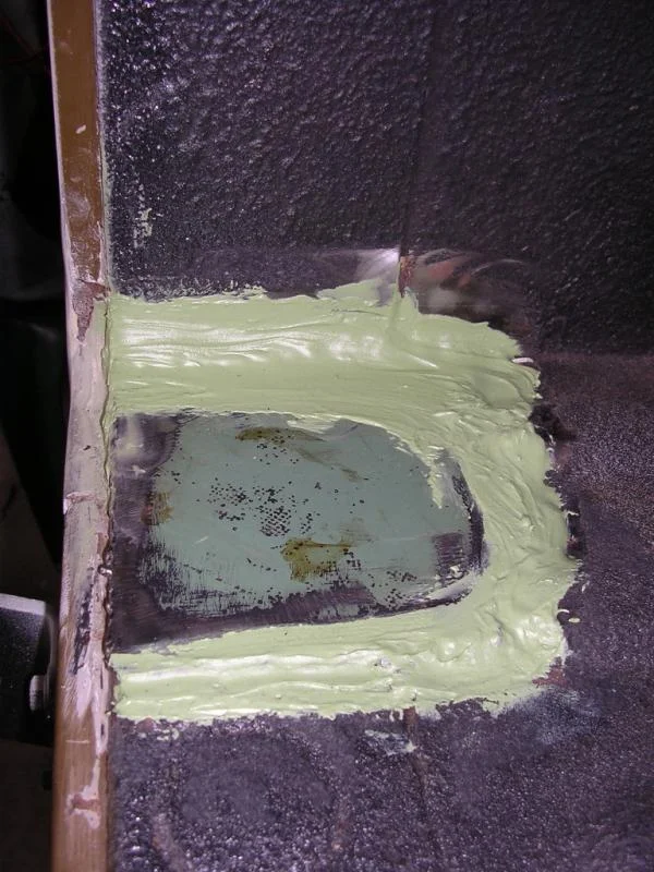

Also, there was one really really really bad spot on the tub floor, it looked just like pile of dog-doo under the tub liner. It has been cut out, a bottom and side patch added, lots of medieval welding applied, then abundant mud to fill. This will be cleaned up with the final goal of having a not-too-anally disguised patch that will be covered in tub liner in the end.

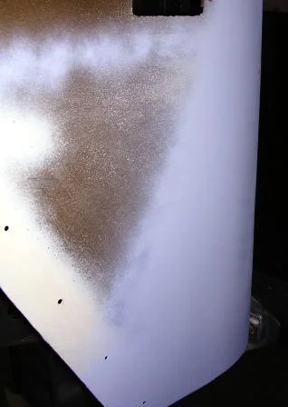

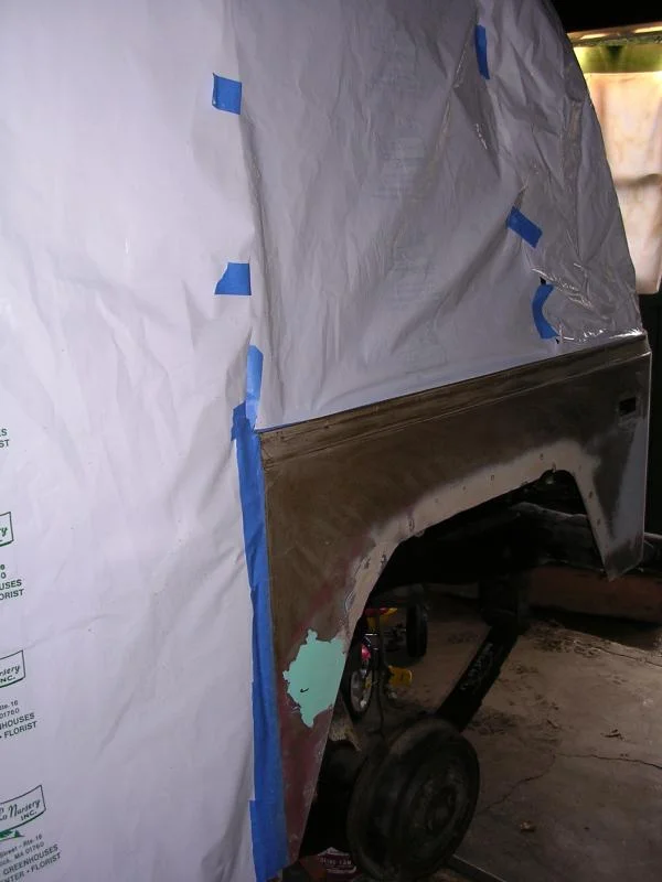

The qps are pretty well cleaned up now, I even have the d.s. masked to put on some primer to help me decide if I need more putty...otherwise, putty will go on the places I know I need it and then I will move on.

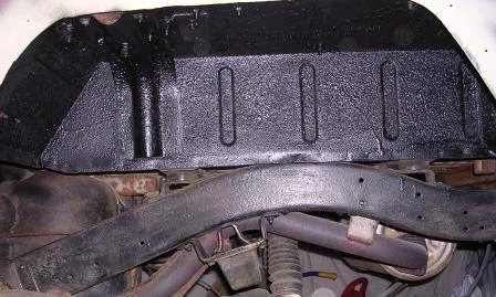

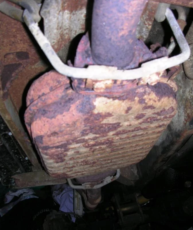

This will leave the exhaust as the most pressing issue...that alone represents progress, given the original state of the tub when i got the truck.
