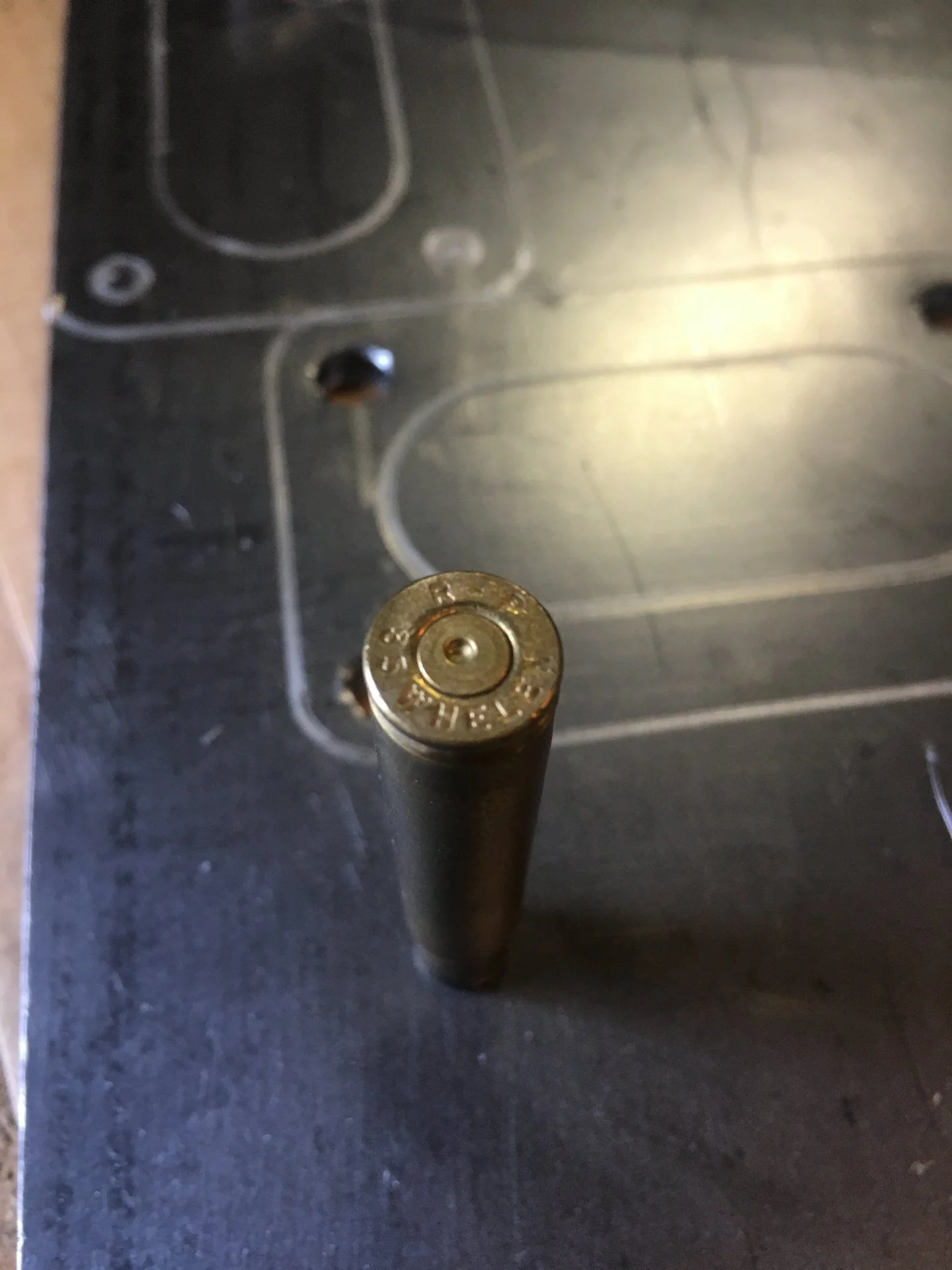

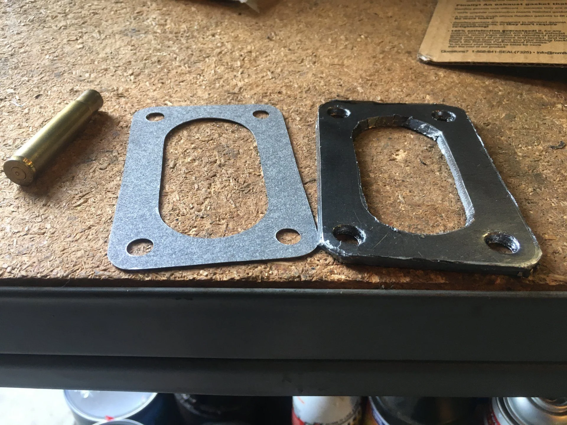

Tech Tip....don’t use the edge. (See top drawing) punching the hole makes the edge of the material mess up. Worked cleanly in the center
My punch was a .35 Whalen shell housing

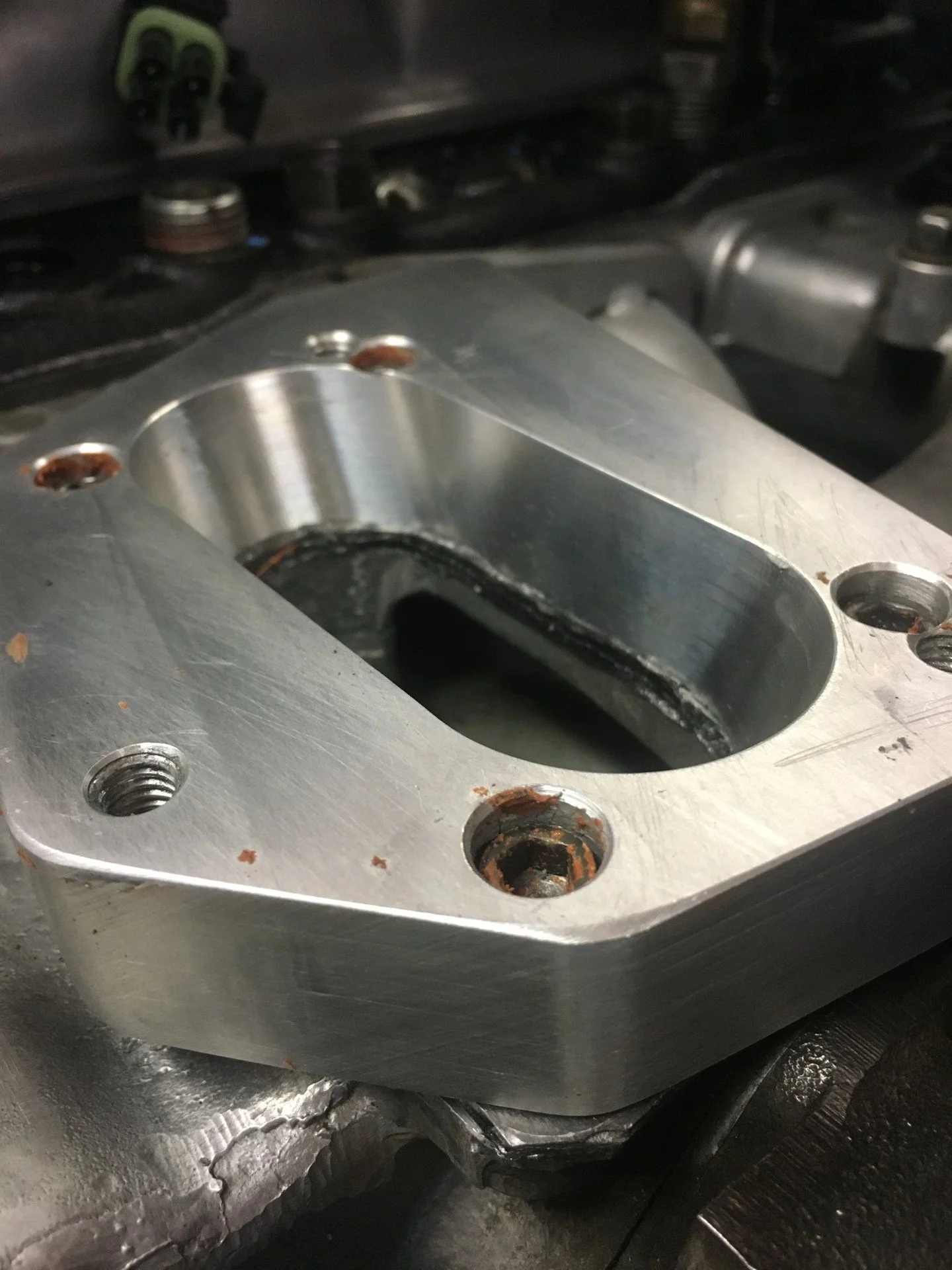

@maxbob002 and I got it buttoned up and I sent him home with the TBI that AFI fixes the injector pod on.
When I first fired it up I think I had a little leak still but after driving it the Ramflex sealed up with heat and it’s all gone.

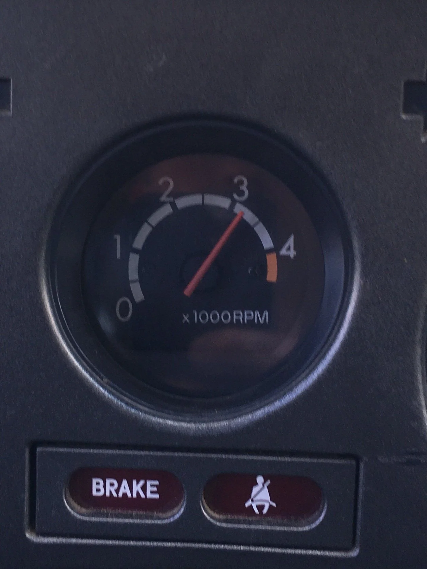

What’s cool about the TBI is how it smashes through redline where the old carbs would stutter.

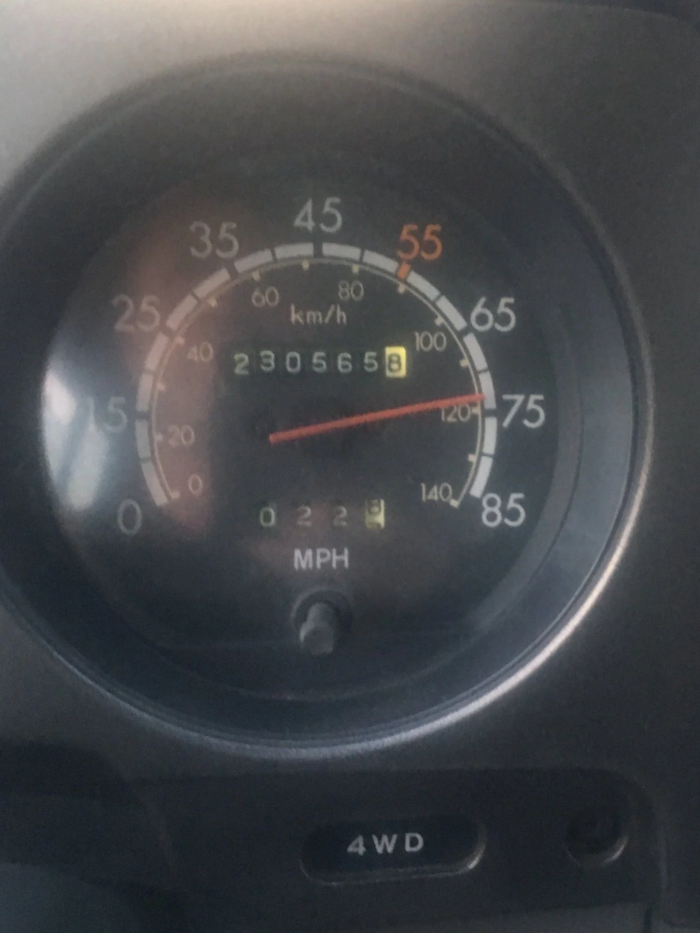

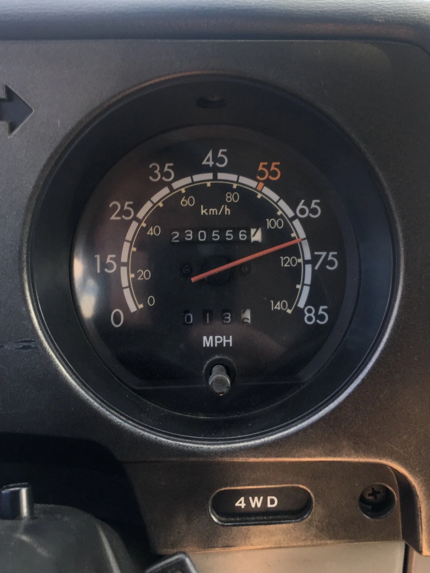

I took it for a long drive. Super smooth. I can’t explain it. Feels like it should feel. It’s no powerhouse but the power is so smooth. No second barrel kick in and hesitation.

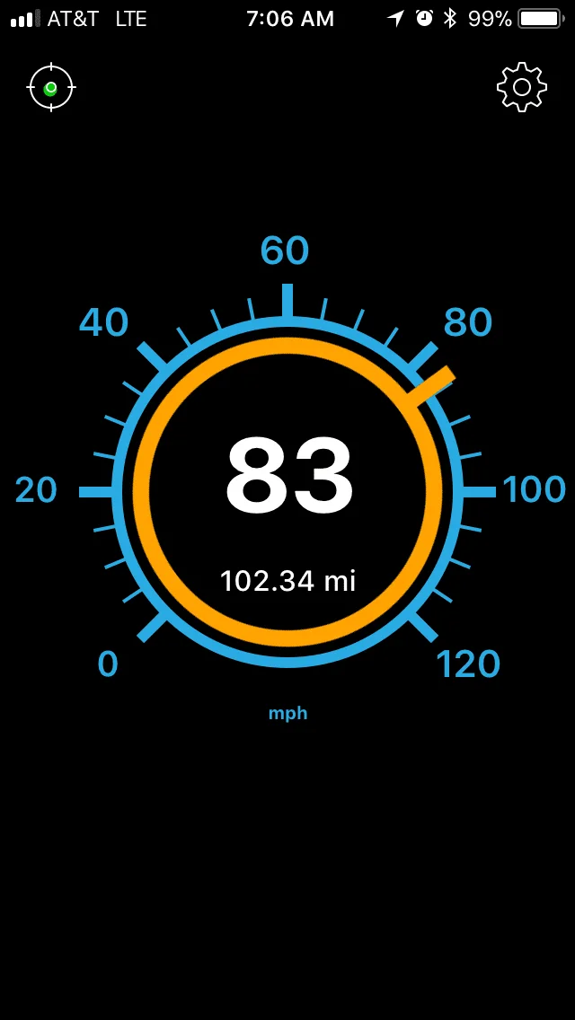

Easily hit 80 mph (speedo is 10mph slow with 3.70 and 33” tires)

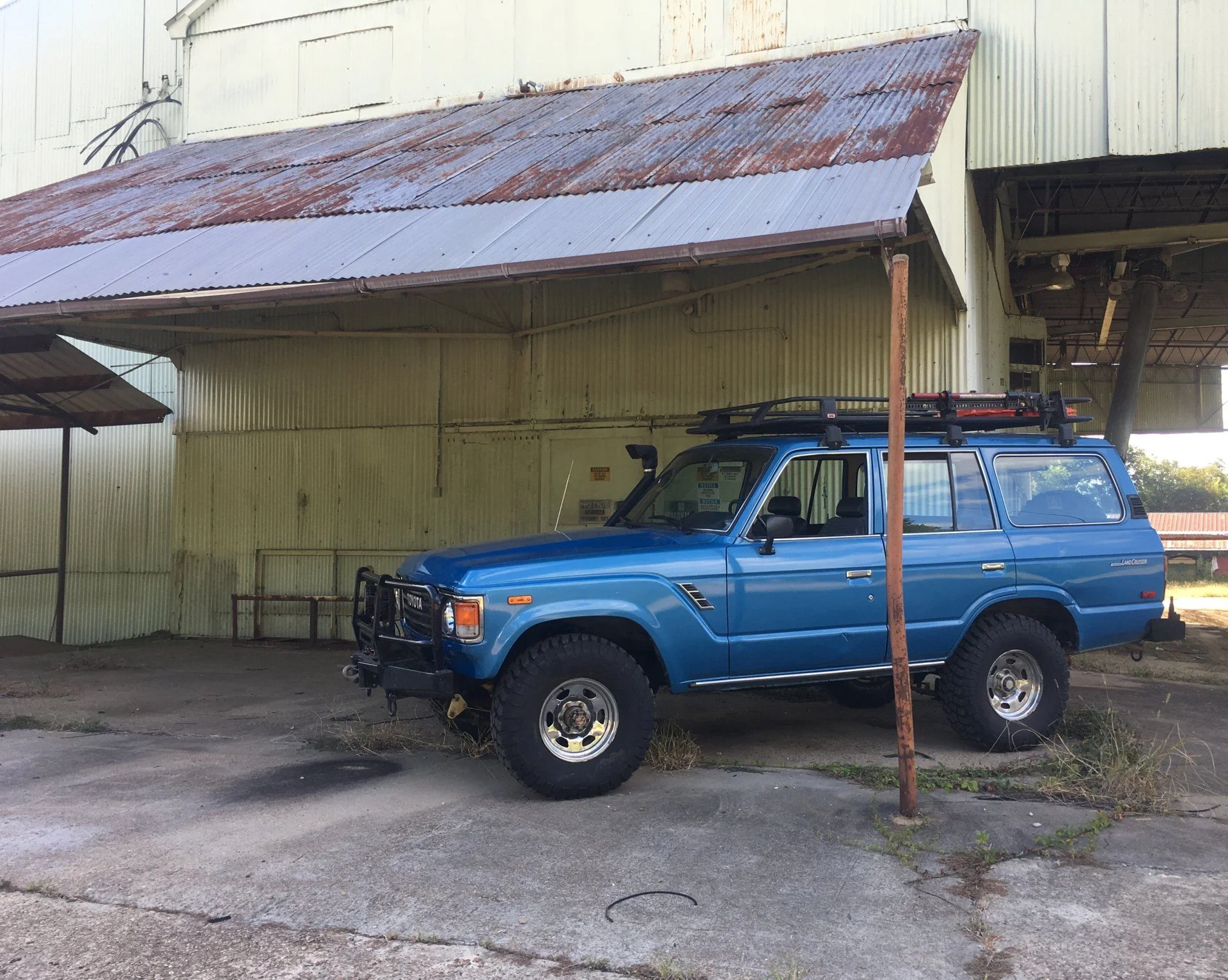

Pretty girl. I’d be finished had I given the guy the proper paint code for the hood :rolleyes:

Before the thicker gasket 2 of the AFI provided bolts for the adapter to intake were .100” too long to get a good bead of RTV in there to seal them for vacuum leaks.
After the Ramflex, they were perfect.
