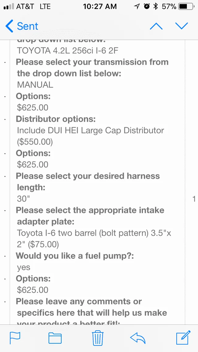

And after our private discussions, seems like when doing this the most logical place for the ECM is the glovebox (either in or custom mounted below) and that requires an "upgrade" of the harness to at least the 48" version (goes all the way up to 96")

As for harness length I did 30”

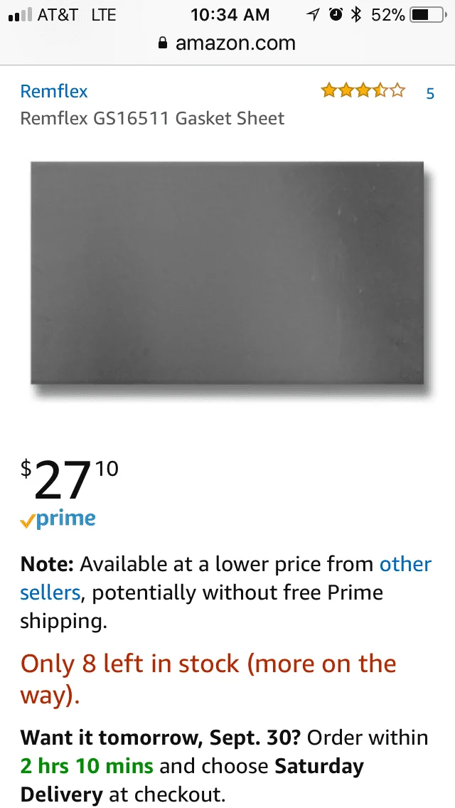

Last night I ordered a sheet of self make gasket material from Ramflex. I think the additional thickness of the gasket will make these supplied bolts be just right after. They are just right at the edge now but that does not allo you to fill the hole with RTV like I did the others

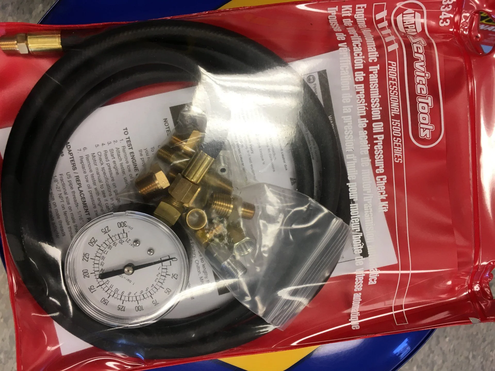

I have that same tester. I don't think it has the proper BSP thread adapter.
I think I got the adapter from BSP to NPT from Summit. Then the kit has an NPT adapter. It's been a long time though.
