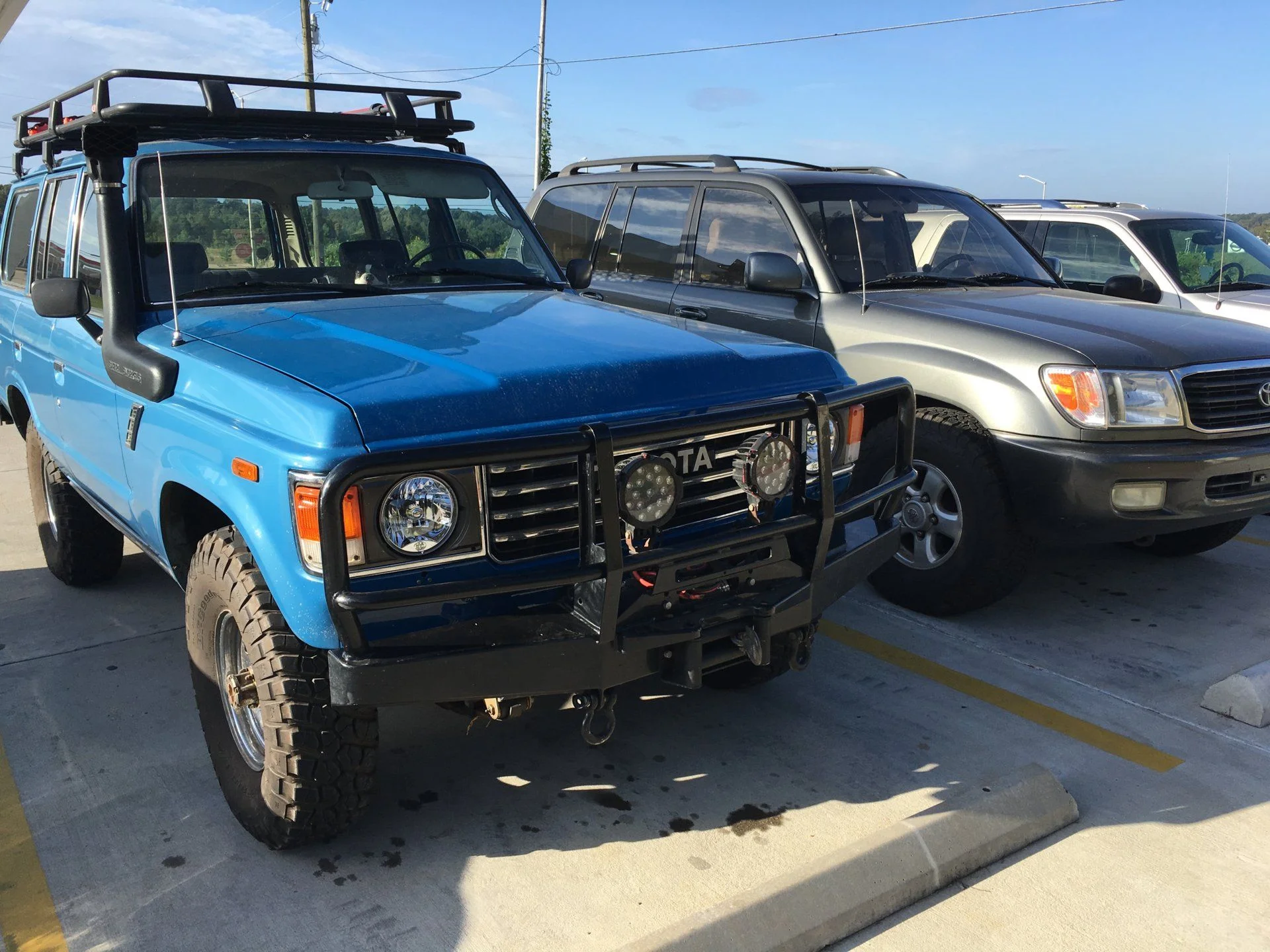

Nolan.... so what all do you have added to your truck...
Looks like the following...
- couple inch lift
- 33s (and MTs at that)
- ARB front bumper
- ARB roof rack with lots of tools
Any other accessories... Just wondering how much that might affect the TBI vs. a stock-ish truck. This is the over analytical part of me that likes to know the details for further understanding and known variables.
ARB, 9000# winch, bumper, high lift. Very few tools. Roof rack is aluminum.
3.70 gears and 33’s.
2500 RPM at 55 indicated 63-4 actual.
Stock it will be crazy. Enjoy.
But just realized we need to give you a handicap... you're runnin taller gears than the fj55 guys...:lol:

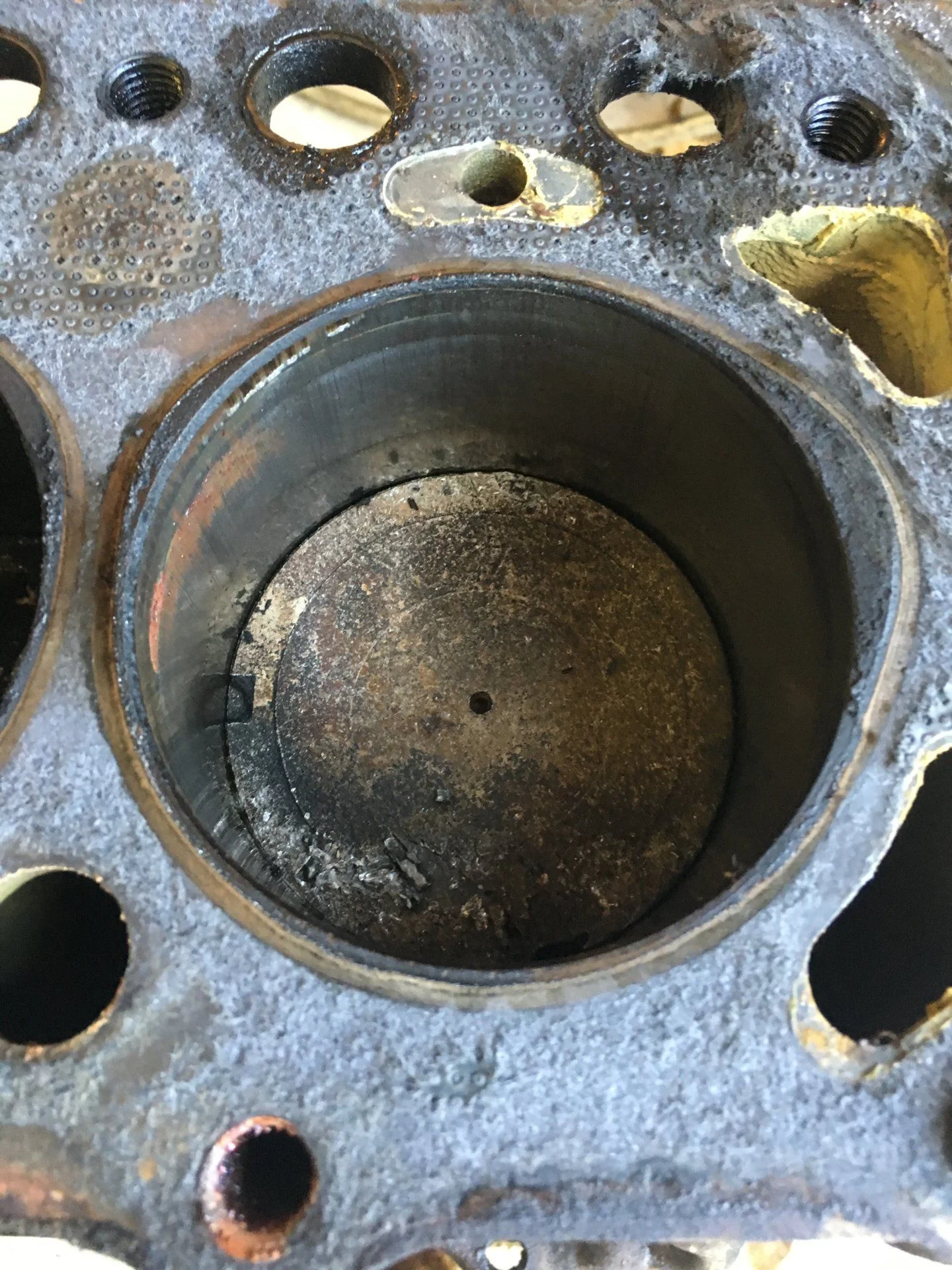

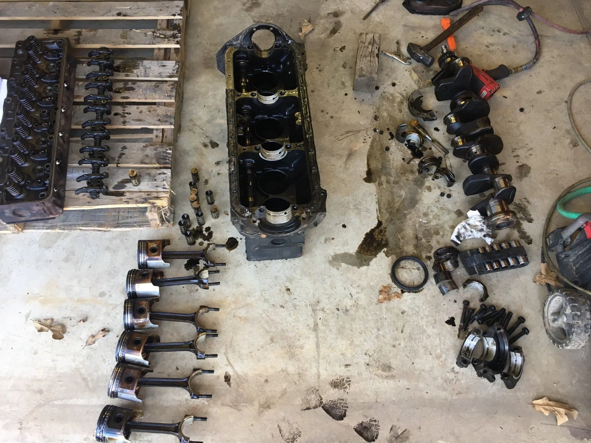

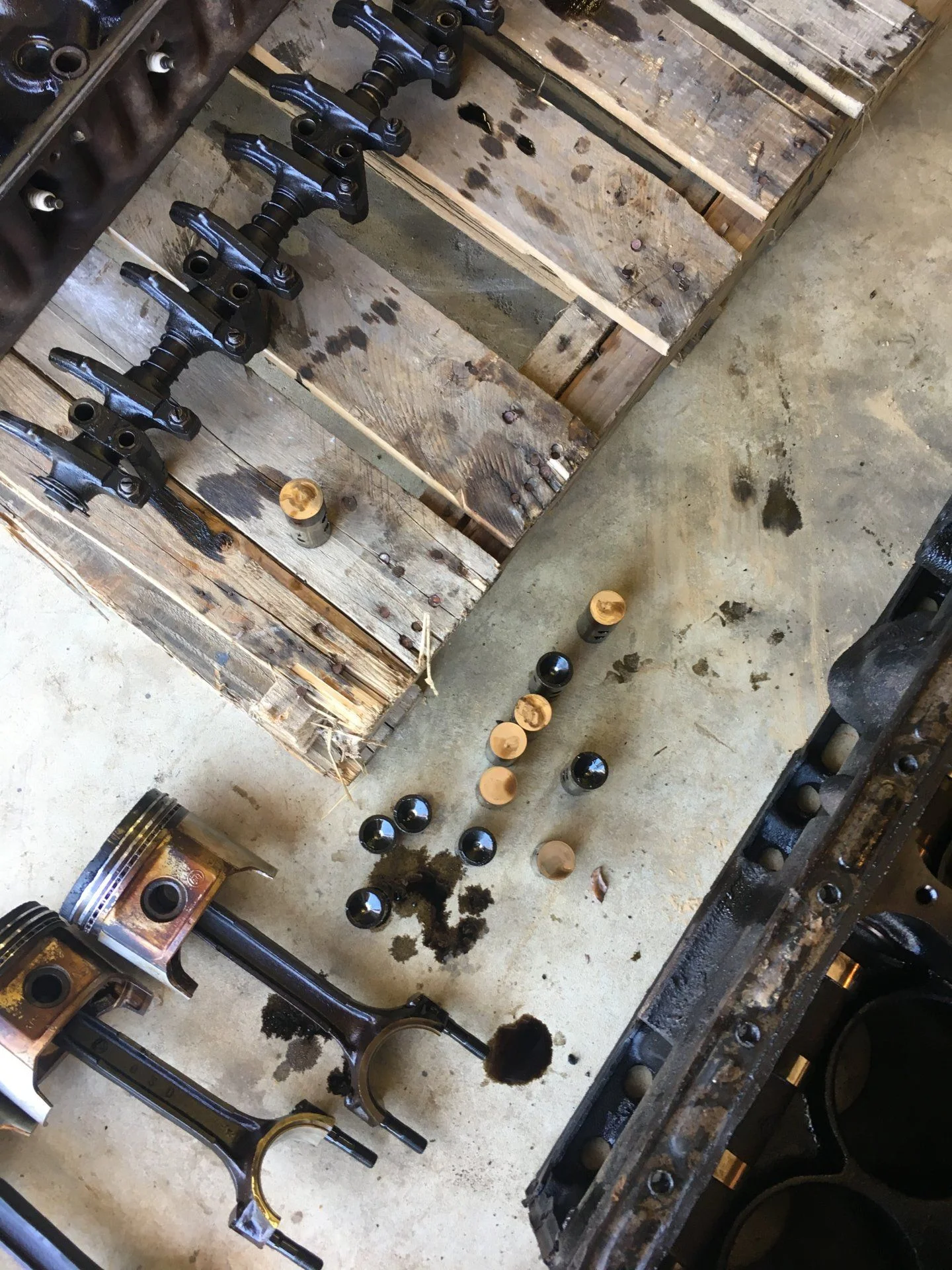

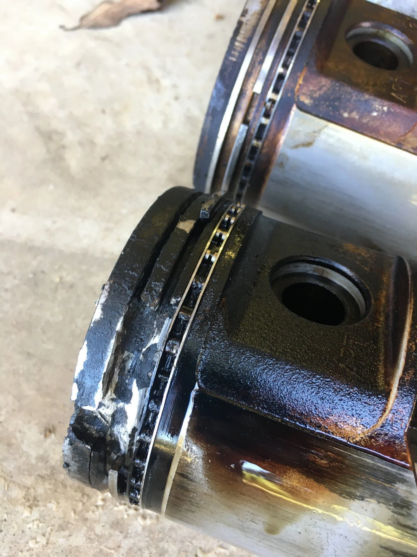

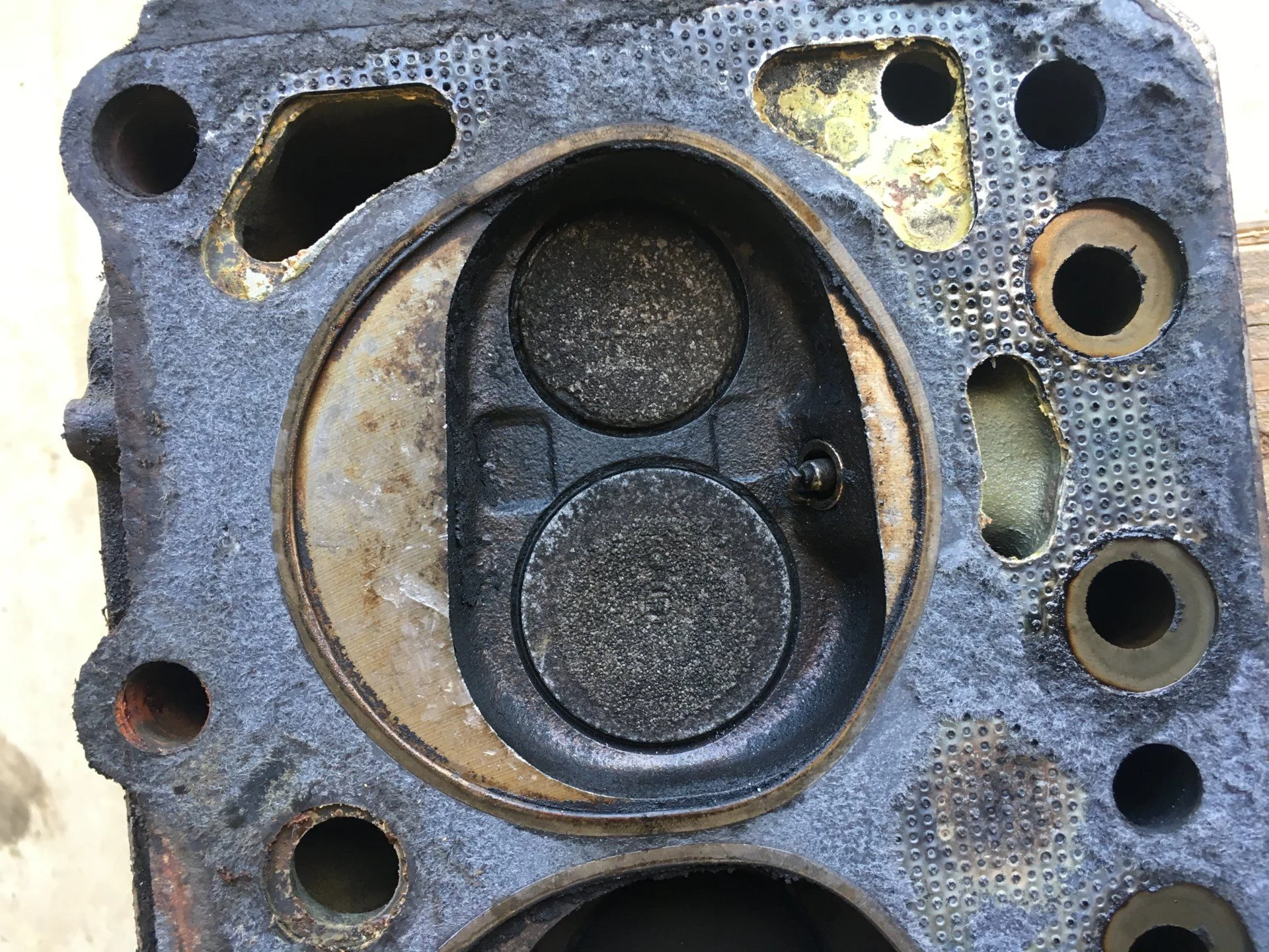

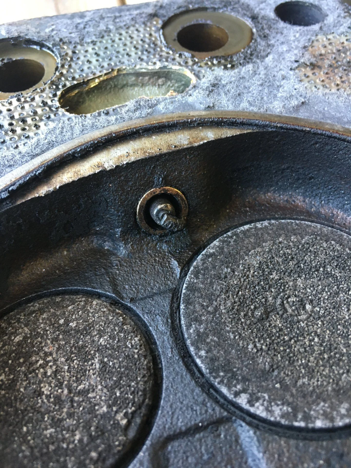

I did an autopsy on my old motor because @FJ60Cam needs some parts for a 81 FJ40 with a burned valve.
#6 has had bad compression. Broken ring. I’m not sure how it was running with all the crap in the combustion chamber.
Busted ring
I went ahead and pulled it all apart. Maybe someone will need some of this junk one day. For now the cam shaft will be nice garage art

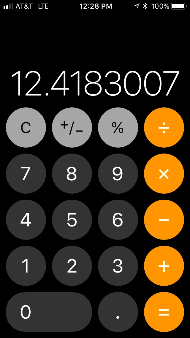

This is the only thing that I was not expecting. I actually lost 1mpg from my Smokey ass 5 cylinder
(Yes I added 10% to miles)
12.4? That seems fairly low. Gas mileage depends a lot on how the tune/chip is set up though. If you are happy with how it runs I think that's more important than fuel mileage. I have messed with tuning chips and trying different settings a fair amount. Hopefully your o2 sensor is in a location where it can get hot enough to give a accurate reading, I went to a heated o2 sensor to ensure that. It's really tough to tell how well a tbi setup is actually running, at least i think so. Eventually, I bought a wideband afr gauge kit as they have really come down in price. Watching the air fuel ratio live has been great for telling me how it's running. Typically a tuner will set a throttle percentage at which the EFI will go to open loop and run a richer mixture than the closed loop mix of 14.7:1 for more power. This is called power Enrichment mode. If during your trip you are in pe mode most of the time then mileage will suffer. If that throttle percentage for pe mode is set to 90% throttle position, you'll get great mileage (unless you are flooring it the whole way)but lose a bit of power. If it's set to 50%, then you will spend a lot of time in pe mode and have poor mileage but a little more power.
Awesome work!
Is the 10% based on just the speedo? I found that in my '62 with 33's the ODO is off 17% and the speedo is only off 5% based on GPS. If yours is not quite synchronized as mine is you could be north of 13 ;).
I’ll check. It is splitting hairs though. It’s a pig.

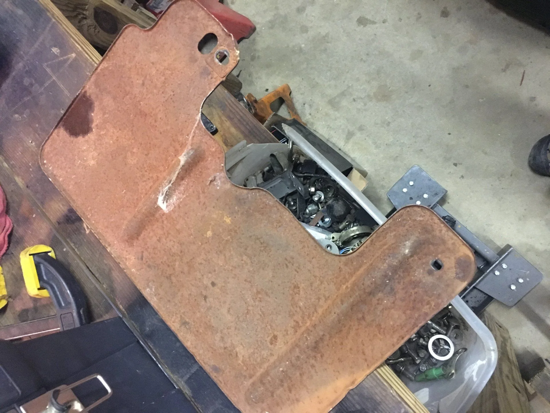

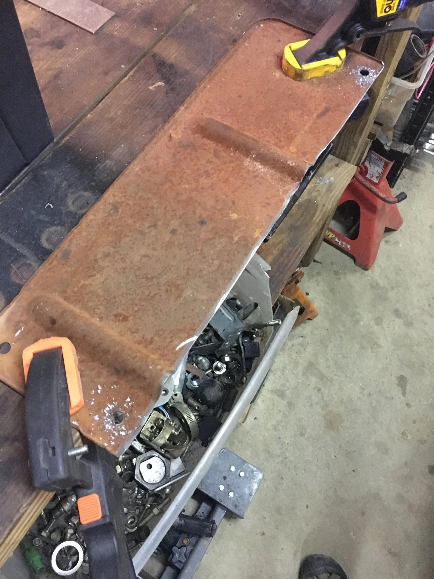

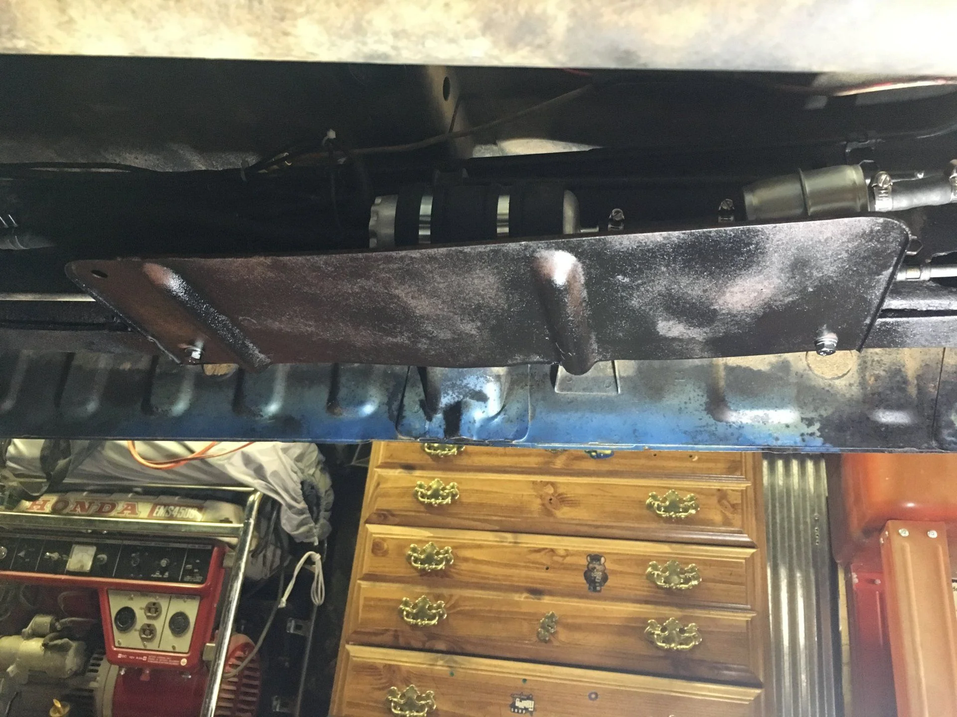

I could not stand the fuel pump being exposed so I took some 6mm rivnuts and a splash guard from a 40 and made a skid.
