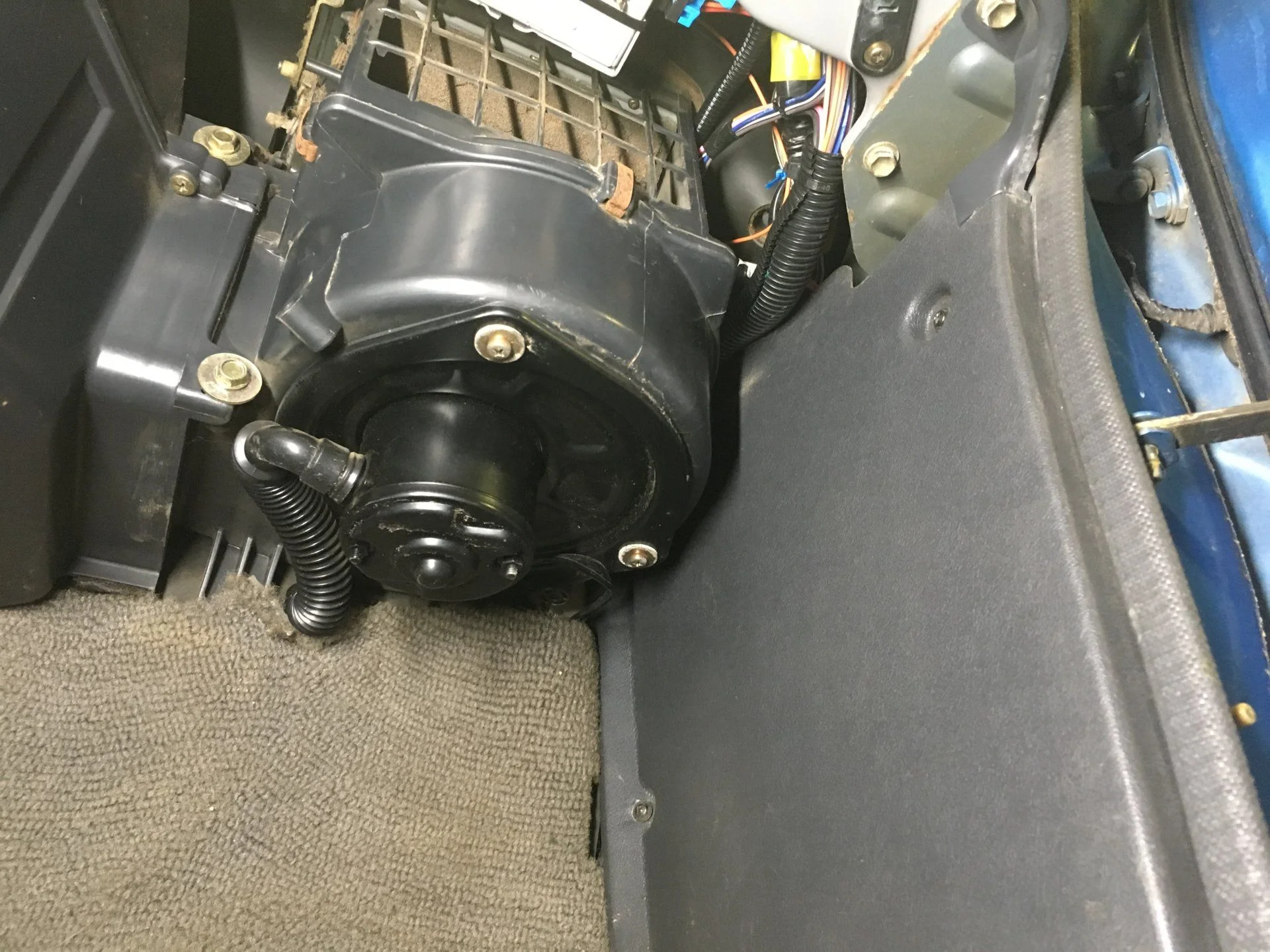

This is where the computer is going.
Did you know the 60 glove box is made of paper? WTF?
yes...
did that ecu not fit below the glove box ala fj62?
I have used several fj60 firewall grommets on various things...you can totally cut a slot in it, add holes and glue it back together with sika or equal poly sealer. I even found one they called black that is a close match to faded rubber when it cures...PHL or ??? brand found at HD and LOWES...HTH. good work, team. time to break for real work for a few days. that's why God made next weekend...
I hope not, ‘cause I didn’t really check :grinpimp:
I just wanted it invisible (unless you open the glove box), and I’d done it this way before.
Makes for a stealthy install if you start looking around. No dangling wires or computer. The relays fit behind the kick panel. It’s all concealed.
Lots of interesting conversations when you do a major conversion like this.

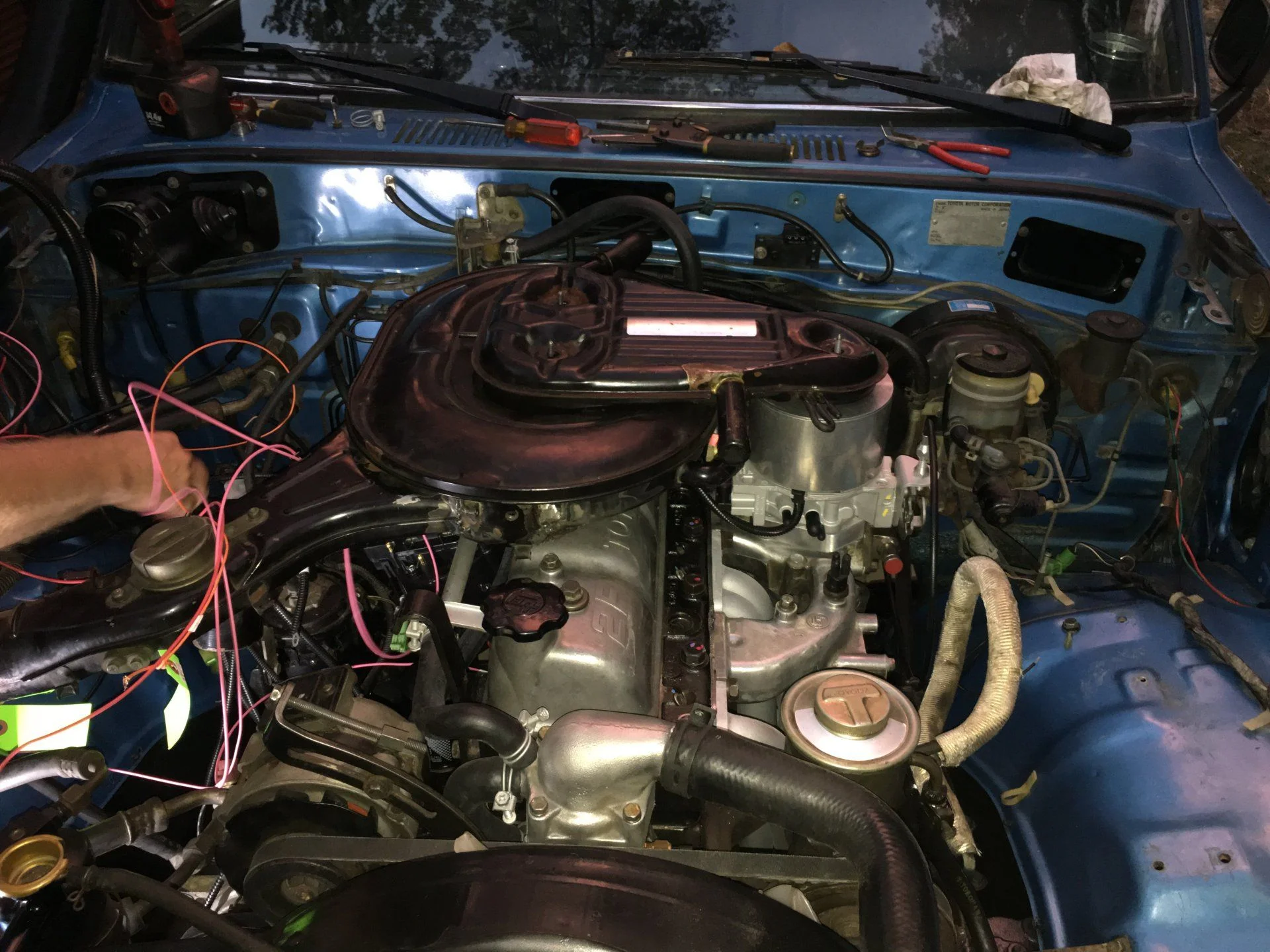

Should I remove the choke Cable?
Well yes. You won’t ever need it again.
What is this sensor?
I don’t know. Pull it off and toss it.
I wonder if I should just cut this plug off?
Will you ever need it again?
On and on.
Feels weird cutting out and removing things that I have been so proud of that are still on the truck and functioning.
Oh well. That’s the way it goes.

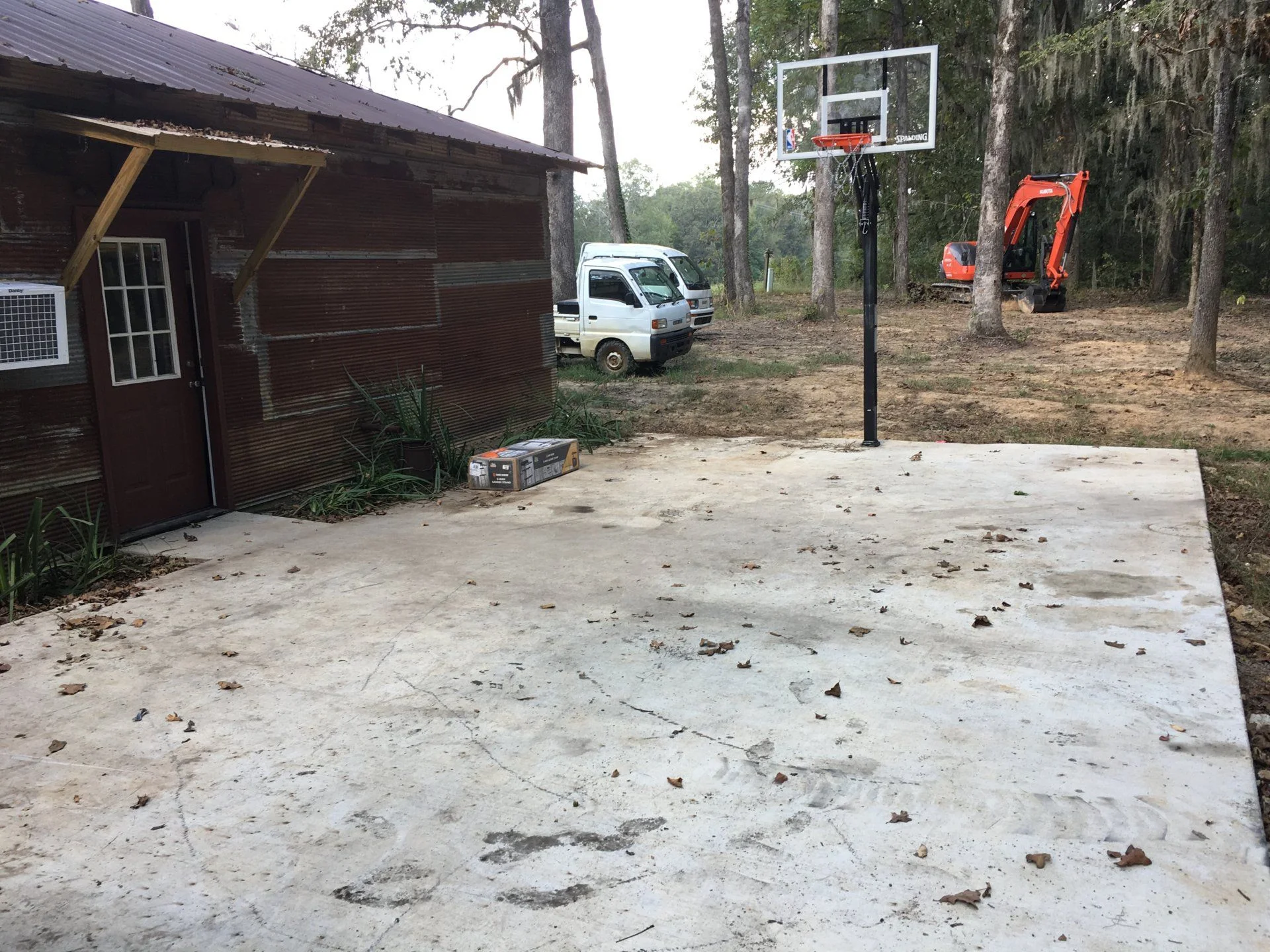

You could lay down hardwood floors and have an indoor B-ball court/vehicle lift.
Brilliant.

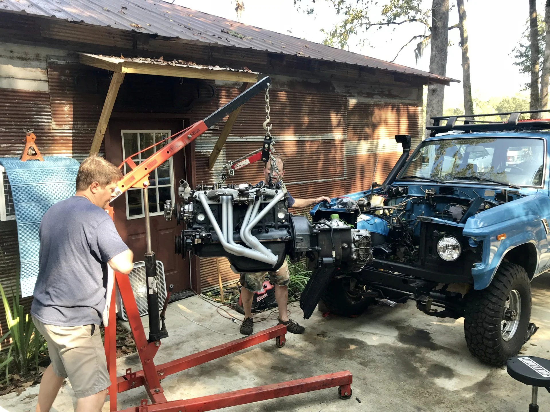

On a nastier note after hauling off the old motor, box, hoist, 100 beer bottles, Camp kitchen, party tent I finally decided to look at the 60.
I decided to start easy and changed the fluids in the Tranny/Tcase.

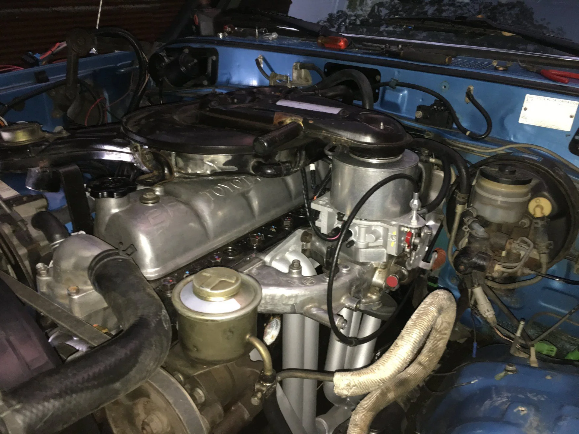

A local guy I barely know but have been in close contact with during the build has offered up his AFI throttle body to me until they fix mine and return it. He bought a kit when I did and is waiting on the local machine shop to finish his motor. Thank you @maxbob002

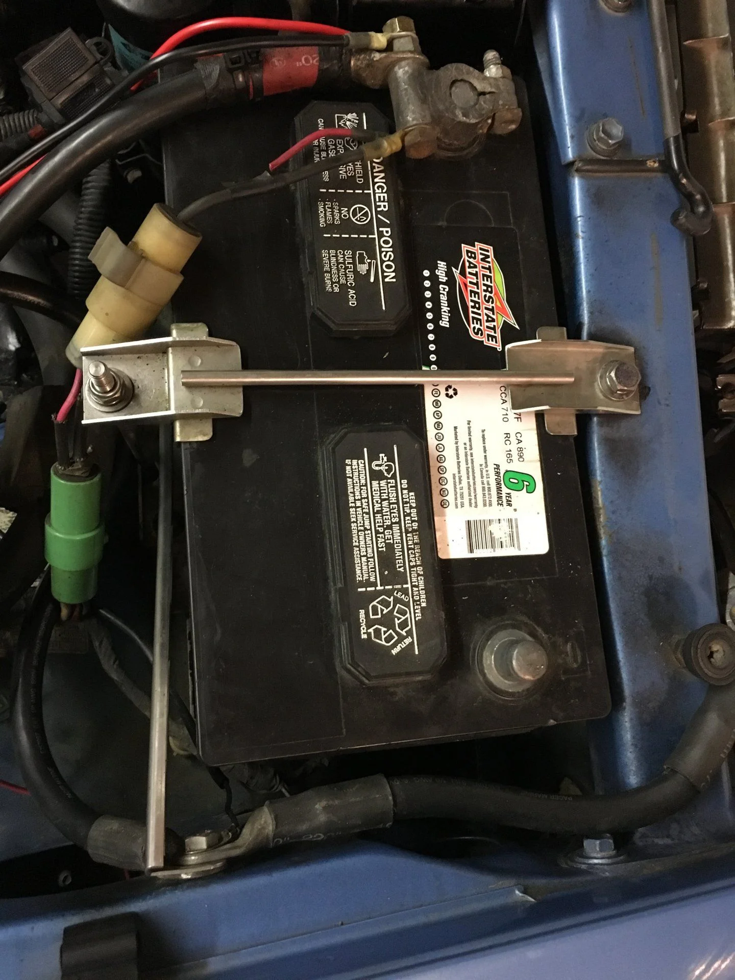

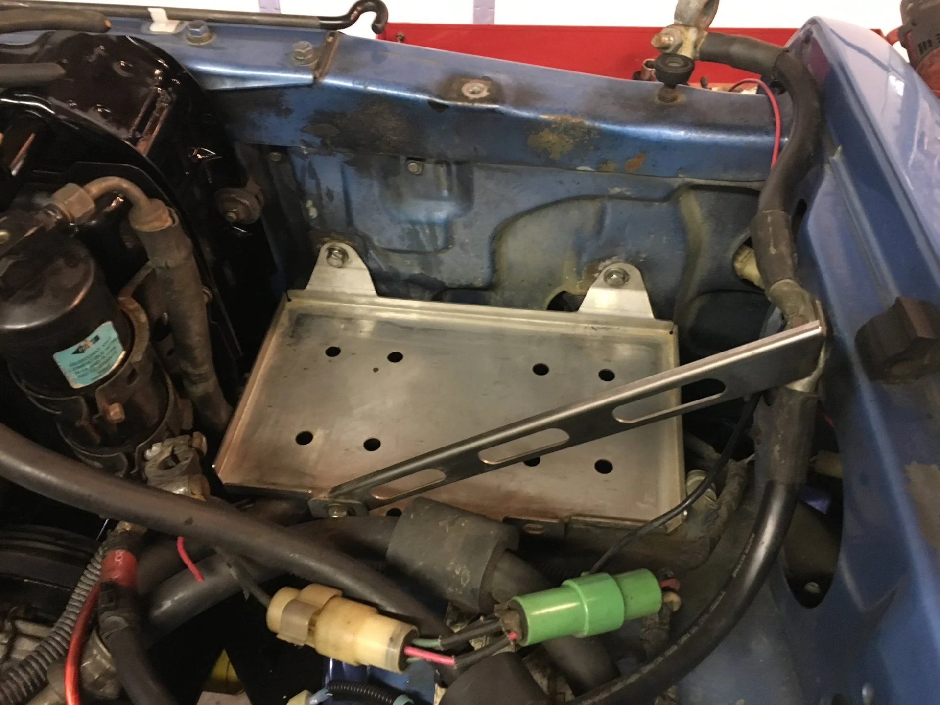

I’m not sure if Dearborn is still alive but his Stainless tray and
Battery wire kit was/is a work of art
Battery is back in. That is a heavy bastert

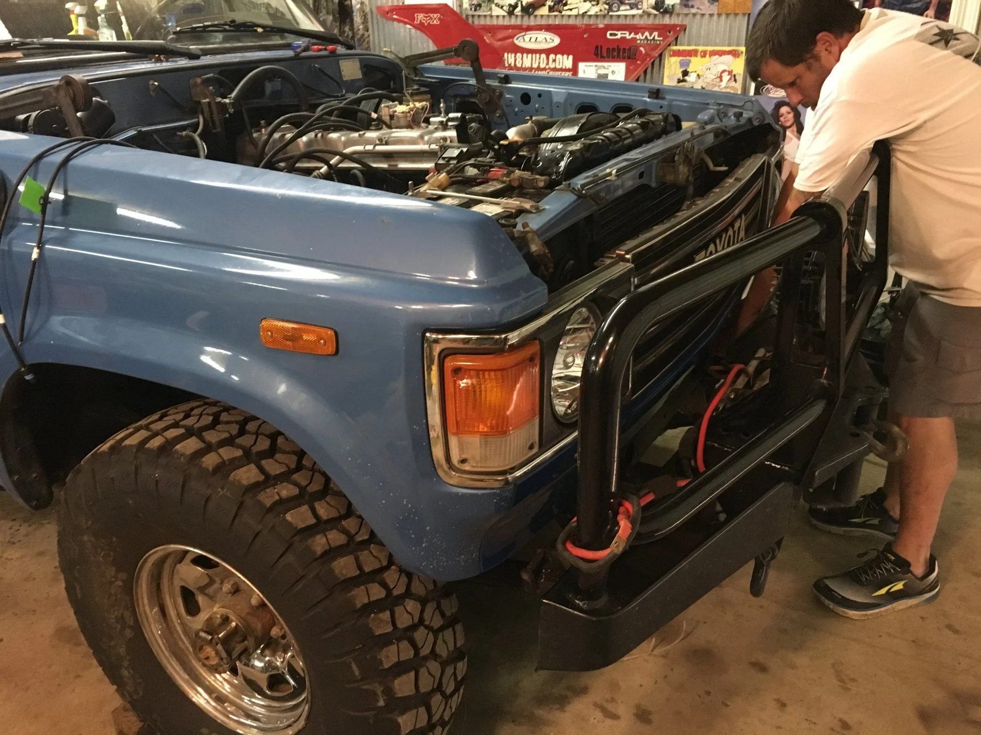

@under_psi drove up and polished on the Air Cleaner turd I made and helped me lift the bumper back on.
