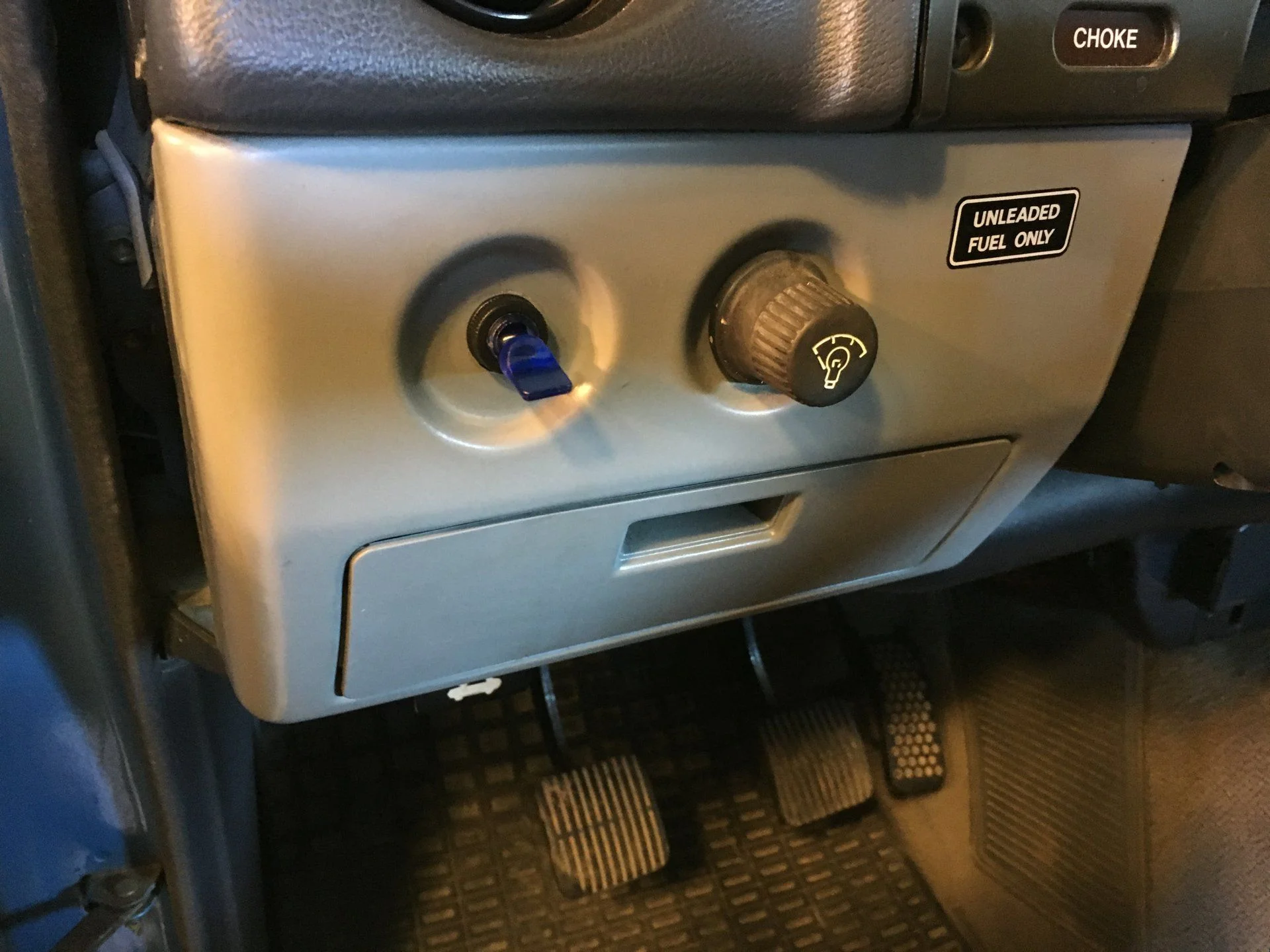

Thanks for the heads up on the speedo Cable. I unhooked it and shoved some slack into the cluster and it slid right out.
I stuck the Check Engine Light wire into the yellow wire vacated when I removed the choke cable.
This allows me to use the choke light for Check Engine. Clean. Thanks for the tip @FJ60Cam
