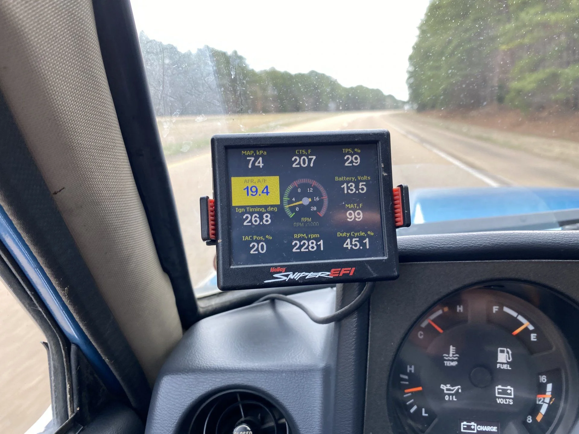

Made it back in one piece. 1000 miles round trip. My exhaust gasket came off again. I think the bolts are shot. Two of the nuts were missing. It happened just as I left Mosley Motors but I said screw it and put my Bose headphones on and hit the interstate.
About an hour out my AFR started going nuts if I gave it fuel. I figured it was mad at me for having a uncapped header 2” from the O2 sensor. I’ll post some videos.
After I put some bolts in it ran perfect for :30 then started again. It’s a sputter at cruise. It had enough to get me home and once I hit the 2 lane it would not do it again.
I’ll replace the gasket and the O2 sensor and see if that’s the problem. Fuel delivery was good. No issues on this trip other than that on the last 70 miles.
I had same AFR A/F readings similar to your setup. My exhaust system is intact with no known leaks. Suspected O2 sensor. Instead of replacing the O2 sensor as I had already done once before, I pulled and soaked the sensor end in gasoline overnight. Cleaned with rag and reinstalled. Has been working great sense. Still have backup in glove box.
I put a good gasket in the exhaust yesterday and a new O2 and put 70 miles on it today with no issue. Pretty sure it was just pissed about the open exhaust. Makes sense really being so close to the O2.

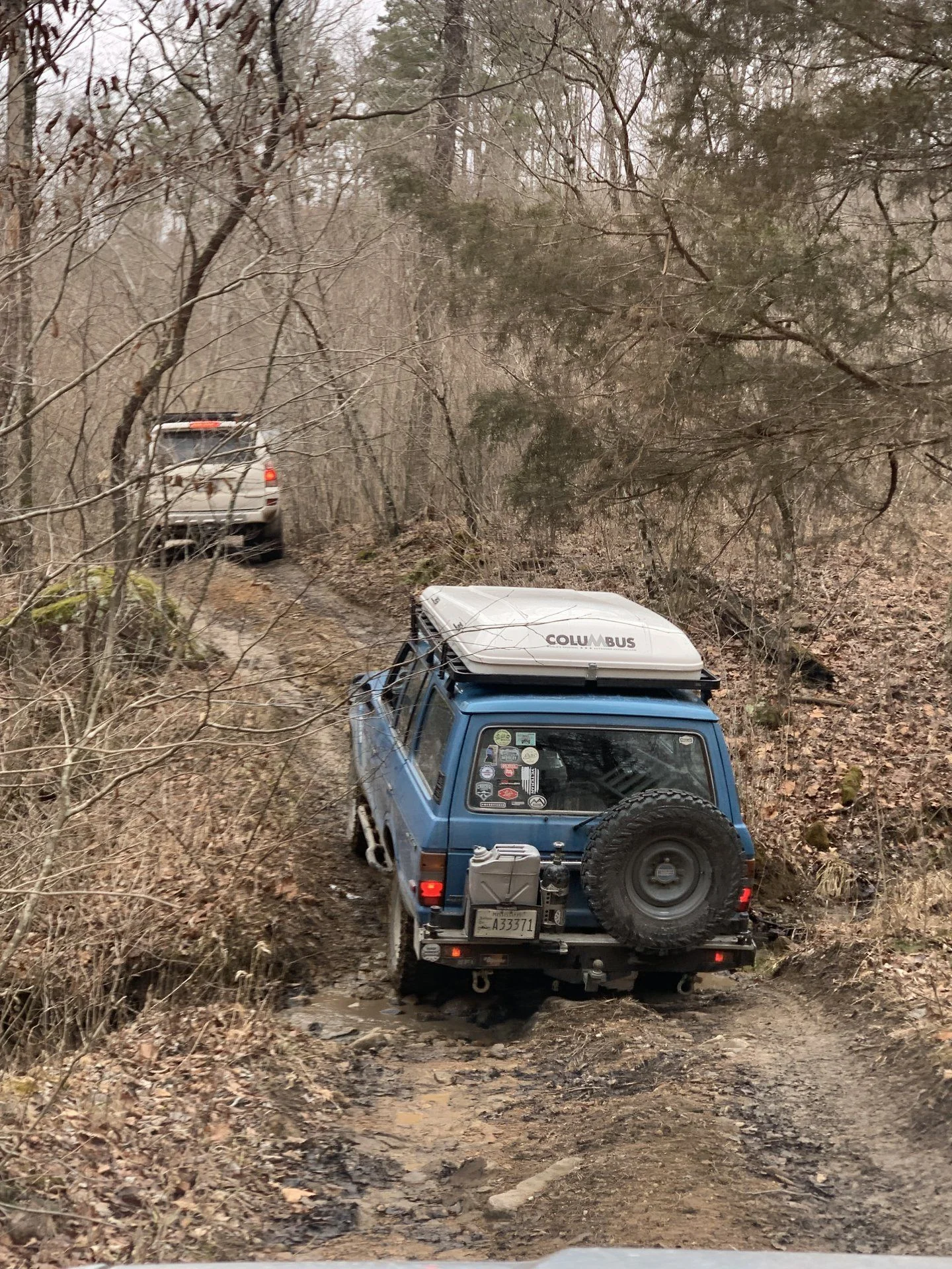

The rear bumper is Kaymar.

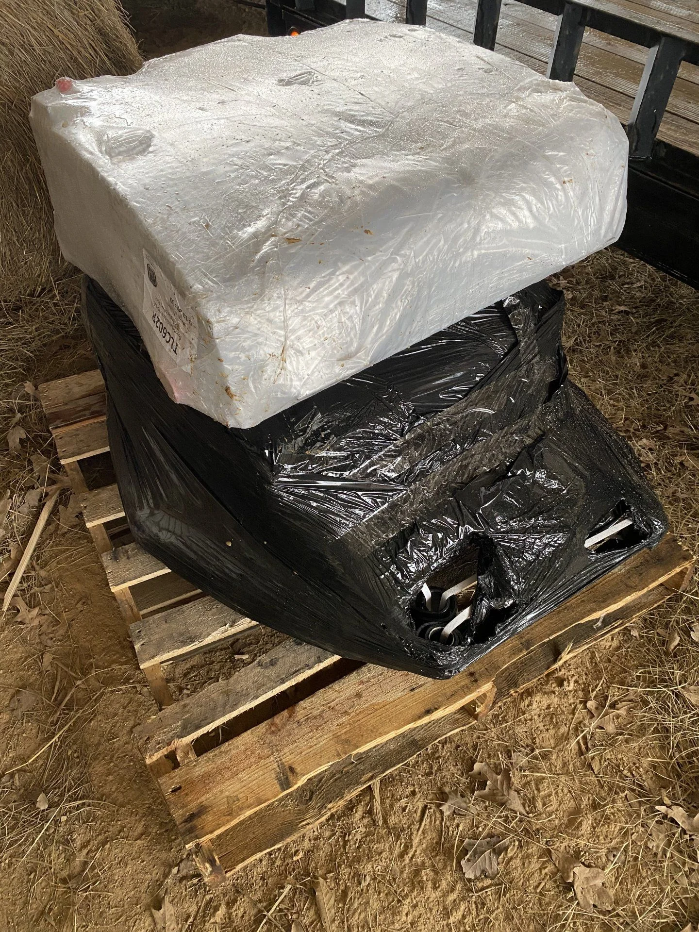

Thanks for following! The long promised upgrades will be coming soon. I lost My window to work on my own junk when the pallet was delayed a week.

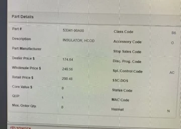

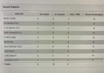

Interested to find out as well, I thought it was discontinued?
Looks like it's still available at Toyota... I also thought it was NLA. Price seems ok also...
I'm debating installing this with or without some additional heat shield?? before I get my rig repainted. My hood has terrible paint peeling, (but I think it might be due to the cheap-ass s***ty spray-over job the PO did before selling years back)..
I had no problem getting the hood insulator, I was curious about the hood seal to radiator support. I think the part number is 53381-90A00-U?

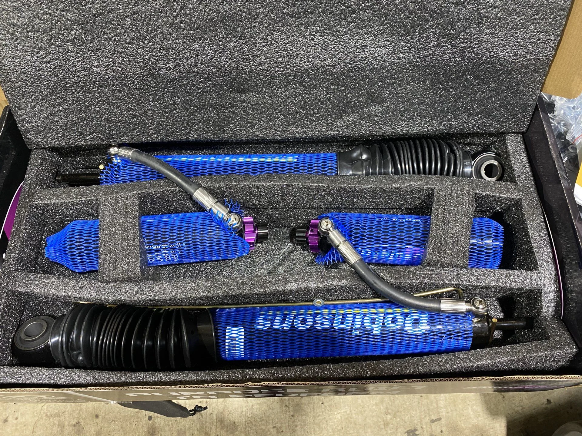

Dobinsons Uograde

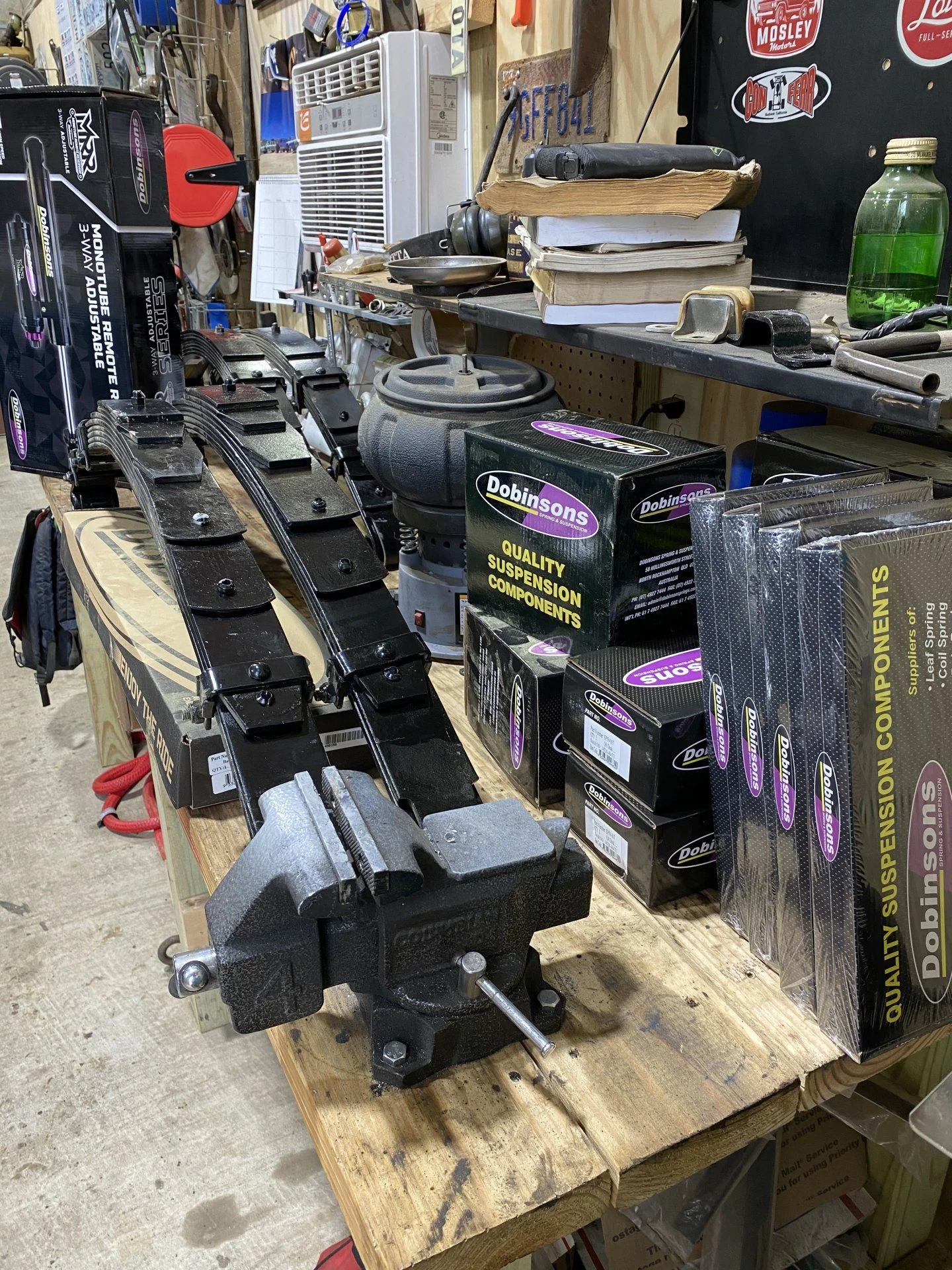

After 12 years with the OME springs and 2 years with the Ironman Foamcell Pro I decided to swap in a Dobinsons lift with the full adjustable MR shocks.
Today I collected parts and prepped the front for the springs and shocks.
