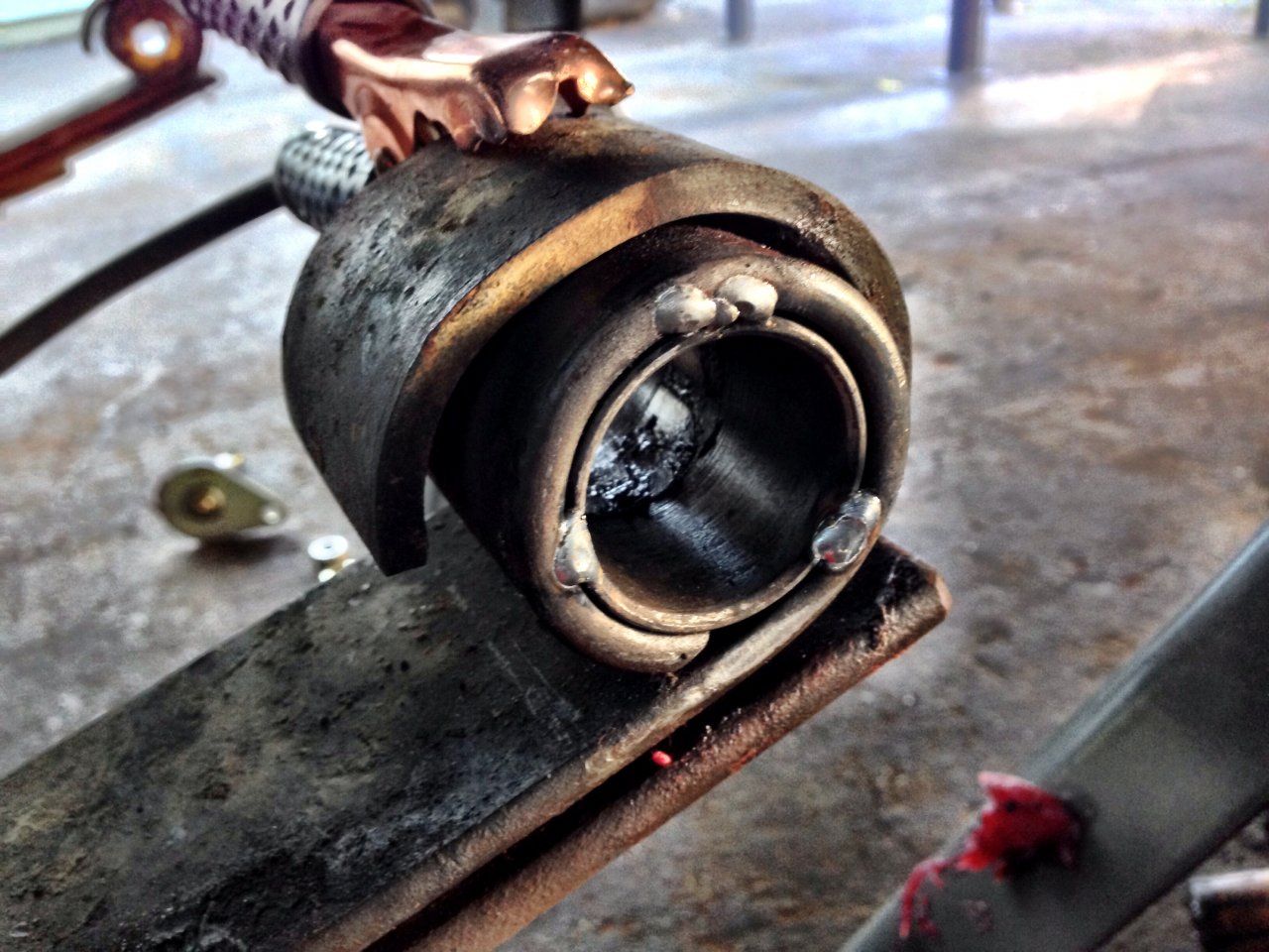

Stake or weld the sleeves. This has been an issue since OME ghanged their designs to the Dakar spring when they moved production from Australia to distant lands
I would NOT weld anything to a leaf spring, you will change the tensile strength of the metal and cause your leaf spring to crack and then break. I am talking with experience. Try to eliminate that sleeve and go with OEM bushings.

i just did a tack weld right at the end of the curl. it's enough to keep the sleeve in place but doesn't affect the spring metal in any way except possibly the last 5mm which i figured doesn't offer much strength or flex anyway. much quieter though not perfect since that's been done.
