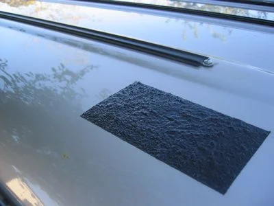

Here's my fix, which was based on most nutserts being shot or threatening to fail and a litle surface rust. Ugly but cheap, and fun to take a Dremel to a Lexus :D . Had I had more time I was going to stencil my son's footprint a la "Hang Ten" and use it for the pattern. I think TYLER first suggested a custom creative stencil. I pinched the rosette washer idea from CruiserDan, I think.
What you see is an approx. 3"x5" patch of Herculiner, brushed over the footprint (read "scar") of the roofrack after I removed the nutserts, dremeled smooth the nutsert holes and covered them with a few layers of metal tape.
I knew I was never putting a rack back on using the nutserts, so I abandoned them. You can also see one of the nutserts at the end of a rib-rail, which was not rusty and thus I have only sealed it with silicone and inserted a rubber lined rosette washer and a marine grade stainless steel screw.

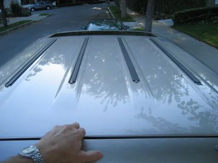

Here's the best picture I could find. The LX is in California, and I'm in QLD, so I can't take any more until summer. I left the ribs on the roof for protection, and also because I ran out of time before getting around to peeling them off.
You can barely see the four patches and you can see one of the rib-rail nutserts that had to be patched as well.

I was me yes .. ;) I think keeping the protection on is a good idea. Perhaps you can remove when you have the time and go with the spray there as well. I'd hate to see that foam start holding moisture and causing rust to appear.
