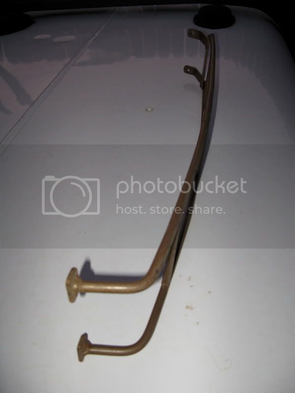

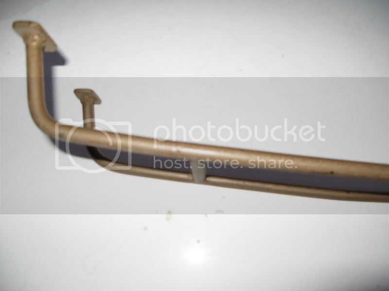

As promised,
Here are some pics of the brace that came with my HJ45 from Oz (Can you see why I thought it was for mail?).
The main bars are spaced about 5" apart. The bolt holes attach at the front and the rear is held in by the shape and pressure.
Let me know if you need any other pictures. I hope your finger/thumb gets better. Ouch.
