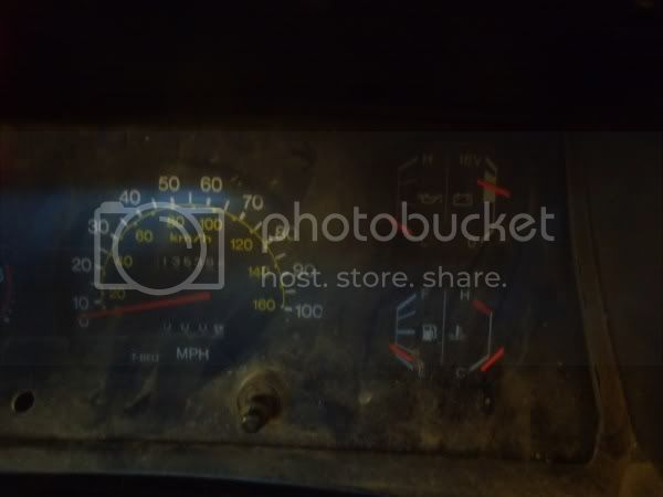

Im not familiar with that kind of dash,do you have a pic?
All the 7* series from 84- that I have seen have a oil pressure gauge and an oil level light.
You can see the oil pressure gauge in this pic in the top left on the right hand side of the dash
that is the basic dash in the pic, they come in some of the pickups and some of the rag tops. very few gauges with idiot lights and no tach.
a poor mans dash. i have the same here in the white ragtop:

LOL thanks for that,I never guessed they existed. You dont even need your reading goggles to look at that.
Is that an oil level or pressure idiot light on the left?Does it have a light for each?
It wouldnt be bad having one of them with aftermarket gauges for rpm and others.

RoscoFJ73.........Why is your speedometer in MPH? :)
Although my dash cluster looks just like yours, I don't have a "oil pressure" light.
Thats not mine,its one I found on Google. I have an oil level light,comes on when you have low oil or your mechanic breaks the filament and doesnt tell you (fixed it with a used one I had on a spare engine and saved me a lot $$$$)
