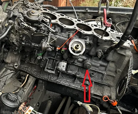

i have a 1992 1HD-T and i would like to add an oilpressure sensor. where is the smartest place to do that?
found some info on google and found this to be an option:

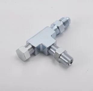

and put on T - anyone know what thread is used on the OEM sensor?
is it the best way to do it or do any of you guys have another recemendation?
I have a 1HZ and that's what I did. I have an oil pressure sender and pressure switch hanging off a tee at that location. Just make sure you use a thread sealer to prevent leaks. Thread on the block is 1/8 BSP I believe.
