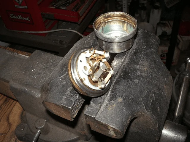

It does sound as if the sender contacts are stuck closed.
and after installing the new sender, make sure you connect the wire to the center lug, not the spade terminal, if you use the spade terminal you'll be replacing your gauge next.
