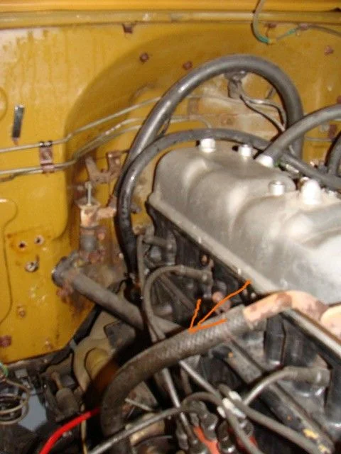

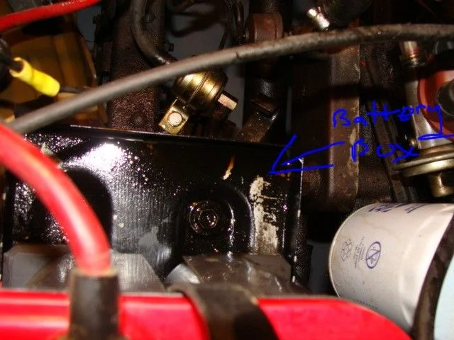

Looking for ideas on where this darn oil is coming from and hope some of you might have some ideas. After riding today I found oil on my garage floor. I lifted the hood and inspected the pcv valve. It seems secure on the grommet and you can blow air through the pcv.
There oil on the inside of the hood, the back of the firewall, inside the battery box and oil has leaked onto the leaf srpings. The valve cover gasket seems well sealed. There is no oil on the drivers side of the engine compartment.
