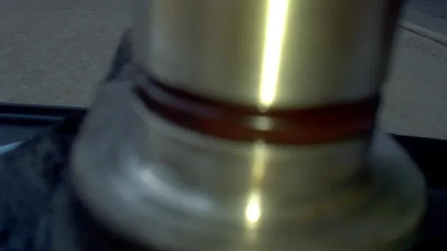

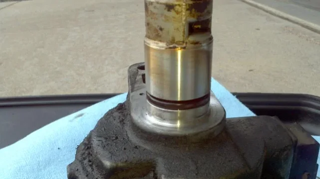

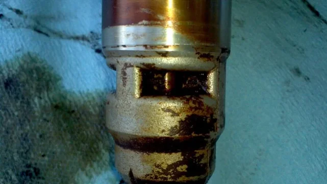

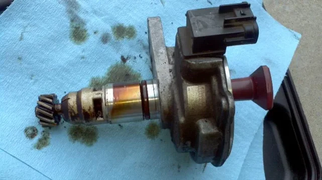

So i finally found time to take the distributor out and this is what I came up with. Not sure what to do at this point?
