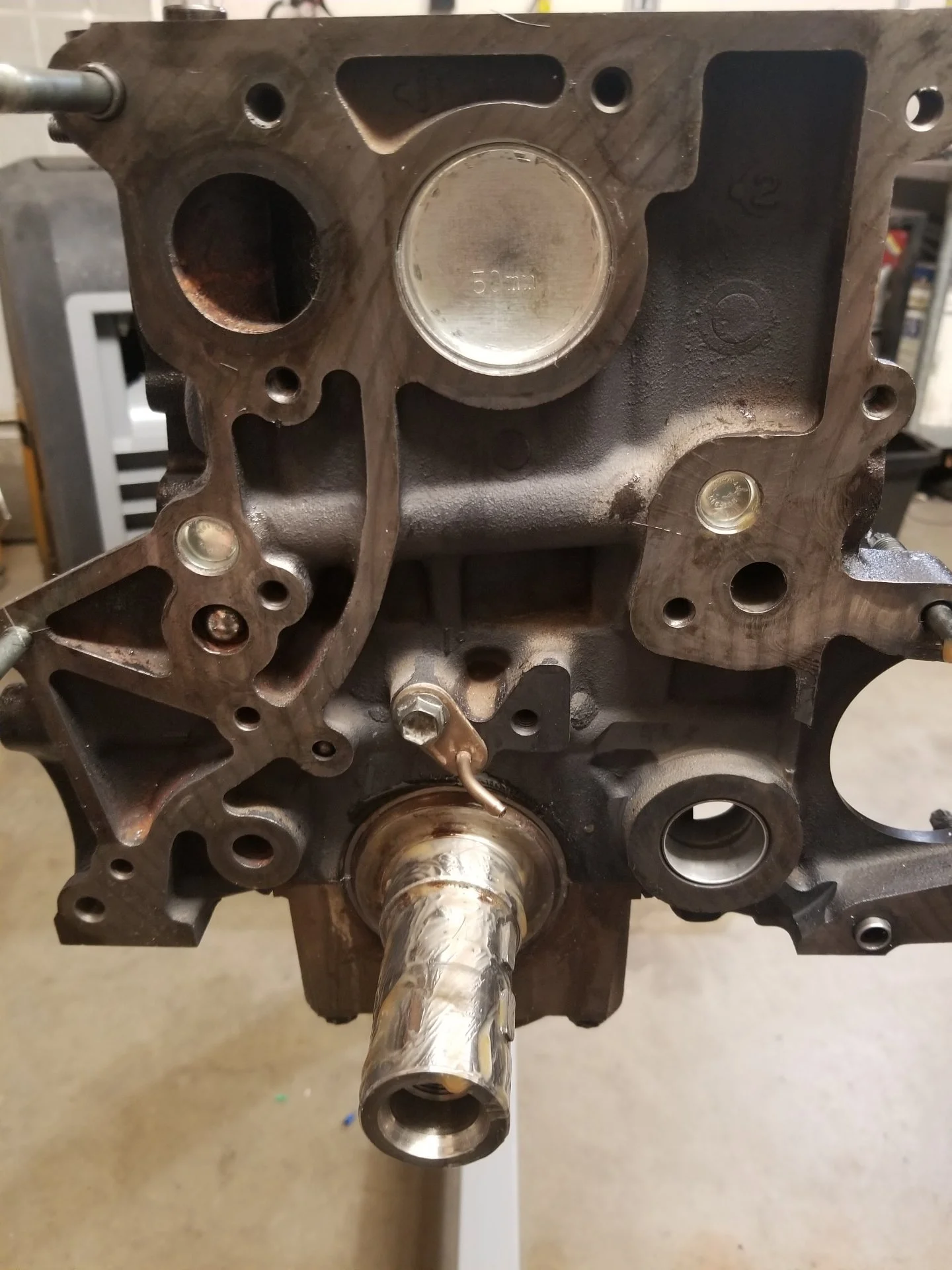

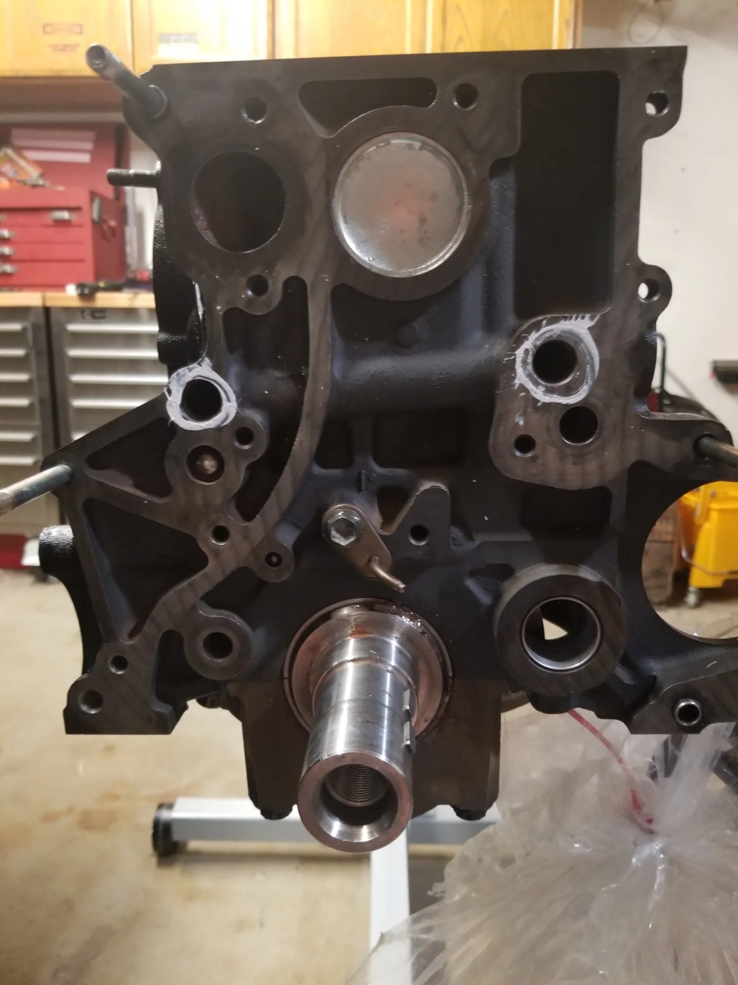

Need help finding either a Toyota PN or aftermarket supplier for the two oil galley plugs behind the timing cover. Any help is appreciated.

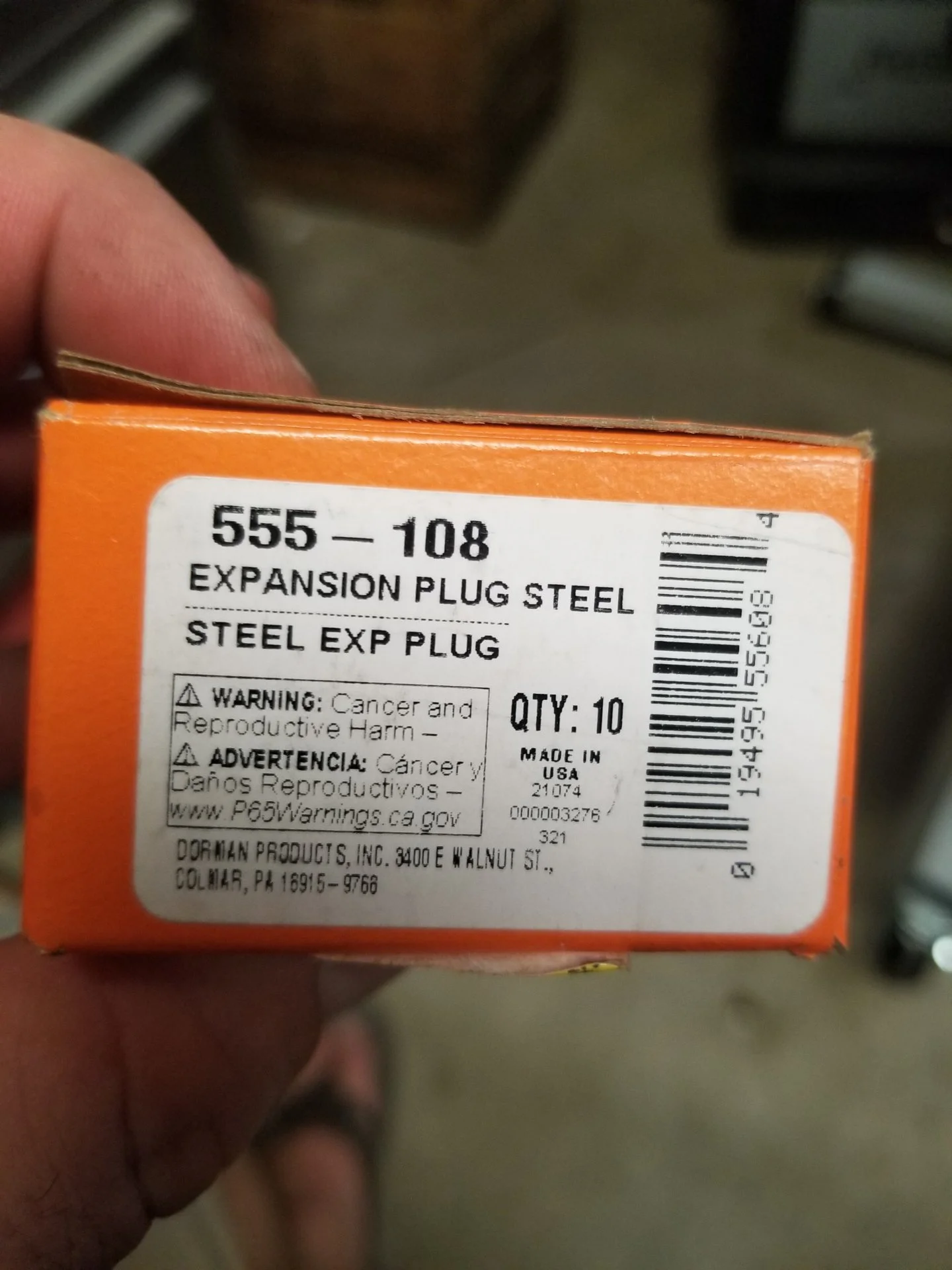

Found the part for the expansion plug. 555-108 Dorman 16.2mm. It will show as a 5/8" plug everywhere but the Dorman catalog shows it as 16.2.
