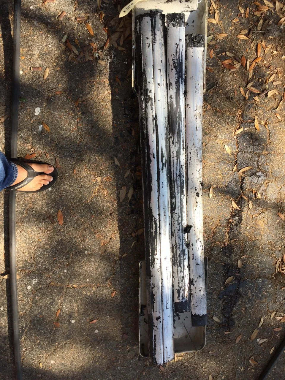

After reading a post on roof rack removal it turned out to be pretty easy to get it off. After I removed the rack and then disassembled the rails I began to strip the paint. 14 years of sun had taken a toll on the original factory paint and the cross bars had hardly any paint remaining in the top side of them. I spent nearly four hours stripping and sanding each of the four bars until all that was left was nice clean aluminum. I brought the four bars to a local powder coat place - Powder By Design, and for $85 he did all four bars in satin black. The black actually matches exactly with the door sills. I think it turned out great.
Here's a pic of of my halfway point of stripping off paint.

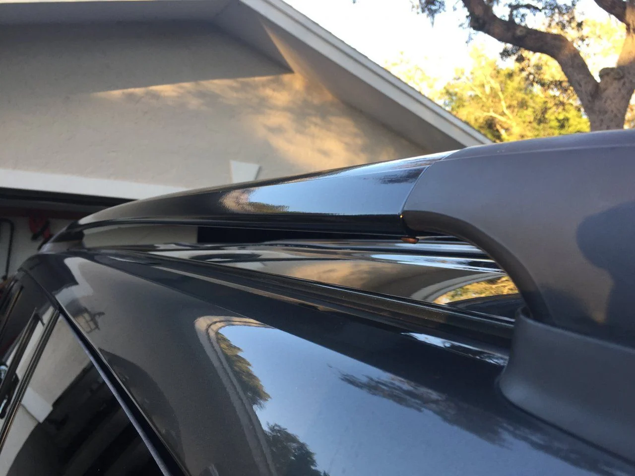

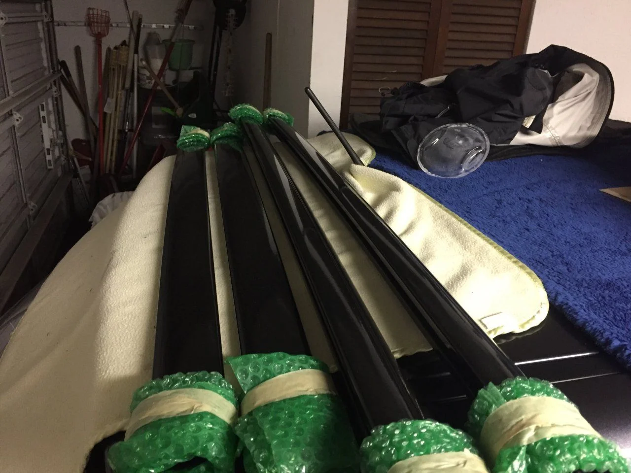

Back from powder coat shop

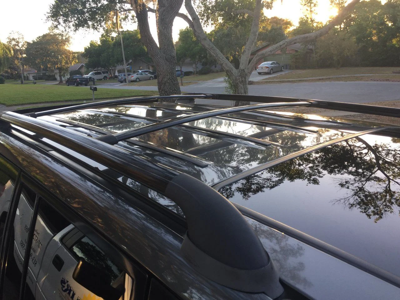

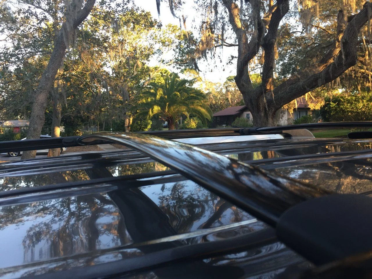

Installed
