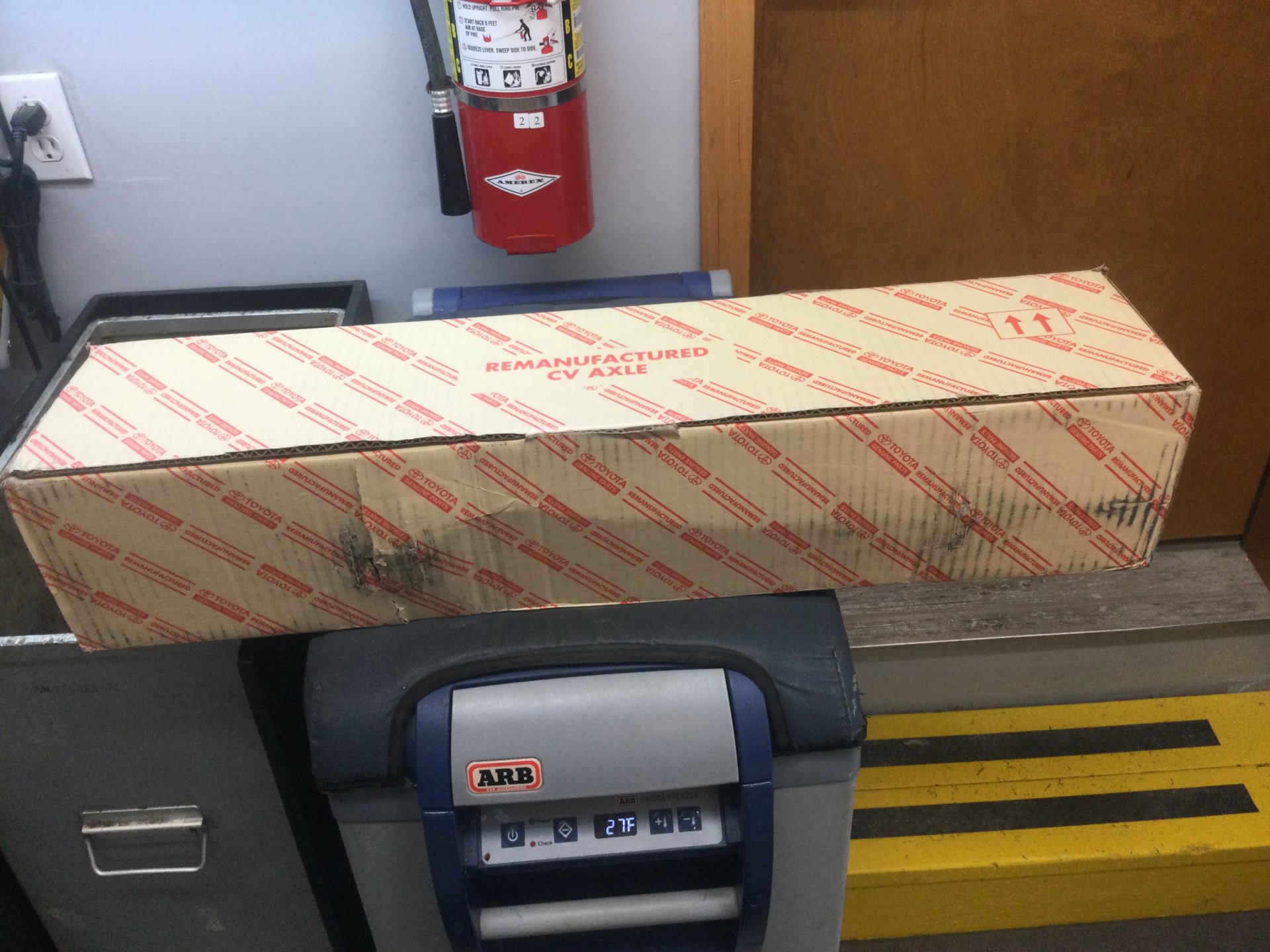

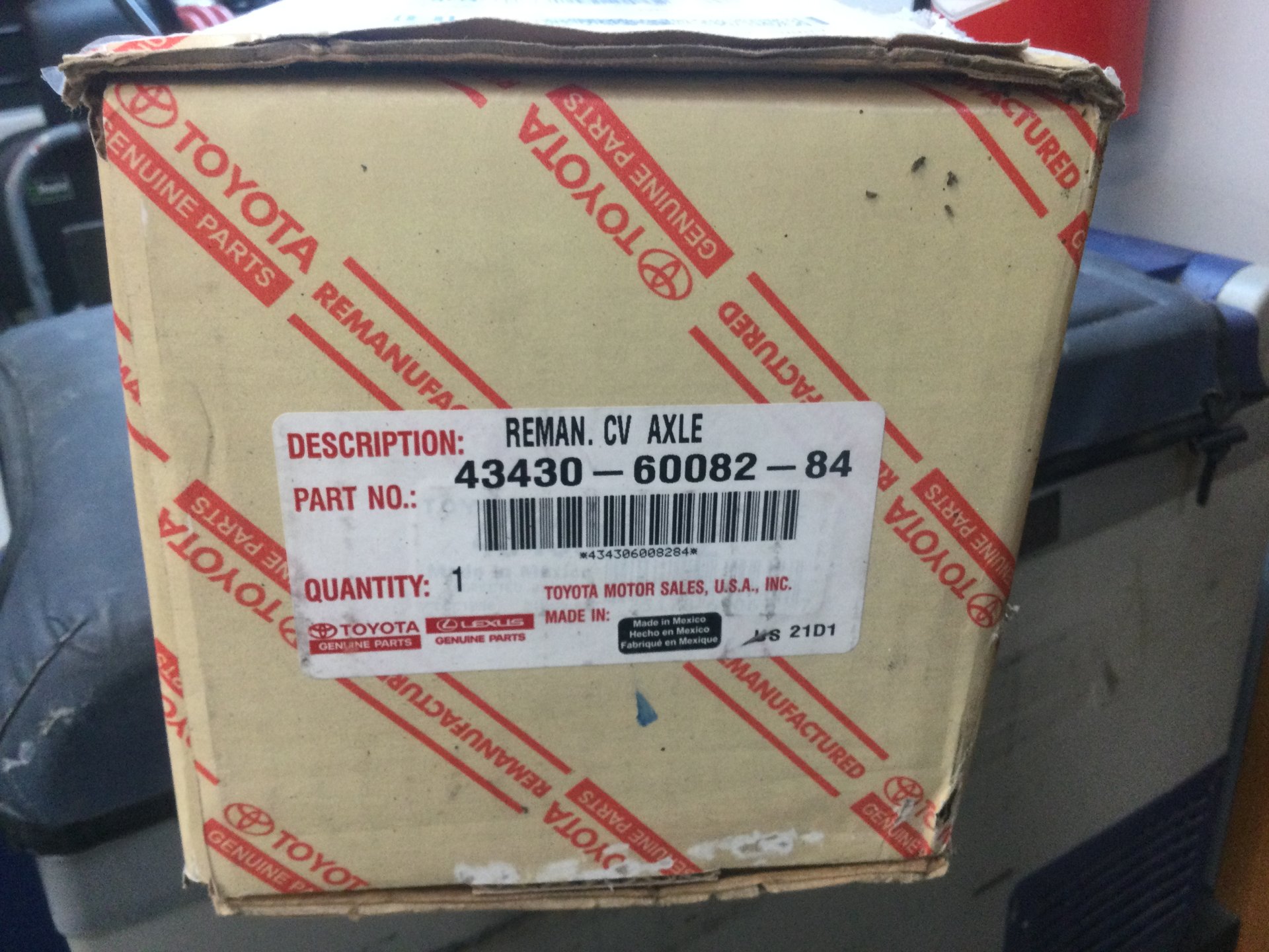

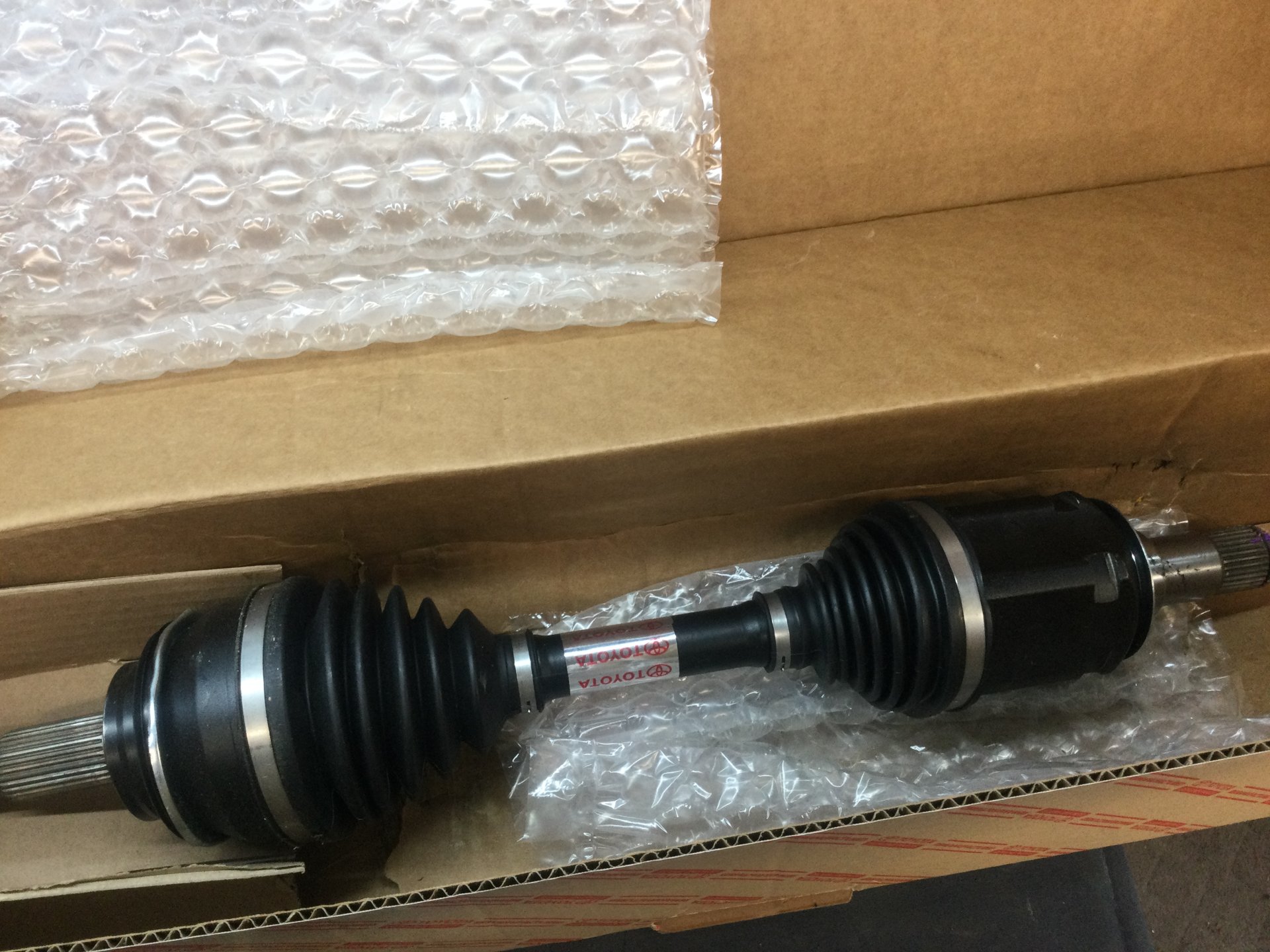

Thanks for the pictures @Washingtontaco . I'm pretty sure these -84 PN reman axles came out not long ago. After some searching, it looks like Lexus and Toyota started requiring cores to be returned when purchasing brand new cv axles recently. This was to kick start their OEM reman cv axle line.
With it being Made in Mexico it's probably a Cardone. Most of their axles and other stuff are remanufactured there. Looks pretty similar to a Cardone other than the paint on the shaft and inner CV joint (which are unpainted on the Cardone and NAPA axles, which are identical to one another). At least with the price being almost the same as a NAPA/Cardone it's a pretty good buy (not the same with other brands OEM reman axles).
