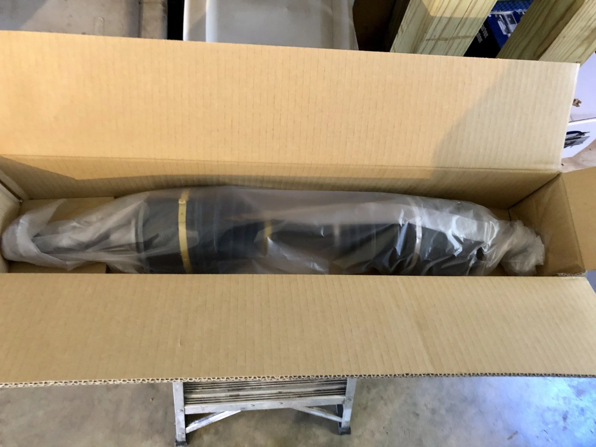

So I picked up my "value line" axle today. Upon initial inspection it did seem like a nicer unit than the new Cardone unit I installed previously.
Looking a little closer...
I'll be swapping this one for a new OE Toyota. I'm willing to redo it once, but the next one I put in is staying. So I'm not taking any chances.

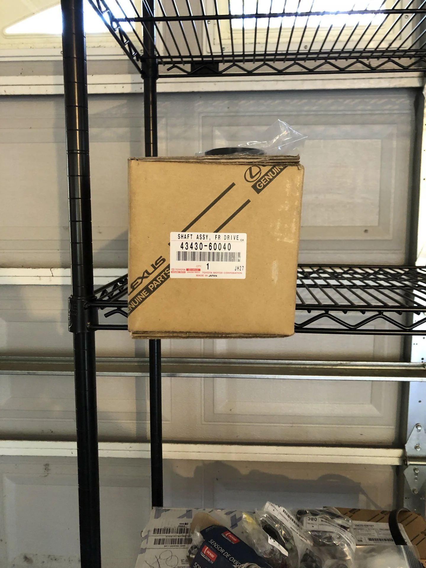

You made the right choice. I've been there where I've had to do the labour xxx amount of times because 1- rebuilt Detroit axle spit grease on installation then blew the boot 3k miles later 2- Cardone HD unit spit grease out of boot on install, and vibrated 3- warranty replacement Cardone roared like a bad wheel bearing 4 - had enough and got $400 to buy a OEM Toyoda one
It fit so well to the new splines to the new hub part. The cardones never fit on without further filing.
