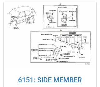

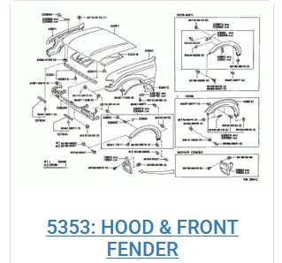

If you want to do the legwork yourself, you can use PartSouq or another Toyota EPC database, with your VIN.
The front fender is on panel 5353: Hood and Front Fender.
The rear is on panel 6151: Side Member.
