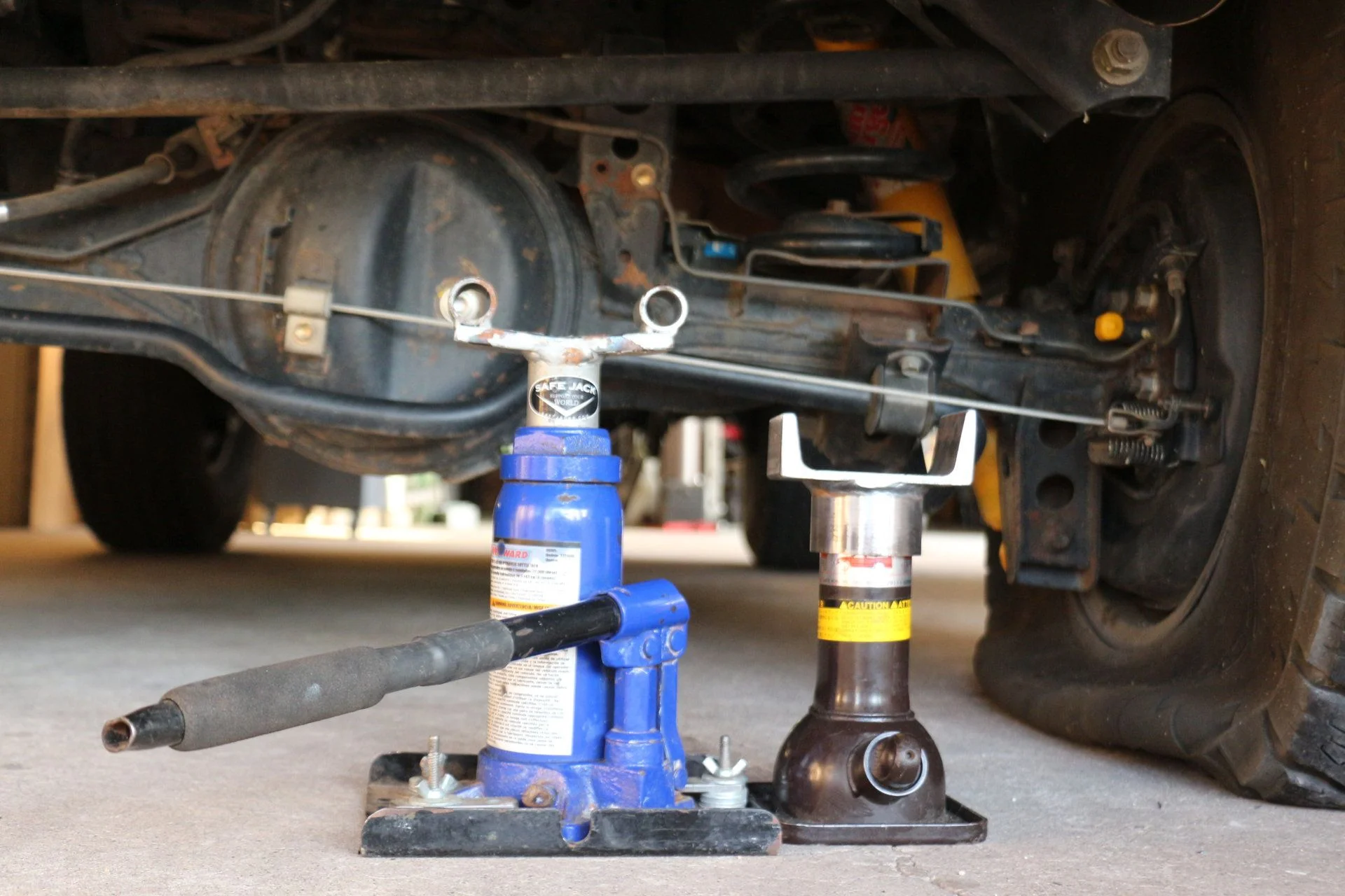

Do some research on safejacks because it will not fit under your axle with a flat without issue.
80 series and early may have a higher capacity due to the larger post than 100 series and newer factory jacks.
img_9530-1-jpg.1489564
I do notice you have a couple of jack stands backing it up!
Good eye and Im sure you know but for those that dont - Any time you lift any vehicle with any jack you should have a backup, this is basic auto safety for any newbie.
Additional this way more important with any hydraulic jack is use. Toyota factory jack is 100% manual and works in any position making it one of the most versatile and reliable jack available anywhere.

Could you use the factory jack on the rear axle with no adapter? The main issue I see is with the factory jack lifting the front in a safe spot. With the adapter show in photo on the Toyota, will it lift a lifted truck with 32-33" tires at the front frame rail?

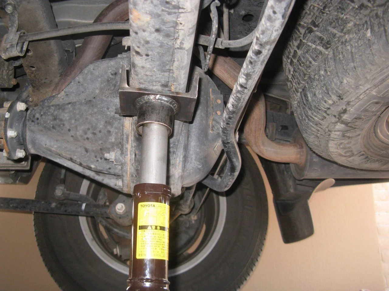

Going over how to change a tire with my girls the issue with the stock jack is Toyota asked you center the factory jack under the center of the axle. My wife quickly replied that is stupid, how much does this car cost. The Jack Adapter was born.
The Jack Adapter fits the rear axle tight making it incredibly stable. Pictured below is where we recommend lifting the front axle. The picture show why many ask the reason the adapter seems to be loose. It was designed that way so the adapter could tilt keeping the jack itself 100% plum in the safest position.
Using the locations below you can change any size tire you can fit on your 100/LX series.
If you have AHC placing it in high position will reduce the cranks needed when lifting the front.
Recommend rear axle placement
img_5532-jpg.1285934
Recommended front axle placement.
img_5726-1-jpg.1487489
