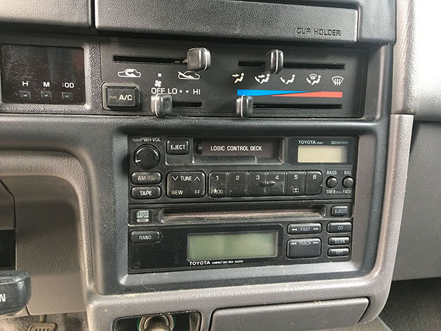

Sure, here's the radio in question: Backlight no longer works in the tuning display or CD track display:

Just the radio tuning display and CD track display are dead. They went out one at a time. All the buttons still illuminate correctly.

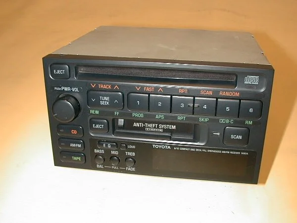

Ok so I went and looked through my stash of OEM radios (which I have no idea why I still have). Two are from the mid 2000's, and the display backlights are LEDs soldered onto a board, not useful. I have another one that I can't remember what car it came out of, but I think it was a mid 90's Corolla. The bulbs are tiny incandescent also soldered on. Here's a photo.
There are 4 of these bulbs. I can unsolder and send them to you but I have no idea if they are the same as yours.

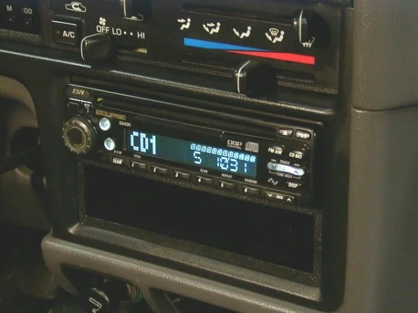

Found the photos:
Stock unit:
After:
[photo]

That's awesome, thanks for taking a look for me. Can I ask for a quick measurement? I know it must be a pain but maybe you can tell me how wide the bulb is? I see many sizes of grain of wheat bulbs from 2mm-8mm and it looks like I'll want to get a size that will let me reuse that green condom.

Tell you what... I have no use for this radio. PM me your address, I'll pop off the face plate boards and drop them in the mail. Then I can toss the rest.
