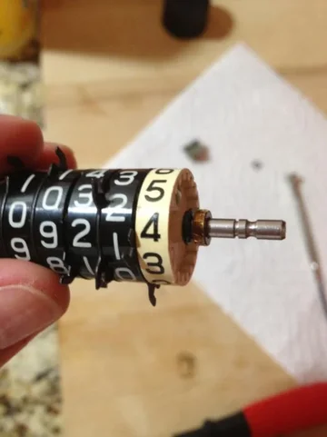

Alright I decided to tackle this today and am not stuck and my odometer seems I have an extra little metal piece that will NOT come off so I can't remove any of the other parts to clean. It's the brass looking piece in the pic. How the heck do I get this thing off!!!!

I've never had one apart, but from the pic it looks to be pressed on. Put the whole thing in the freezer for a while, then hit the brass w/ a soldering iron right after pulling it out???? Just a stab in the dark here, but that's probably how I'd go about it.

Not sure what you have tried but some light weight oil or pb blaster carefully applied (with a q-tip) and a vice grip just snug enough to grab the bras piece?
Not sure if there are risks with the oil and the plastic, but I'd give that a try if it were mine, only if the big assed hammer failed me first.
