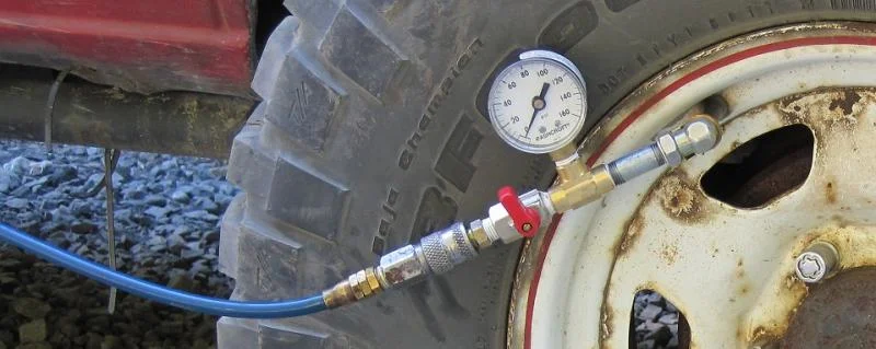

A hand throttle is very handy when using any form of engine-driven OBA. Remember that your output doubles at 1500 rpm versus at idle speeds!
Some day I will permanently wire this thing up, with an interior switch and all that, and a pressure gauge in the dash. Some day.
In the mean time, this system is fully functional. And since I open the hood to oil the compressor and hook up my coily air hose, I use a jumper wire between the pressure switch and the (+) positive terminal of my battery.
