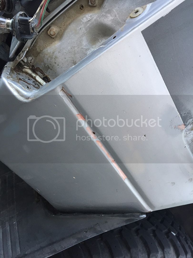

Also found a lot of rust in my passenger door (noticed it while bleeding the clutch) so I spent this afternoon making space in the garage then pushed the truck inside and stripped/pulled the front door, going to the local panel beaters tomorrow to get cut out & welded.

One patch of rust - it's also rusted out badly along the bottom where water obviously pools, sort of behind the weatherstripping.
