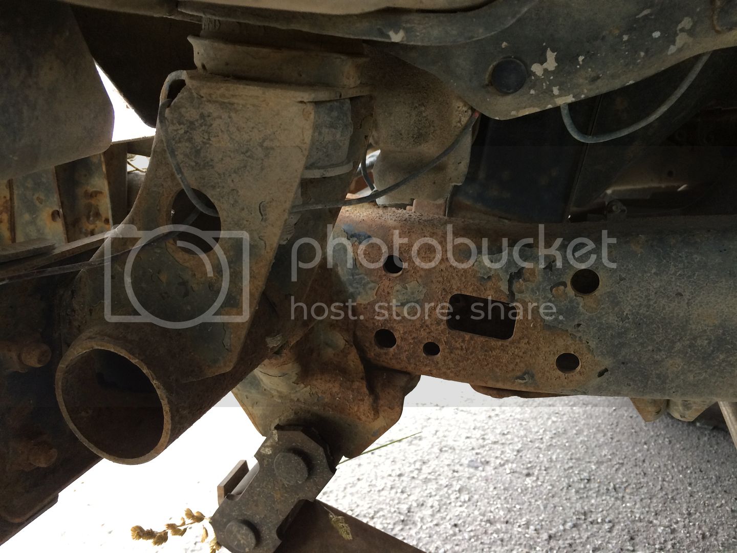

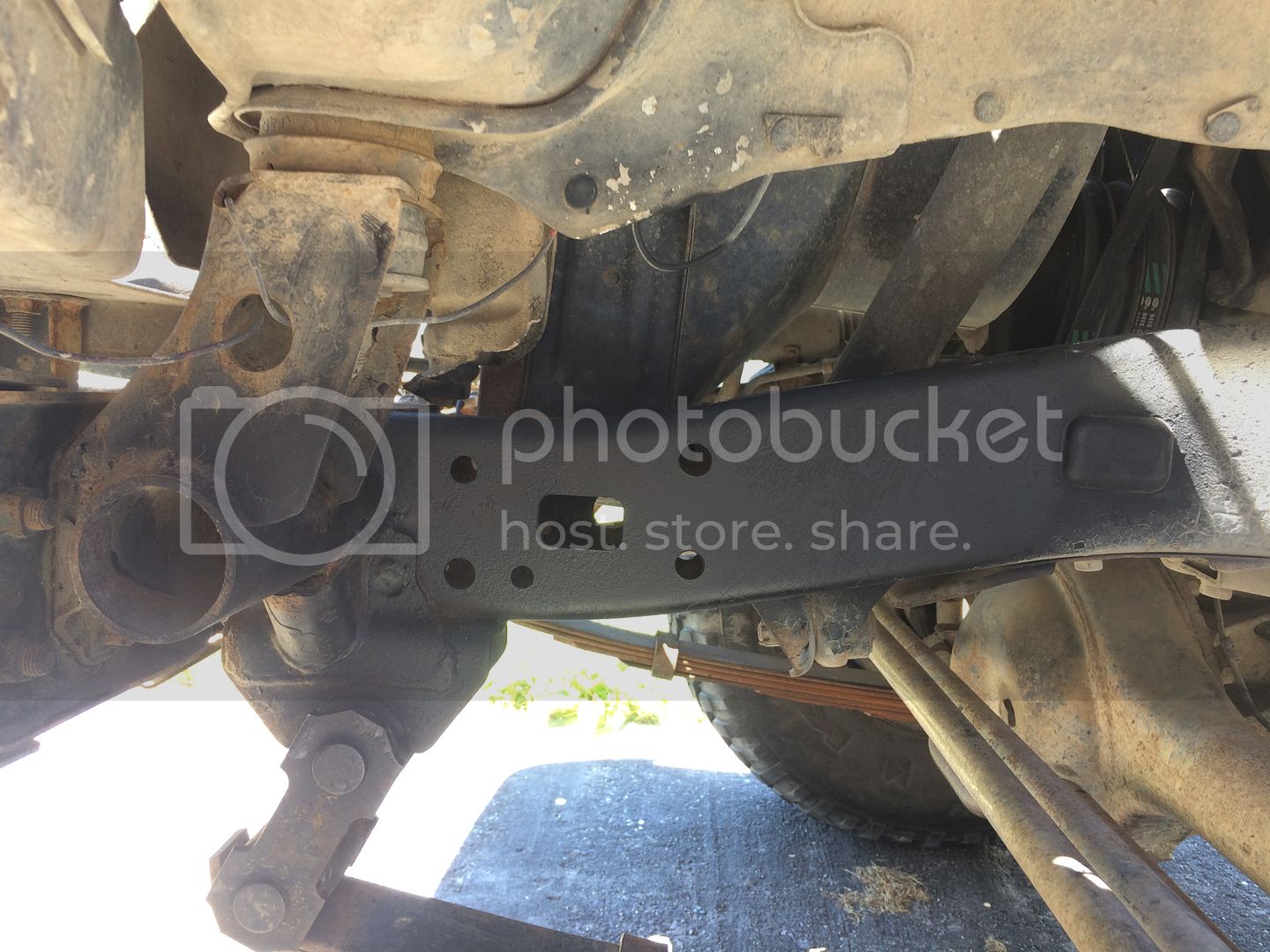

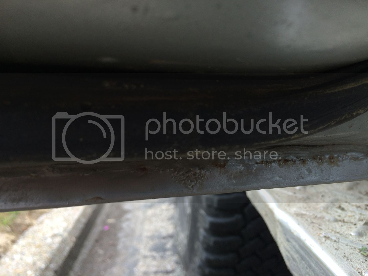

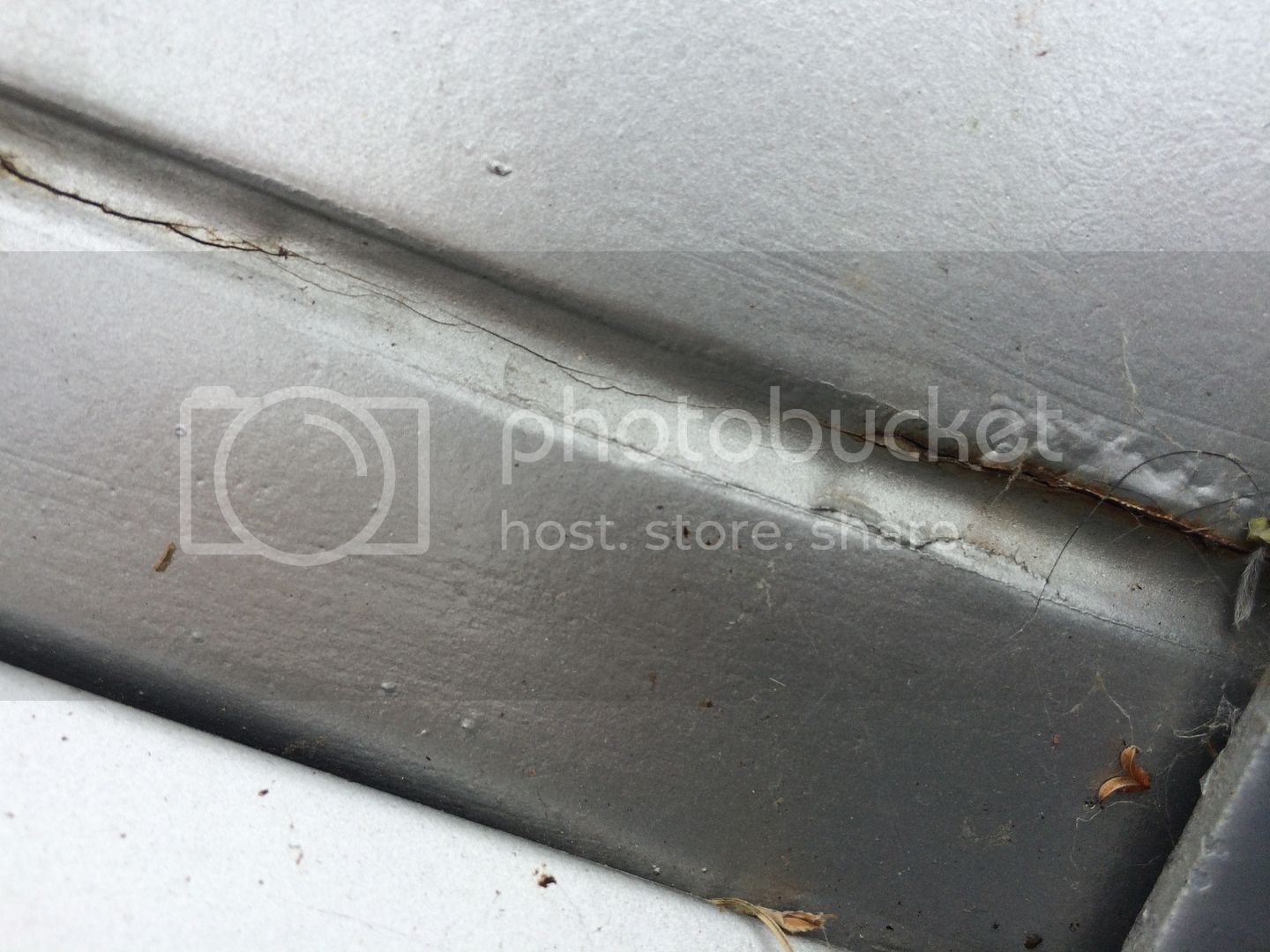

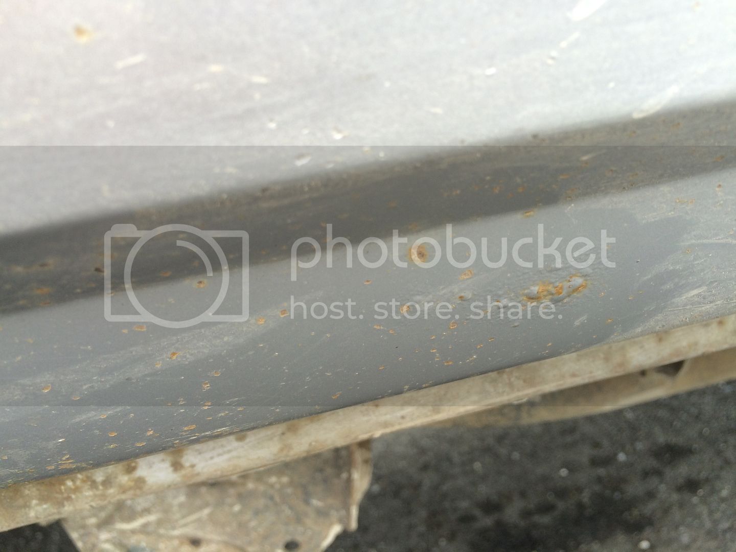

There was a little chassis rust I wanted to clean up before it became a problem (I live on the very wet West Coast) so I hit it with a wire brush, rust converter and then some black zinc rattle can

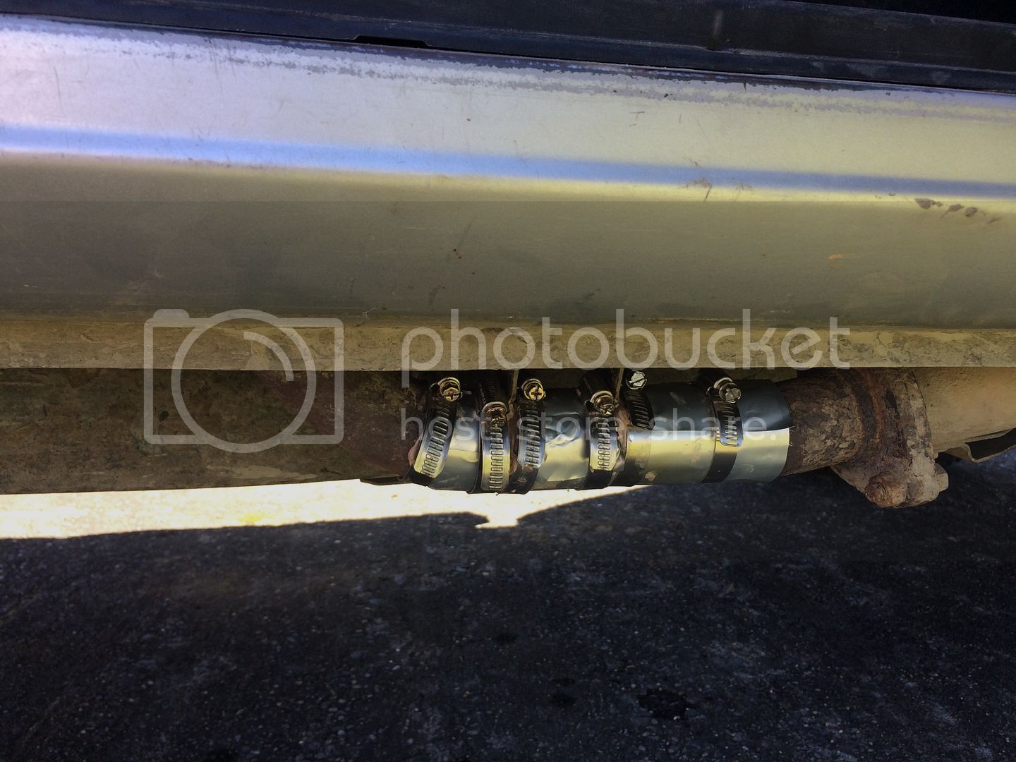

The exhaust was rusted out and blew through in the middle of my Christmas road trip, just under the drivers door on the welds for the brackets, so I made some temporary repairs, but I'll have to get a whole new exhaust before it'll pass a WOF inspection - it's not due one until June so I'm in no rush - is it worth getting a larger dia performance exhaust for a 3B? Will there be an appreciable performance or economy gain?

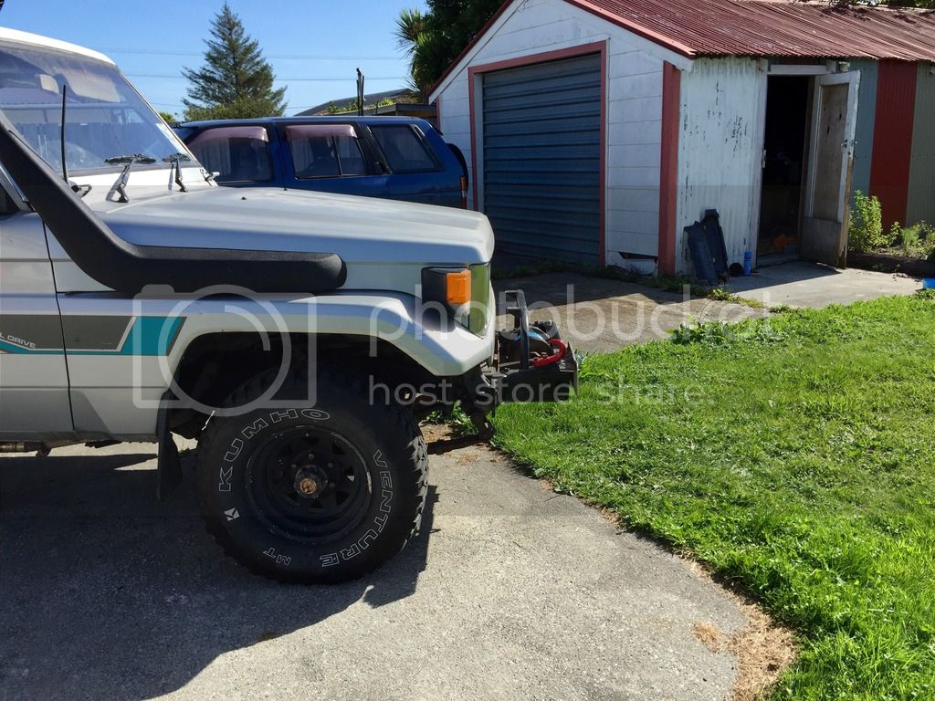

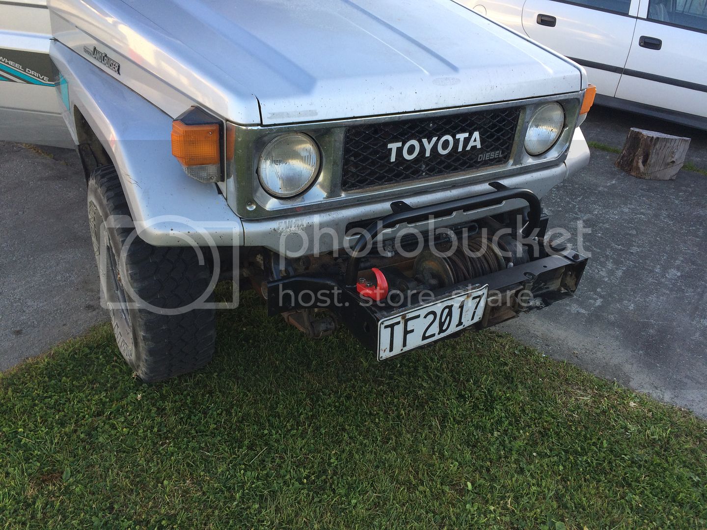

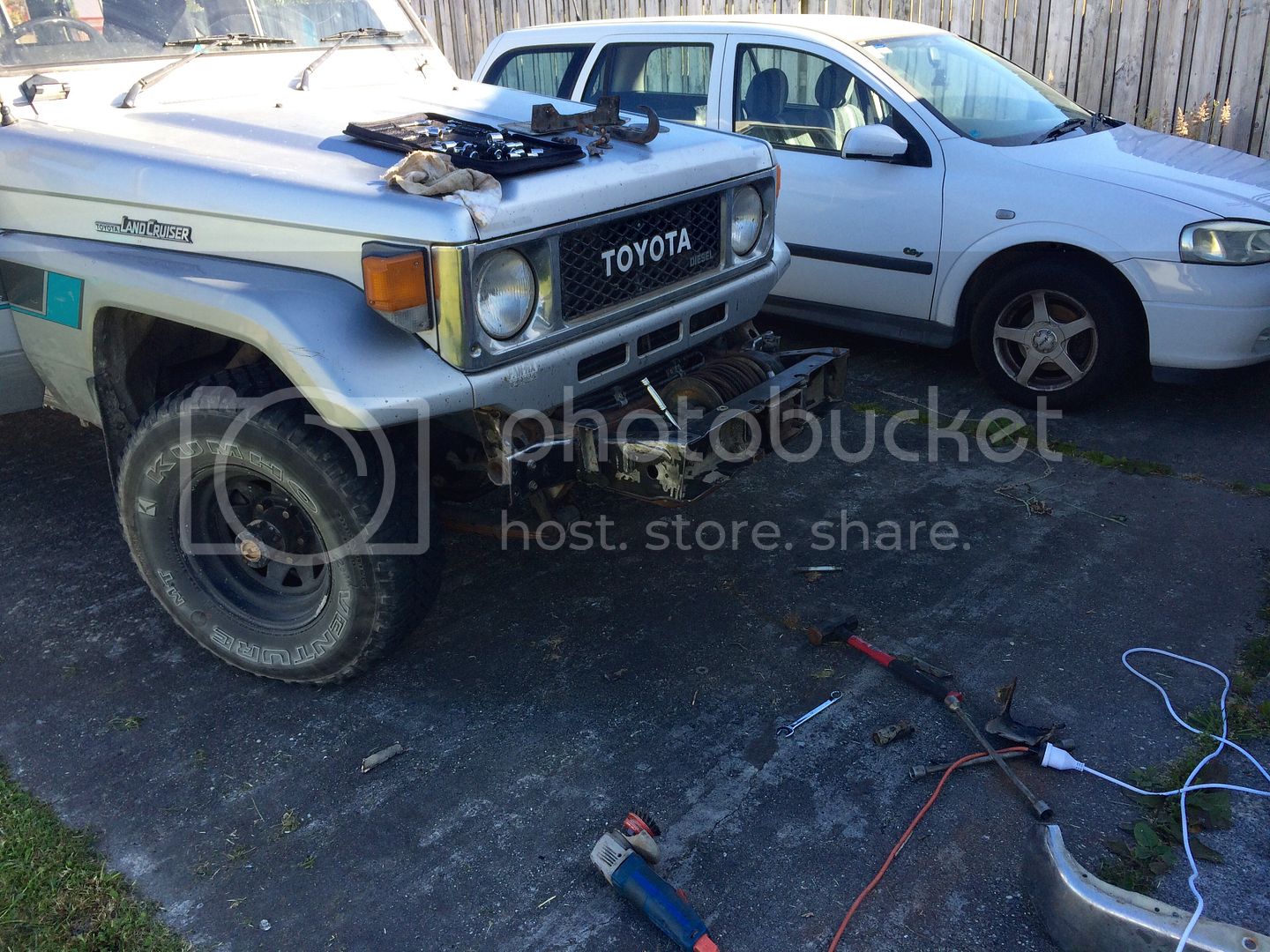

I didn't like the big chrome shelf bumper so I removed it and hit the winch housing with the angle grinder to clean it up a bit. Have some new parts being fabbed to reduce the profile of it a bit, and a new nylon rope and Hawse fairlead, hope to get that all fitted in the next week or 2.

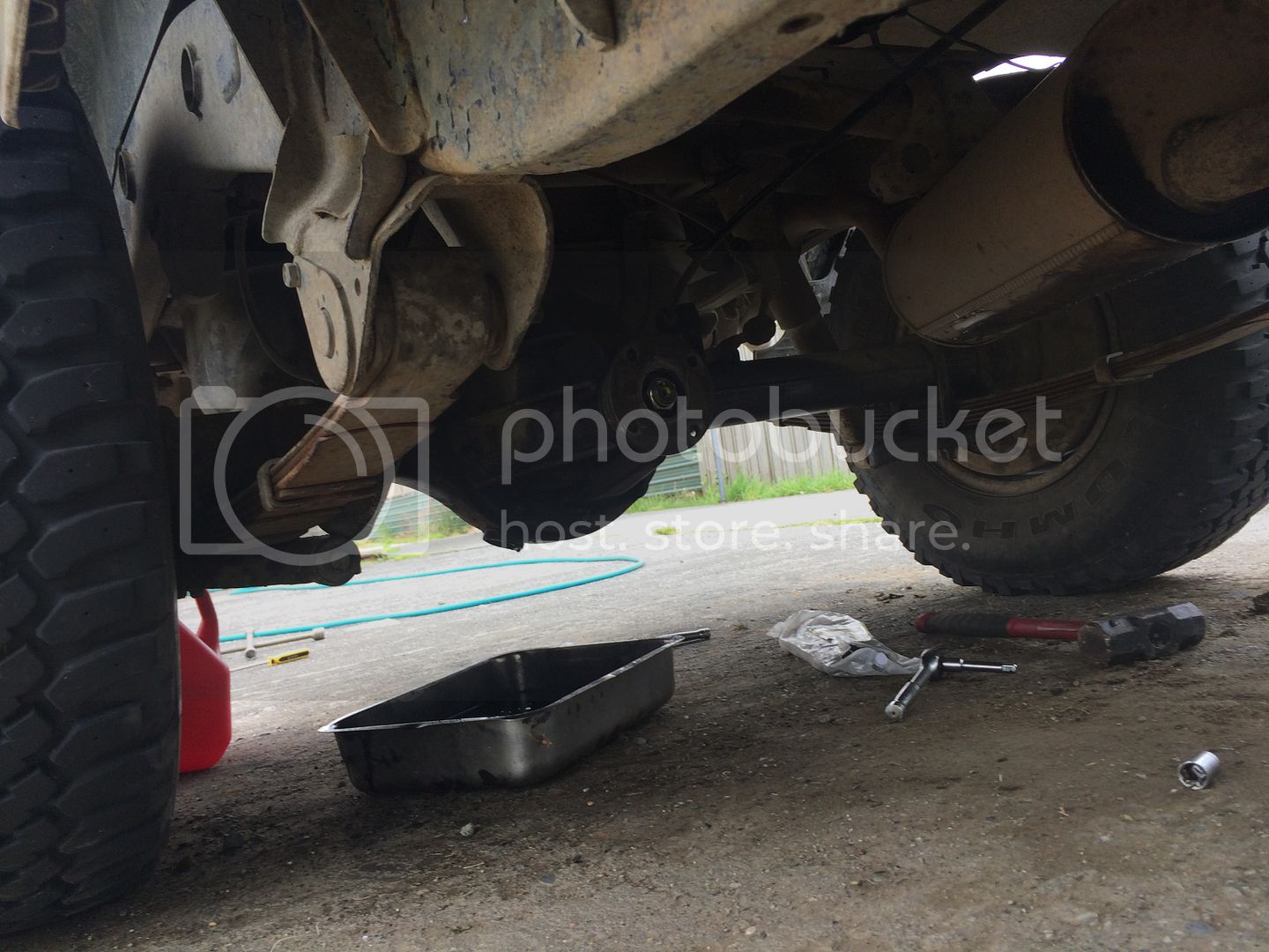

The rear diff was seeping oil from the pinion seal, so I changed that, but the seep seems to have continued, possibly due to a worn pinion flange?

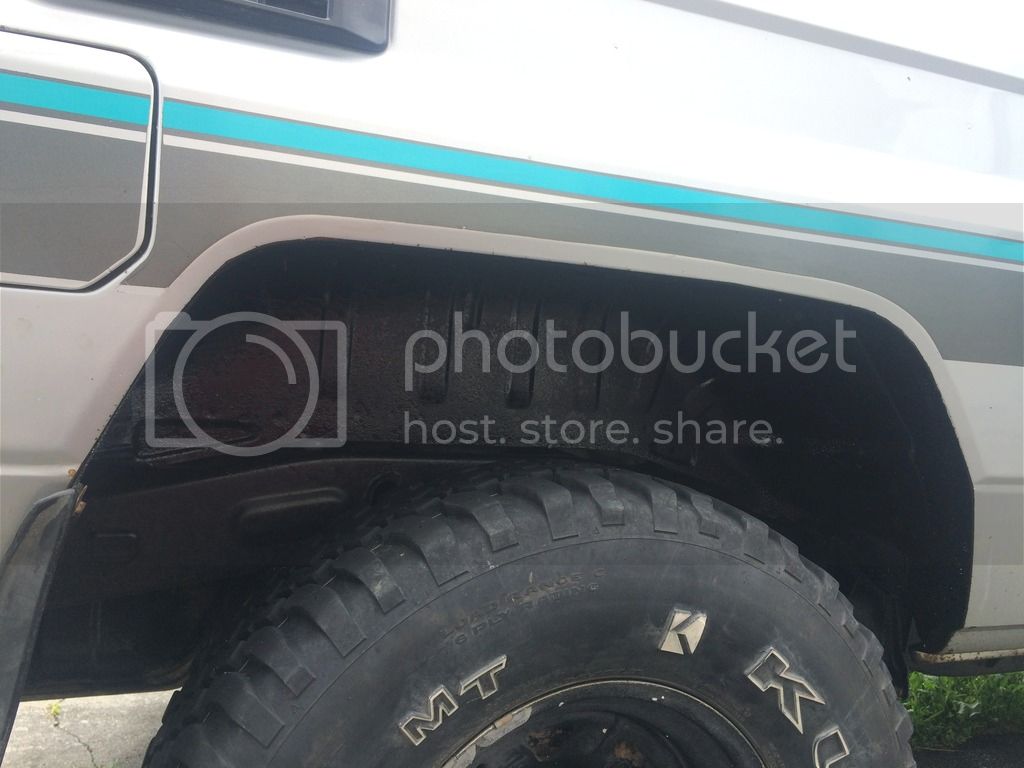

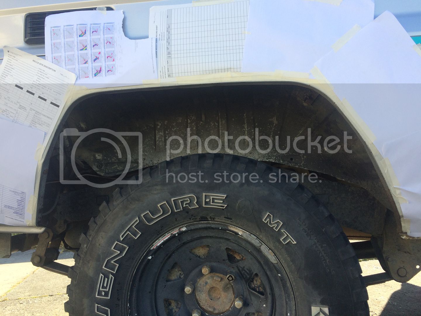

The inside of the rear wheel arches was bare of any coating, so I thoroughly cleaned, degreased, rust-converted them and then painted with rattlecan underbody liner. Also hit the entire chassis with fish oil at the same time.

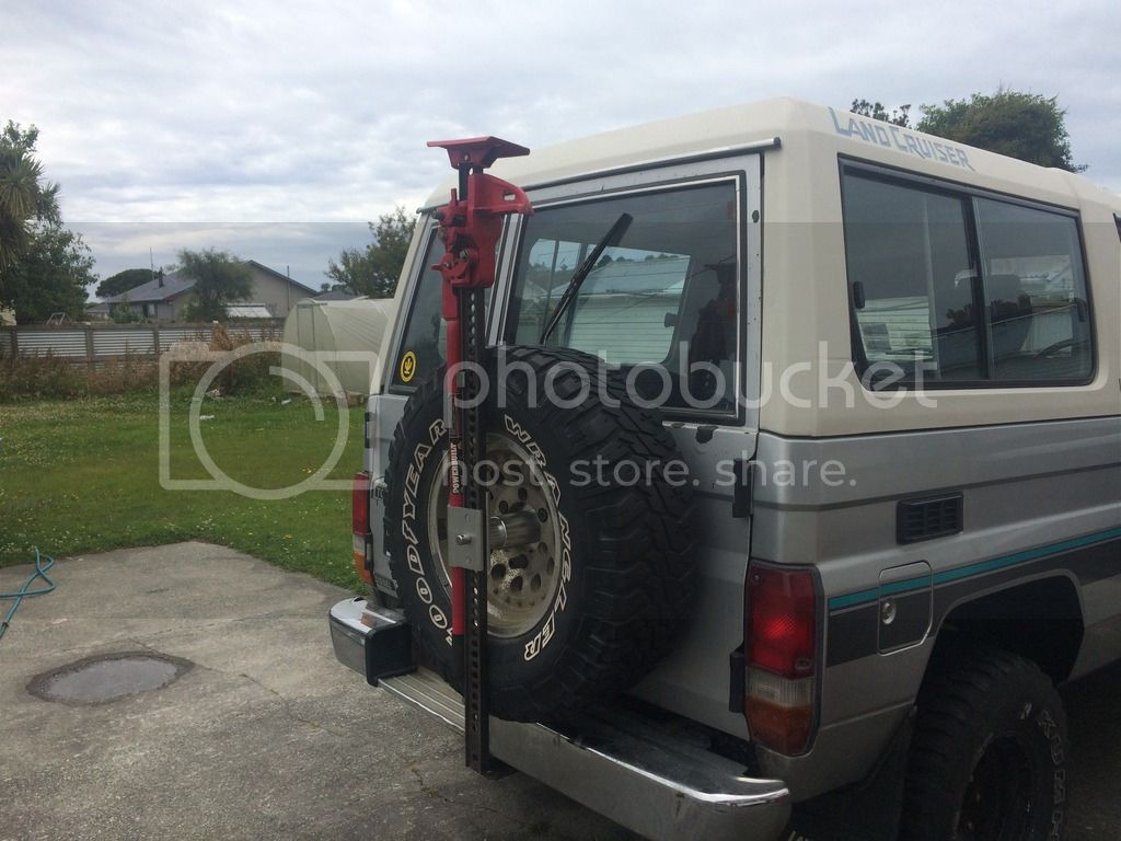

Also got a Hi Lift Jack mount for the spare wheel carrier

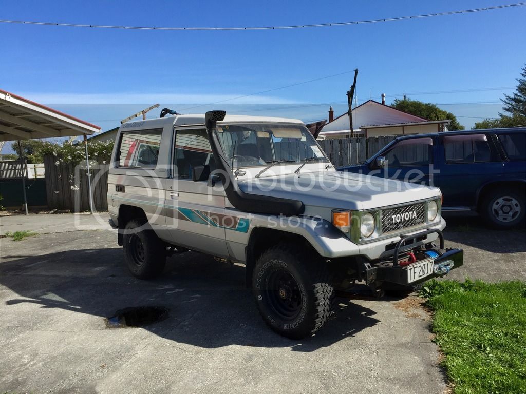

I have a Safari snorkel sitting in the corner ready to install, but the holes in the template don't seem to quite match up with the holes in the actual snorkel - is this normal? It seems concerning.

When I installed my Safari snorkel it took me a bit to figure out how to use the template and what it was guiding. I finally figured out that the template was to start at the back of the fender, then I had to carefully read through the instructions and understand what each hole was. The one that threw me off the most is the guide hole for you whole saw. I was thinking it was going to be the size of the hole but it was simply the center of where the hole should be. If you are trying to align the template to the snorkel while it is off you will only be able to align the back 3 support holes becuase of the area where you will drill the large hole just being a guide insted of a full size whole. Once you get into it it makes a lot more sense as to why it is that way... less room for error when you drill the large hole. Go slow and press a little hard when using the hole saw. It does not do well under high rpm.

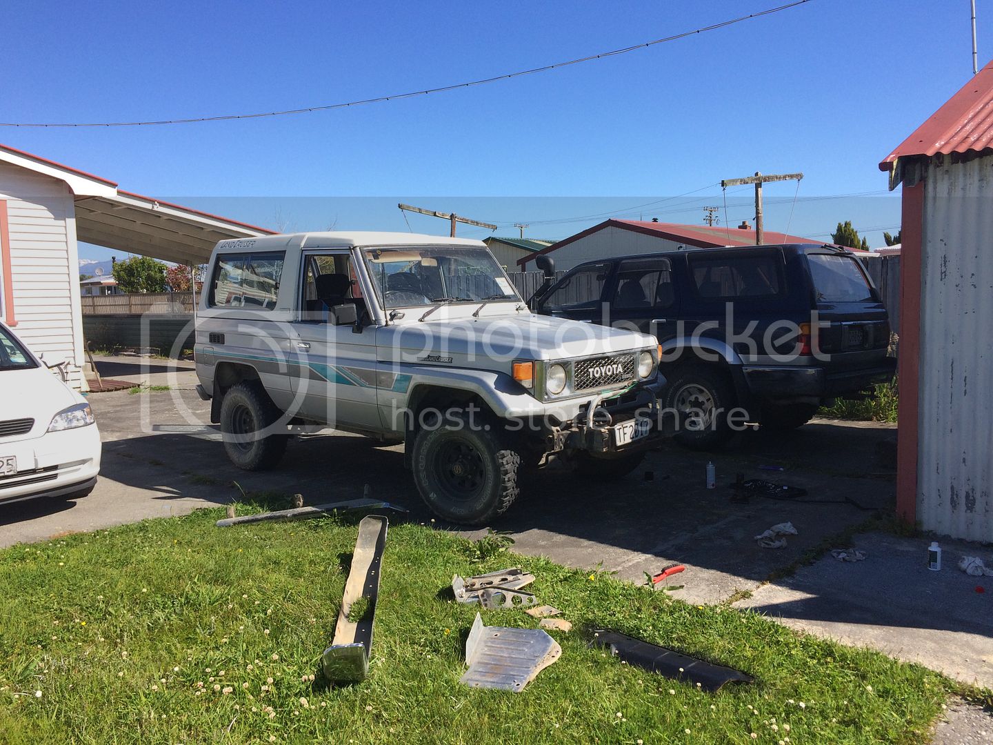

Picked up the truck today after having the bits fabbed up and installed for the winch housing, I figured I may as well get the snorkel installed at the same time since I was going to be out of town and not have time to do it. Looks good, s*** myself at the price. Gotta buy me an arc welder.... Spooled up the new dyneema winch rope. Still gotta get the bash plates for under the winch housing and radiator etc installed but the mods to the winch housing look to have improved the approach angle a fair bit.
With the window open you can probably hear the snorkel sucking air into the engine... kinda cool:) My intake faces forward too but I have not driven it in any big rain since I put it on. I know air flow is a little better facing forward but if it is rainy I would think I could catch more water than the little resevior can take in the air box.
Is the air flow rate really high enough to make a sound when air goes into the snorkel? :confused:

Perhaps it's because I am old and deaf but I've never been able to hear the snorkel over the diesel and road noise.
I have a new exhaust system and when I leave the house in the morning before I get moving any speed, yes I can hear it. Sounds very throaty. I have the older model of BFG AT's slightly aired down so they are pretty quite. Getting ready to change to a 305/65R17 for a wider stance and will be placing fiberglass fenders on it so not to look like a skate board.
It does sound meatier with the snorkel. Never really noticed a difference on the Surf with/without

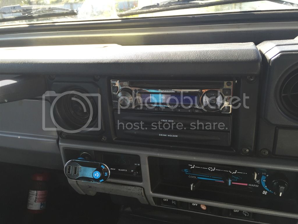

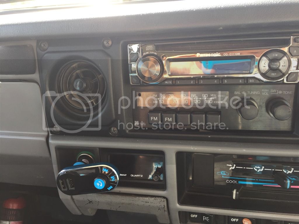

Sorted my dual stereo/no cupholder situation today. Still need new speakers & probably some bigger ones in the back rather than just the 2 4" jobs under the dash
Before
After

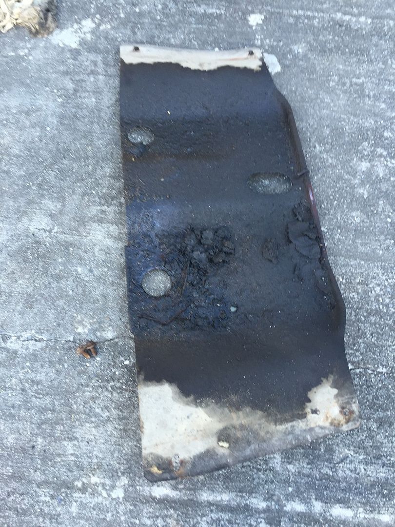

Got concerned about my gearbox leak today and pulled off the bashplate under it to have a look. Plate had about an inch of oily grime built up on it but at least the bolts came out with no drama. Still need to sort out the broken bolts where I took off the front 2 bash plates.
Anyways the gearbox and tfer case both appear to be full to overfull of oil, but the PTO box appears to be somewhat dry. Oil leak mostly appears to be from around the fill bung on the tfer case.

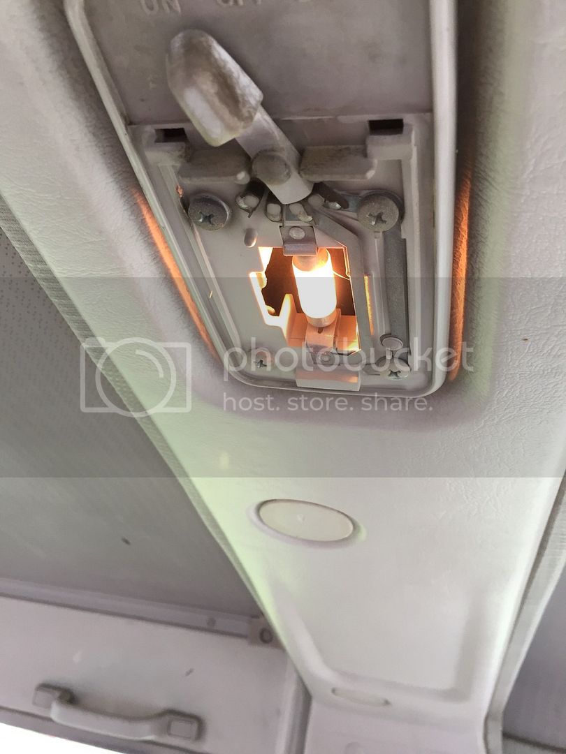

Got a Rob Smith LED dome light conversion. Much brighter than the old incandescent. Easy swap.
I'll have to forward this photo to Rob. He'll enjoy seeing them. :)
