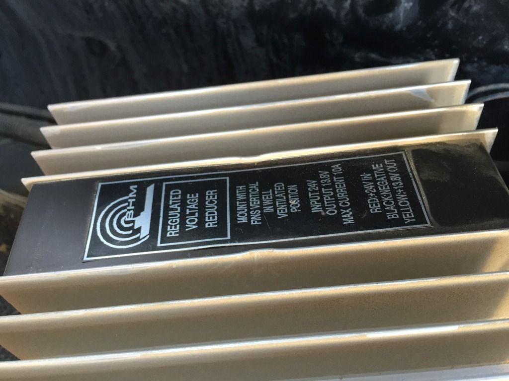

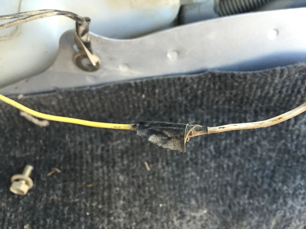

Turns out it's a voltage converter, hooked into the light circuits for the trailer plug, with very light gauge wire and extremely ghetto connections, with a hot wire from the battery routed in an exceptionally retarded route along the chassis. Better leave it in and not fry every trailer I hire. But might tidy up the wiring at some point.

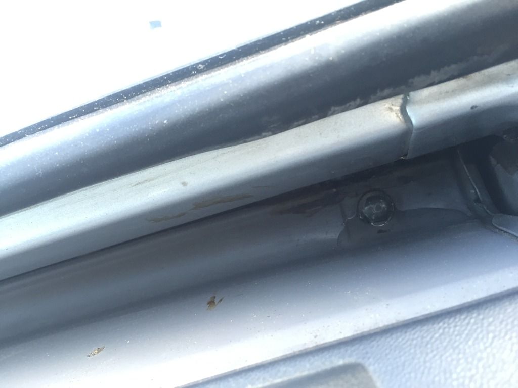

Also I have a leak around my windscreen.

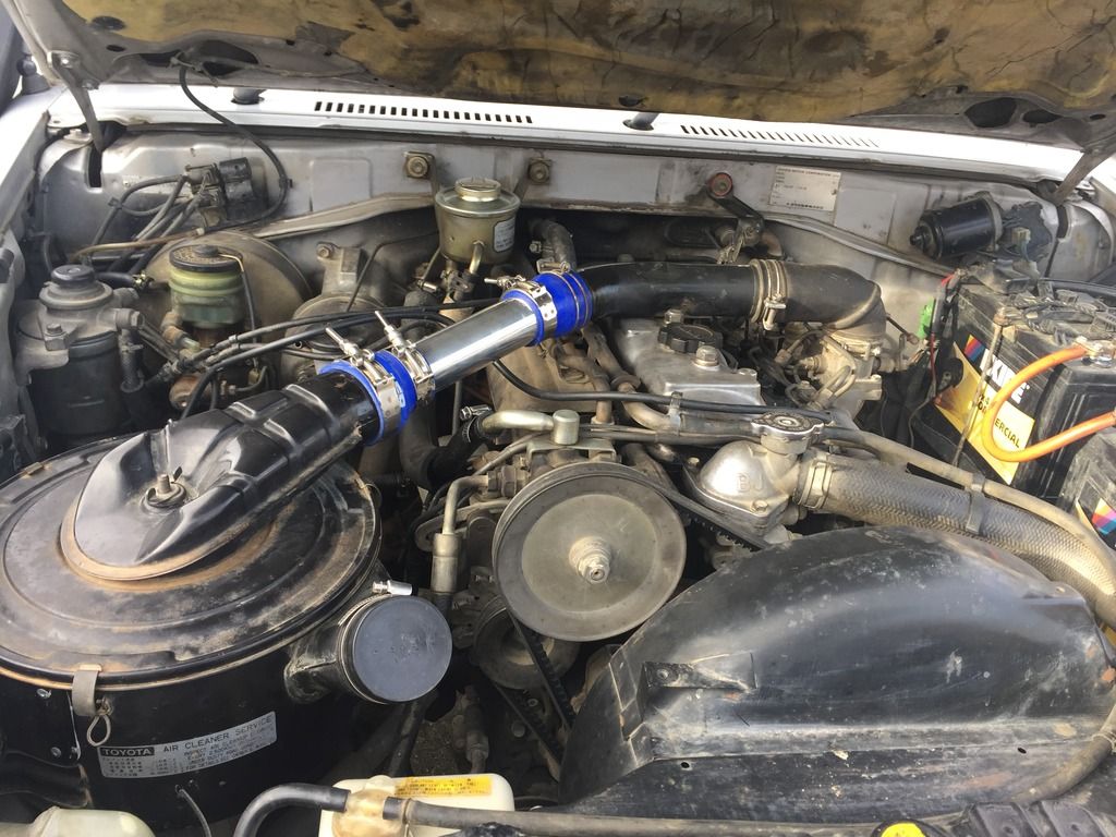

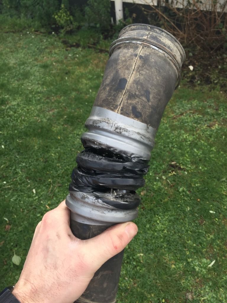

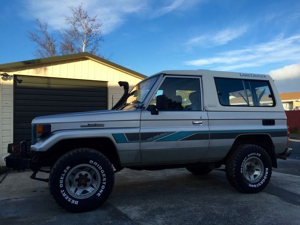

Had a problem with my intake hosing.
Probably not ideal for my engine to be sucking in huge amounts of unfiltered air, so I fixed it. Now it sounds epic sucking through the snorkel again. Hopefully it didn't ingest too much unfiltered s***. Not a great fix cos I'm a retard and bought 2" silicon and pipe off the Internet and probably would've been better off with 2 1/4 or something to match the existing crossover pipe. Whatever

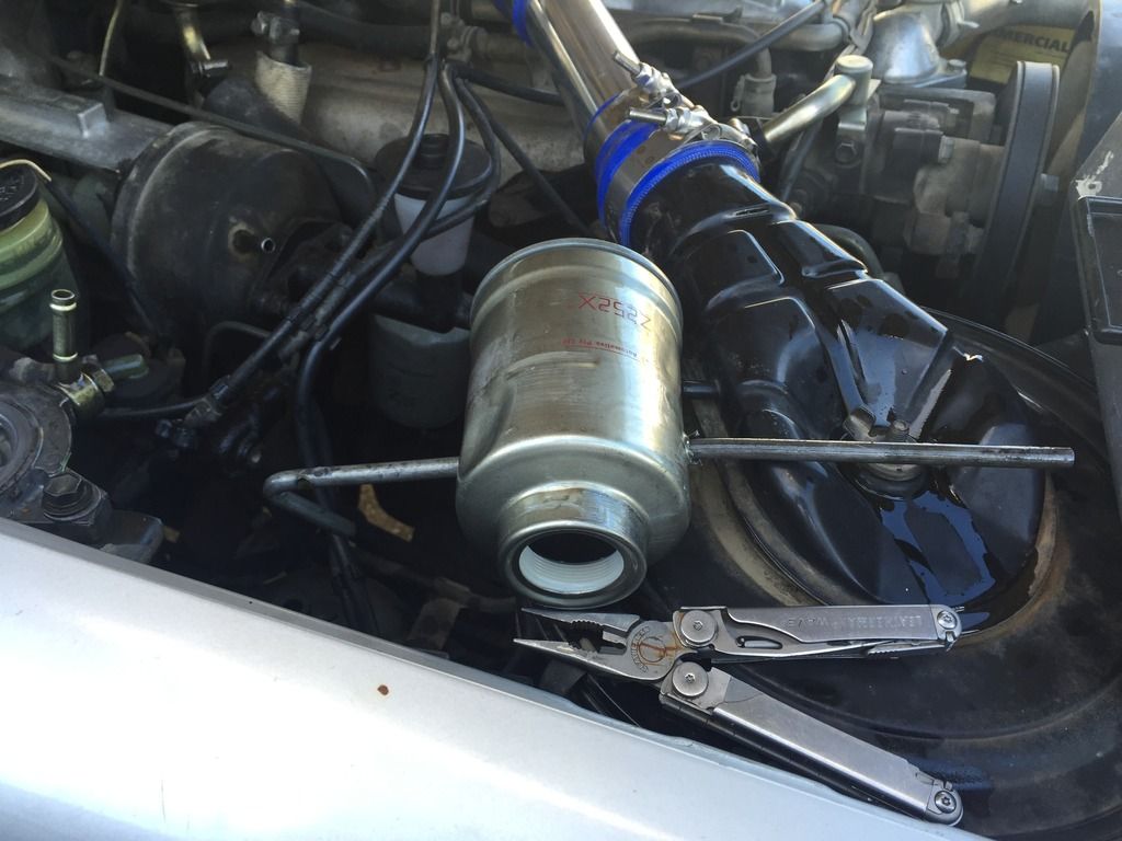

Also finally tackled my extremely stubborn fuel filter, I'd looked at it before and it refused to move so I just left it, figuring it'd be fine. Got it off and a new one on after some effort. Seems to run a little nicer now. Maybe.
Hi mate, using that bit of 2" tube will work on your intake and is better than the split piece of ducting you took out but going down to 2" tube puts a restriction on the airflow through that part of the intake, the cross-sectional area of that piece of 2" tube is 3.1 square inches, the rest of the intake looks around 3" diameter so the cross-sectional area of the rest of the intake tube will be 7.1 square inches, that's quite a big difference
Yup I realised that after it arrived in the post, I didn't measure up before buying, dumb-ass mistake.
Assumed the factory crossover pipe was 2" when it's more like 2 1/3 OD , but it's thicker than the 2" alloy I used, so not too dissimilar in ID. My new bit is still smaller - but it's better than sucking a s***load of dust into my engine, for the minute

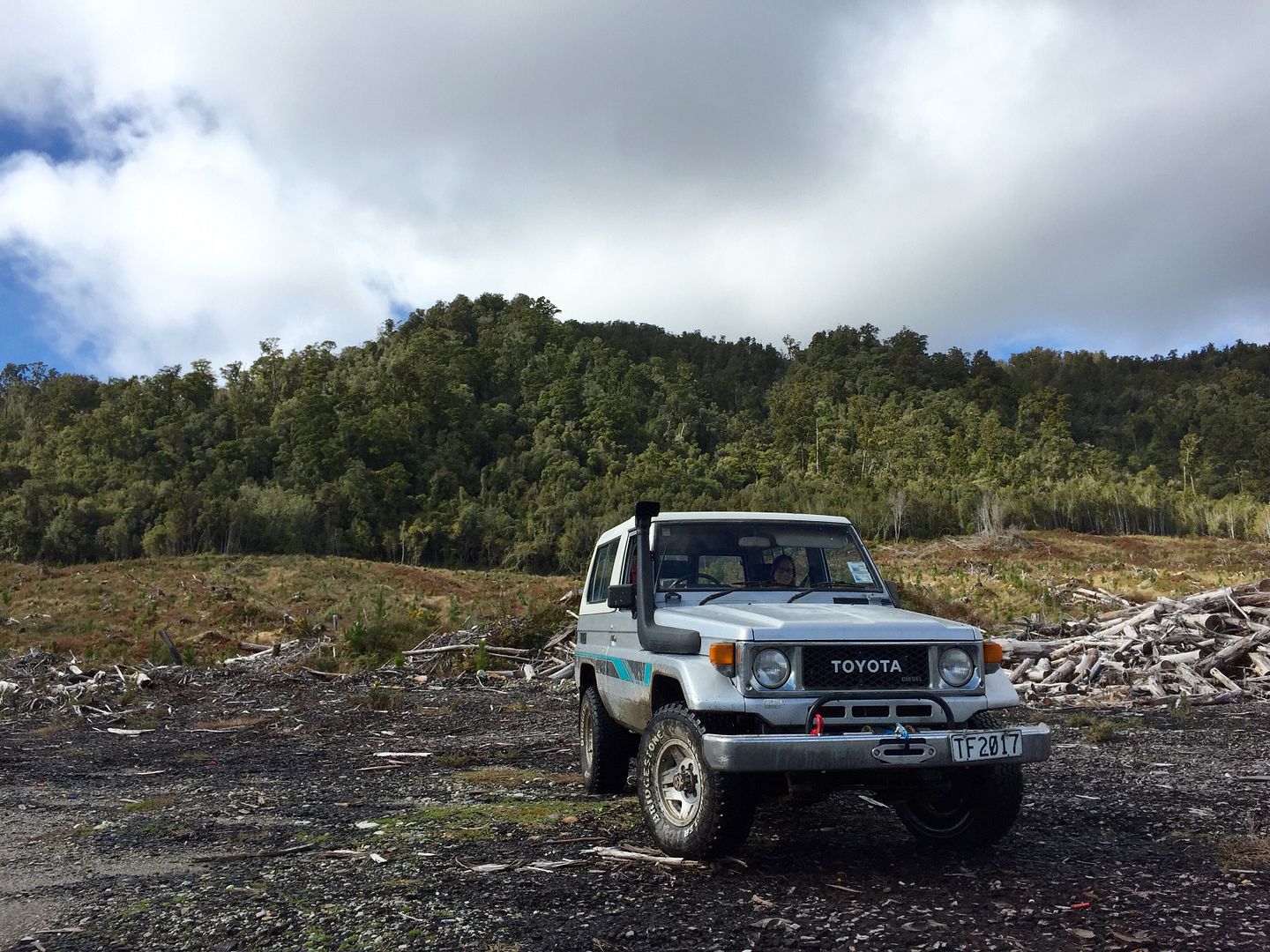

Got bored and ground bits off the original chrome bumper so I could fit it to my modified winch housing. I like it. Then went and explored some mystery tracks to nowhere. Bridgestone ATs work ok even on clay
Tracks any good mate?I'm allways looking for new ones......there's stuff all in chch
