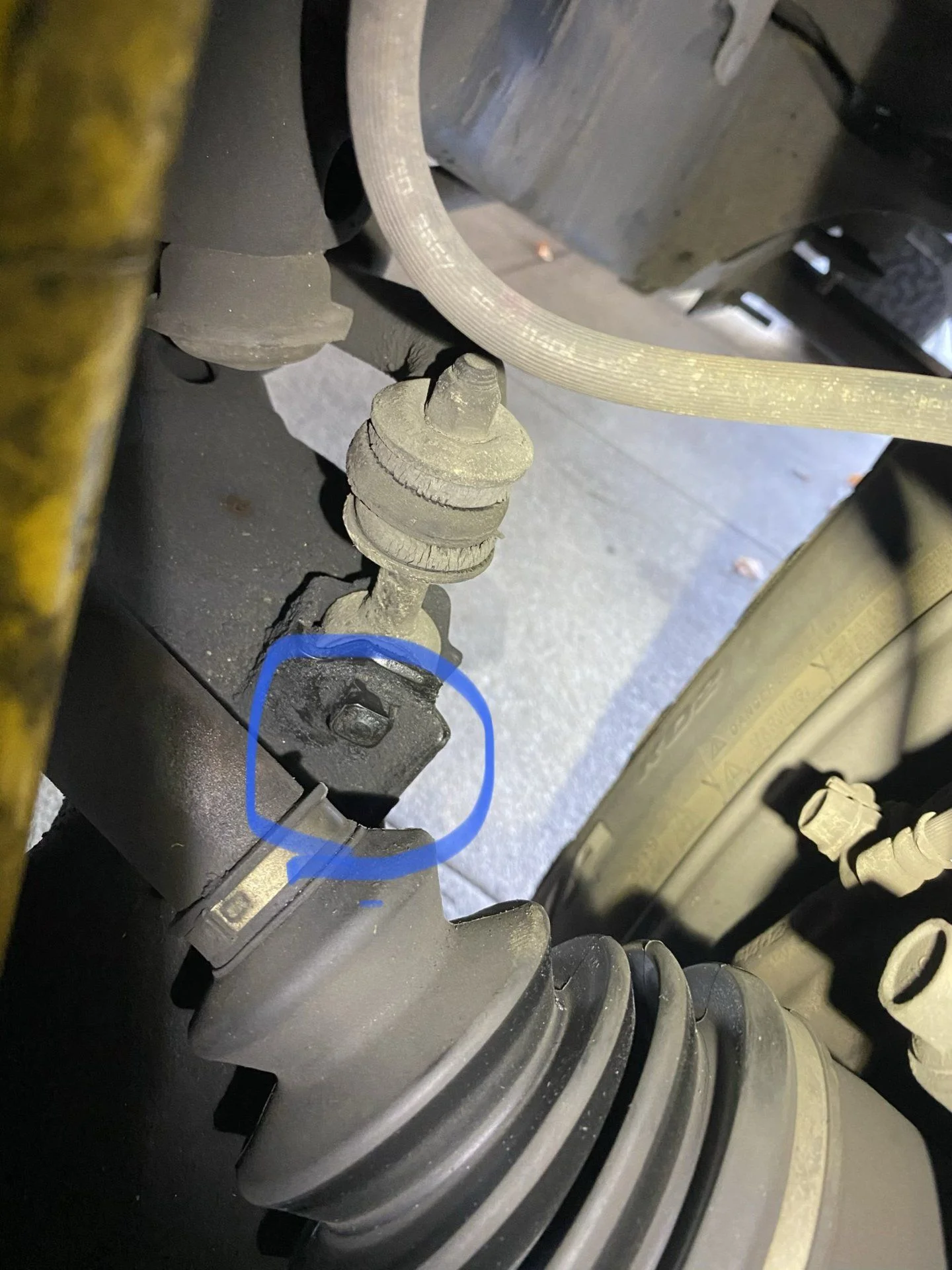

Yes i found out the hard way that it's welded on. My bolt was so rusted that there was nothing for the wrench/socket to grab onto so i sawzall'd it off. Only to figure out that the rest of the bolt stayed inside the welded on nut. so i had to saw the rest of the link off as well, and then drill out what was left of the bolt inside that nut. But now my threads are trashed and I'm stuck with what to do next.
It’s welded to the tab on the LCA.
Grind that nut off and tack weld on a new one?
  1. Best, R&R LCA. If new OEM, you get new OEM lower ball joint and front bushing. Replace #2 bushing while in there.
  2. Cruiser outfitters has aftermarket LCA (IIRC).
  3. Used LCA, off parts rig and restore it.
  4. Weld a nut on.
  5. Just add a nut, without weld. Just as long as no play in hole. Over torque a bit, once vehicle back on ground (in neutral stance) weight on tires.
  6. Trail rig only, wanting extra drop. Remove stabilizer bars. Do not drive on HWY!
It depends on budget and level of restore. Some want it factory correct restore, others just get it down the road as cheap as possible.
