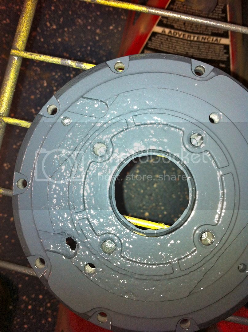

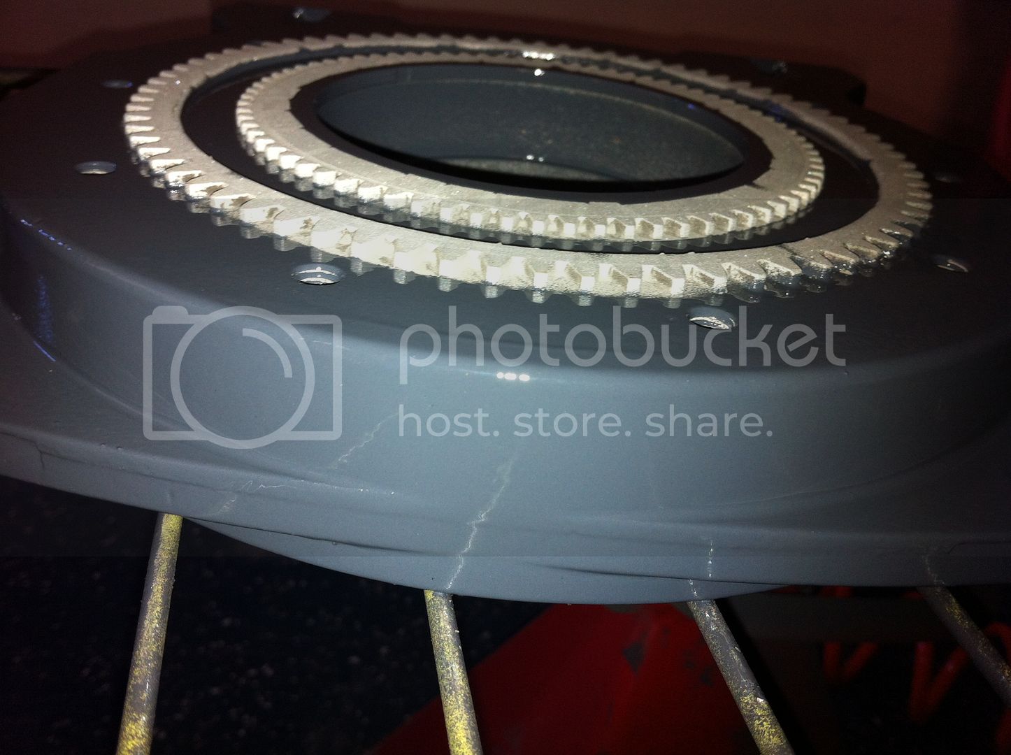

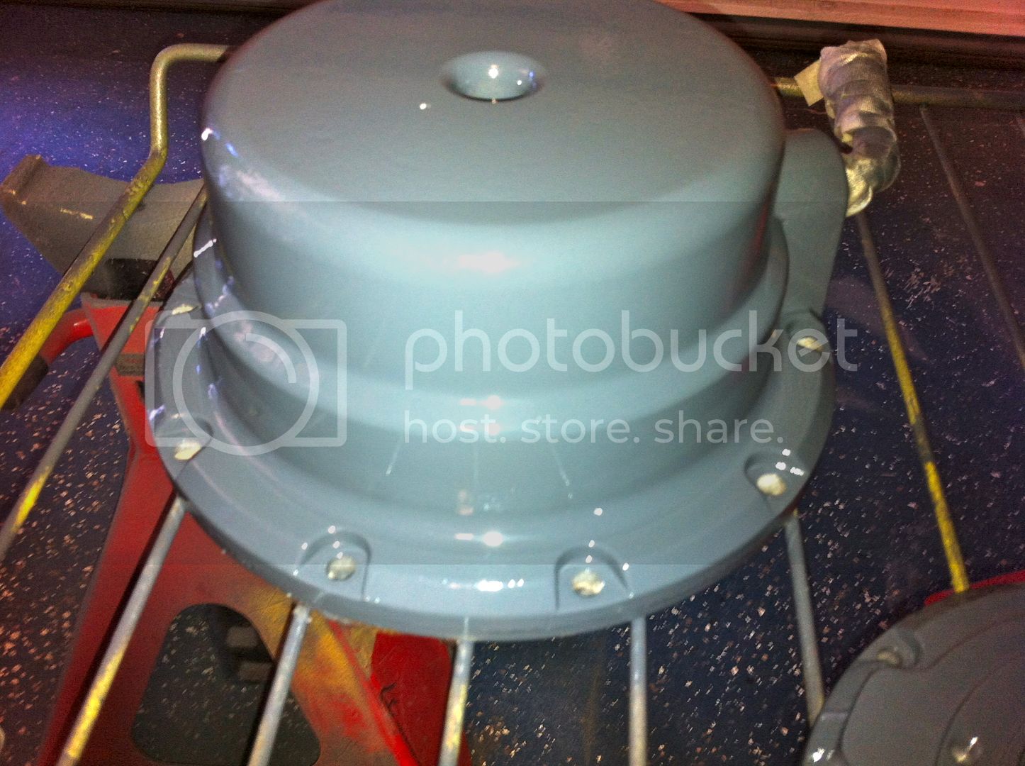

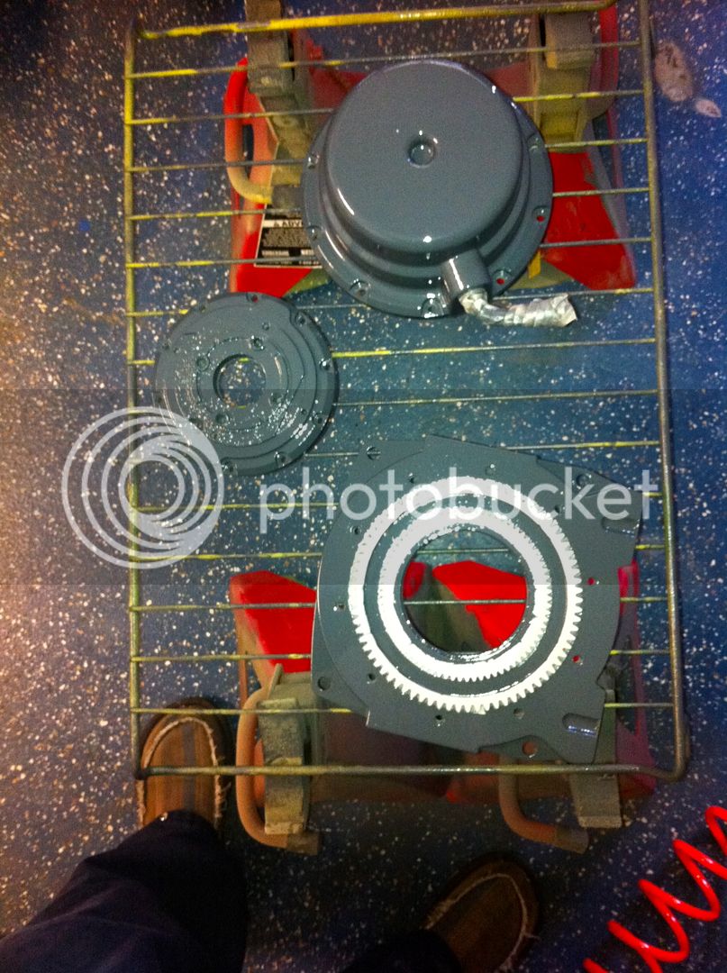

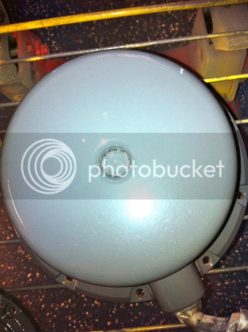

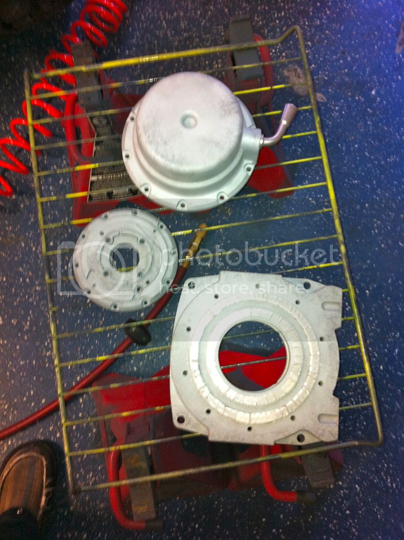

Here is what came out. The one piece is pretty abused from rust/oxidation. I had to do the spool also, don't think it will last long having cable wrapped around it but you can be the test subject for when I rebuild mine.
Not a perfect job, a "quickie" to get them covered in something better than Rustoleum.
Sorry for the crappy cell phone pics, before...
After...
Haven't used this color before so Brian gets to rock some gold...
I'm not optimistic for the spool. Powder coat isn't flexible and compression can cause it to crack/chip. Yet, it could survive, depending how well the first wrap goes around the spool.
I'll be using synthetic line on mine and I think it will work better with the powder coat, so Brian will give it a worst case test...

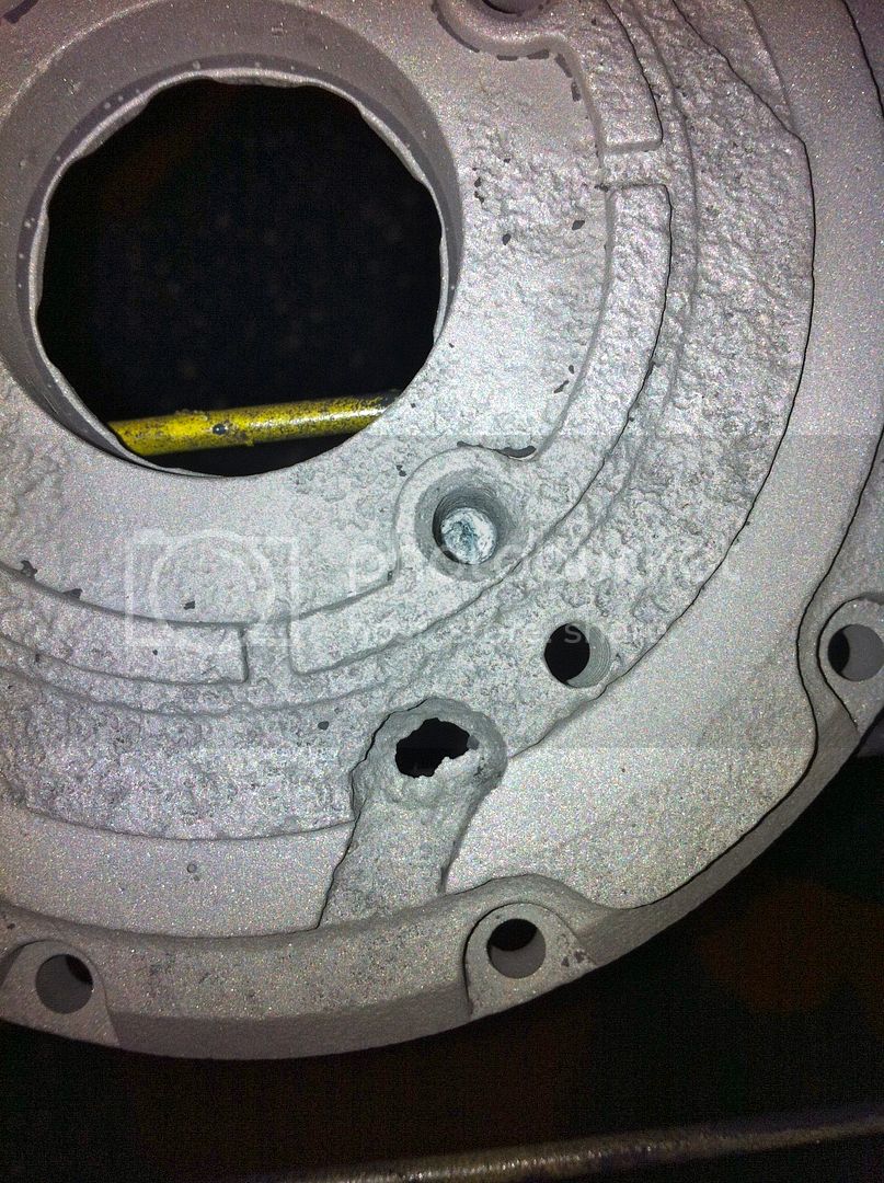

What worries me is the corroded hole on the motor flange, that I didn't really notice until I studied the pics.
From what I can tell, it looks like the flange is produced for different motor types/configurations as the motor housing I have would utilize the two outside bolt holes. I might have to seal that up in order to keep it a little more weather resistant.
Greg, you've rebuilt one of these before, do you recall what the 2 indentions are for running parallel on the flange are for and why one had corroded. It wouldn't be for moisture drainage would it?
It's been a while since I have done one of those and without having the pieces in front of me or a detailed diagram I wouldn't for sure know. I will see if I can look some stuff up tonight.

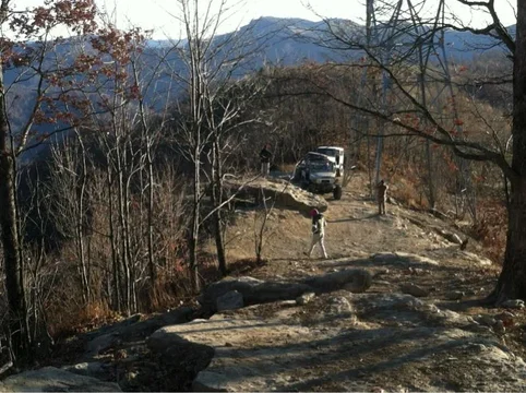

This hill doesn't look like much in the photo, but for perspective this is significantly steeper than Daniel. Brian and I, in Dozer, led the group down after careful consideration, decided to put the p.s. tires in the rutt. Pitched the 40 to the p.s. a good bit, but not too bad until there was a rock that lined up on the d.s. rear tire that pitched us WAAAAY to the p.s. - we damn near rolled! I cried out an expletive, gassed it, and she righted herself. Could have been pretty ugly, but turned out ok. we then spotted Jon and Del down the hill keeping the p.s. tires up on the ridge and both sides out of the rutts.
