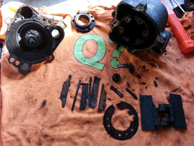

Smog pump
Good luck on that with CARB - you'll need all of that junk. When you yank it and tear it apart, make sure not to damage the "vanes" that are inside, its the only part that is pretty much NLA - you can get better sealed bearings to replace the OEM ones if they're fried.
Otherwise keep an eye on the "classifieds" (middle red button forum) and see if someone in a non-smog part of the world is selling or giving away their smog junk. Happens quite a bit, as folks desmog.

Congrats and driving around. I would suggest that since you don't have any PS right now, you may want to search for the volvo conversion - you get a better *non-leaky* pump for your time and effort. Biggest problem is fabricating a new bracket for the power steering pump to hang off of. There are a number of threads about how people have done it.

Ended up staying home this weekend and ripping in to the pumps.
Got them out in a few hrs with minor frustration.
Ordering a steering pump rebuild kit. Also picked at a saginaw pump and will review getting installed
Ordered a new smog air pump cuz mine is toasted.
