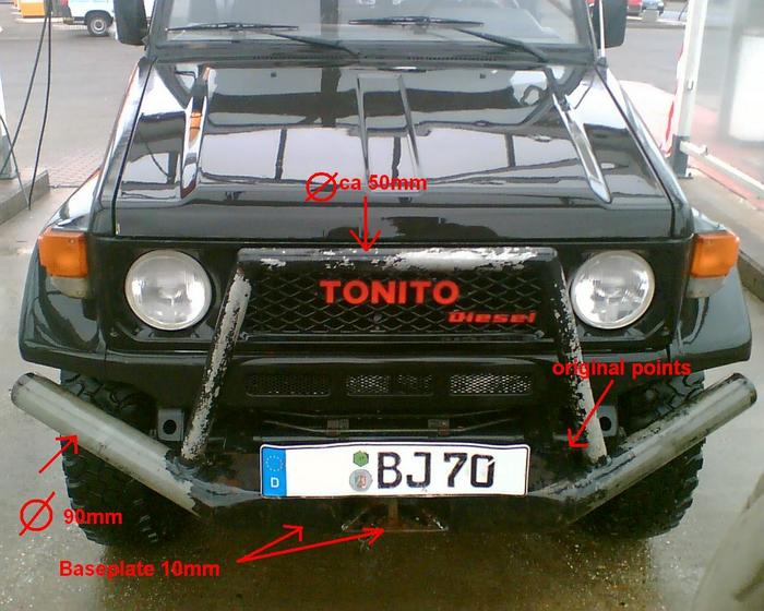

This is my homemade bumper. The base is made from a 10mm steel-plate which was used to stand an oven on. The bigger 90mm tubes are galvanized and from a scaffolding.
The smaller tubes have a diameter from around 50-65mm, but im not sure.
The bumper is fixed to the frame on 4 original holes.

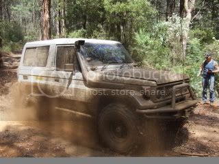

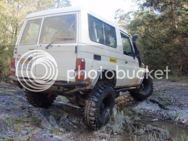

this is my custom built one.
very strong, no approach angle clearence problems...
