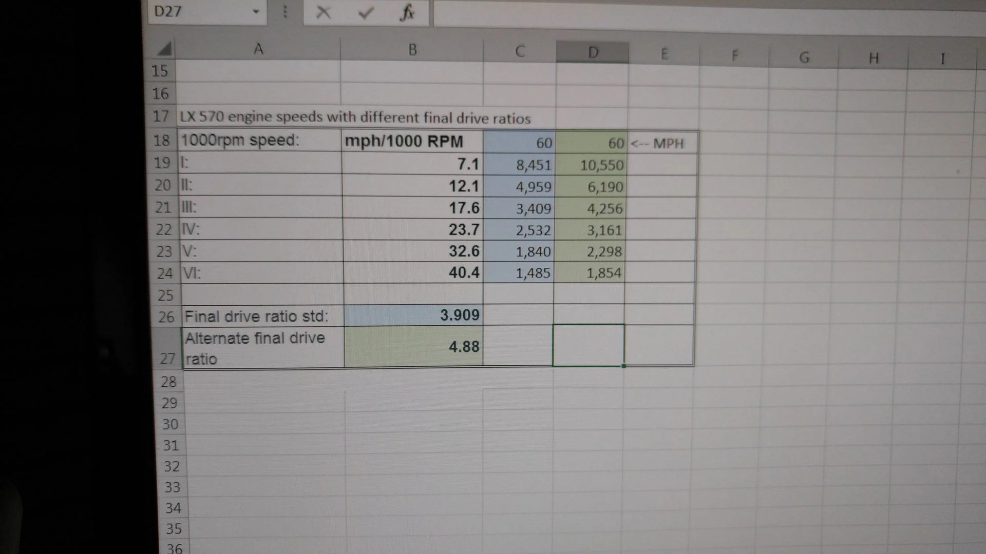

The 4.88s would have the engine turning 25% more RPM at the same speed and transmission gear. I'd be surprised if that didn't consume more fuel, but I don't have 4.88s, and haven't actually tested it.... :)
At 60 MPH the 4.88s in 6th gear (on a 6-speed) would have the engine at almost exactly the same RPM as 5th gear on the stock 3.91s.
